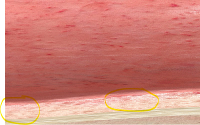

when I use the bump map channel from a Material I have some Weird artifacts in the texture.
I use Octane 2024.1.2 R4 and Cinema 4D 2024.
Regards,
Jochen

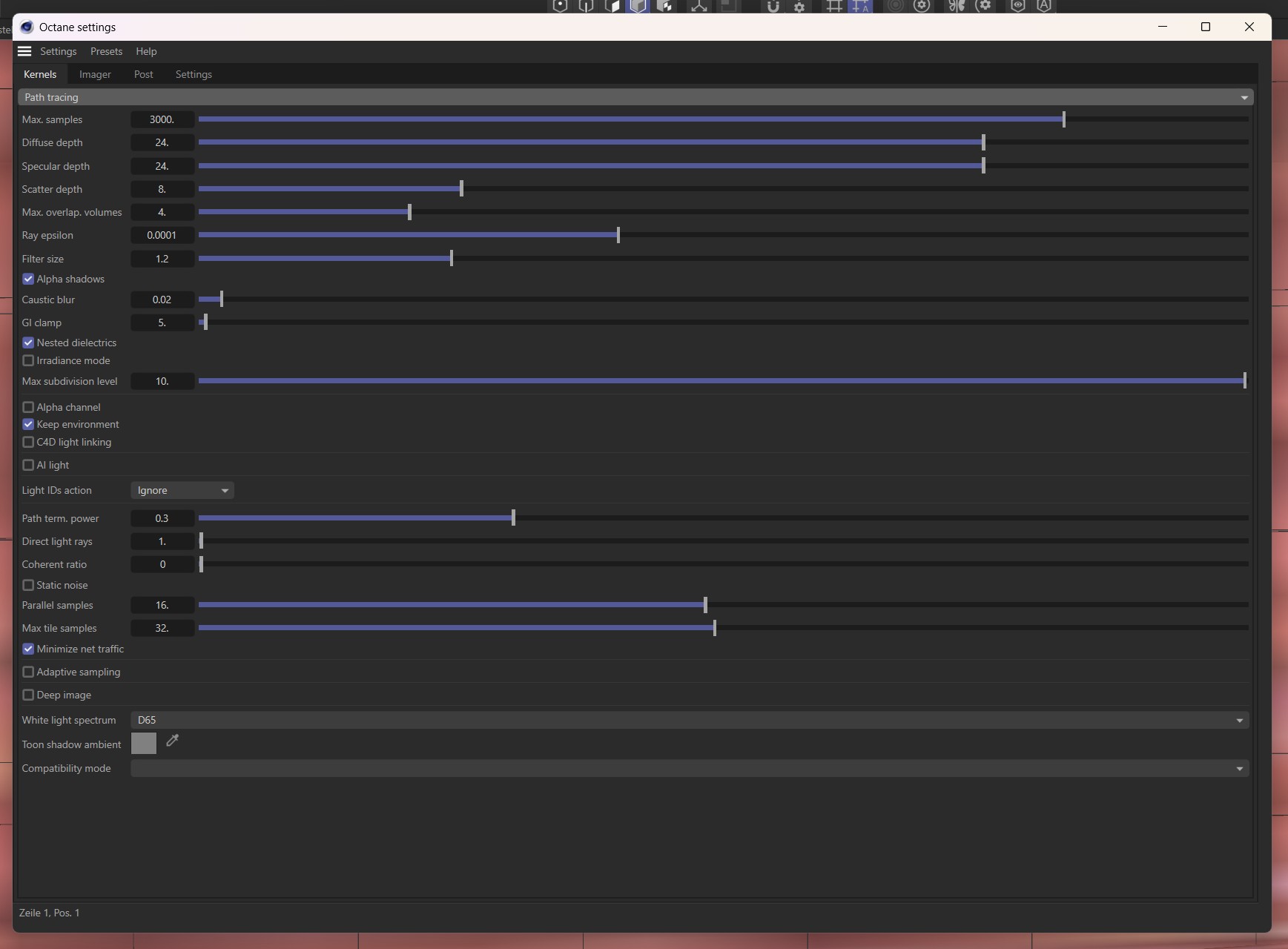

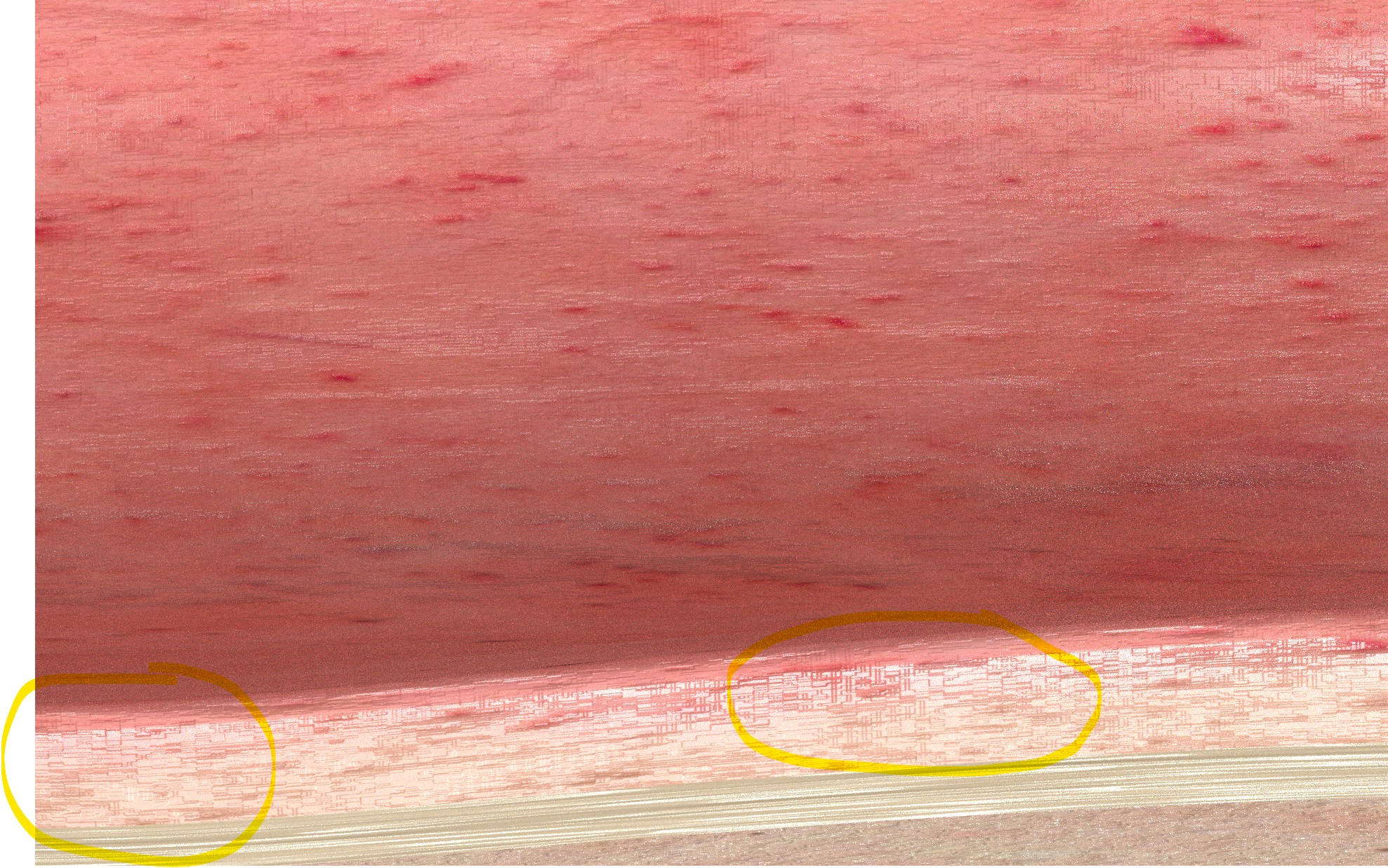

I see this artifacts also in the Ocane Live Viewer window.
Posts: 10575
probably you need to highly reduce the "Bump Height" value to match the geometry scale.
Please note that the "Bump Height" value works in meters.
