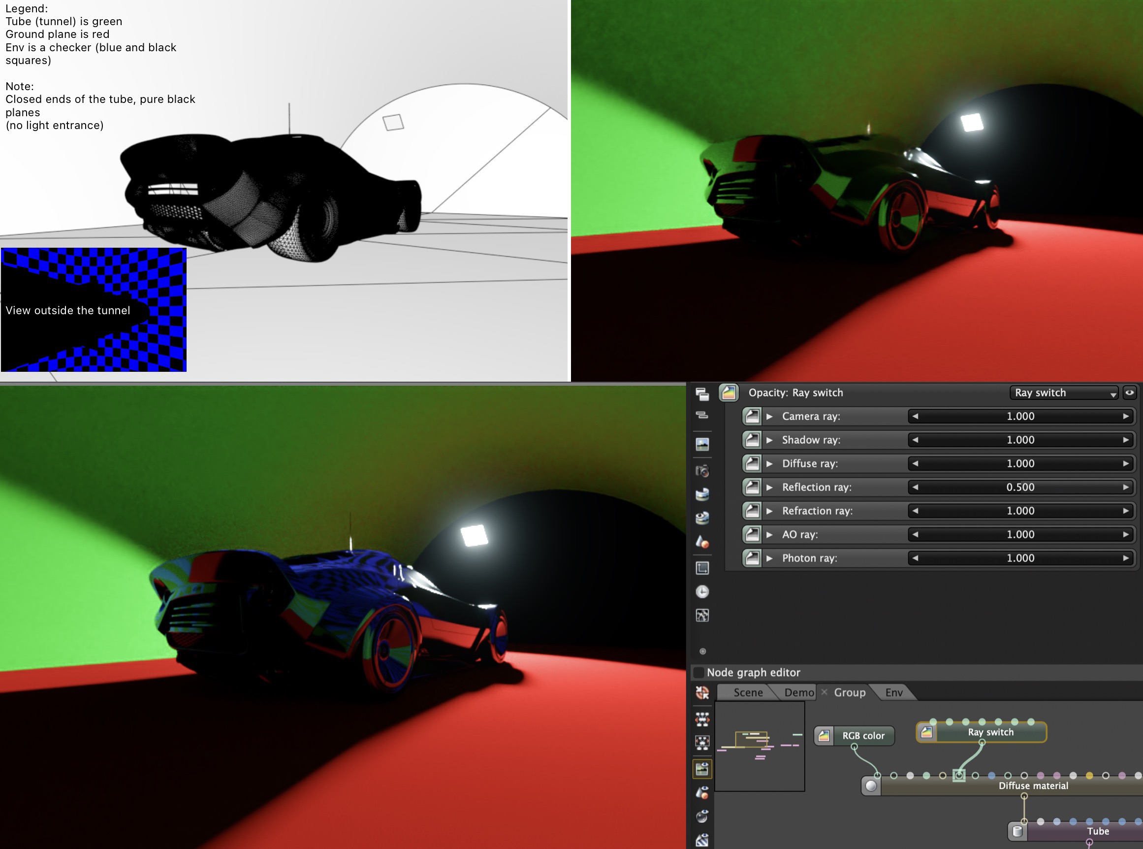

One potential and relatively straightforward solution that wasn't cited (or may be implied at the end) is Ray Switch, here demonstrated at 0.5 [Reflection]:

The Ray Switch slider in question was set to .5, one could think of it as "50% opacity", if at maximum value (0-1) the result is either tunnel reflection or HDRI reflection, not a mix of the two as in the provided example.
