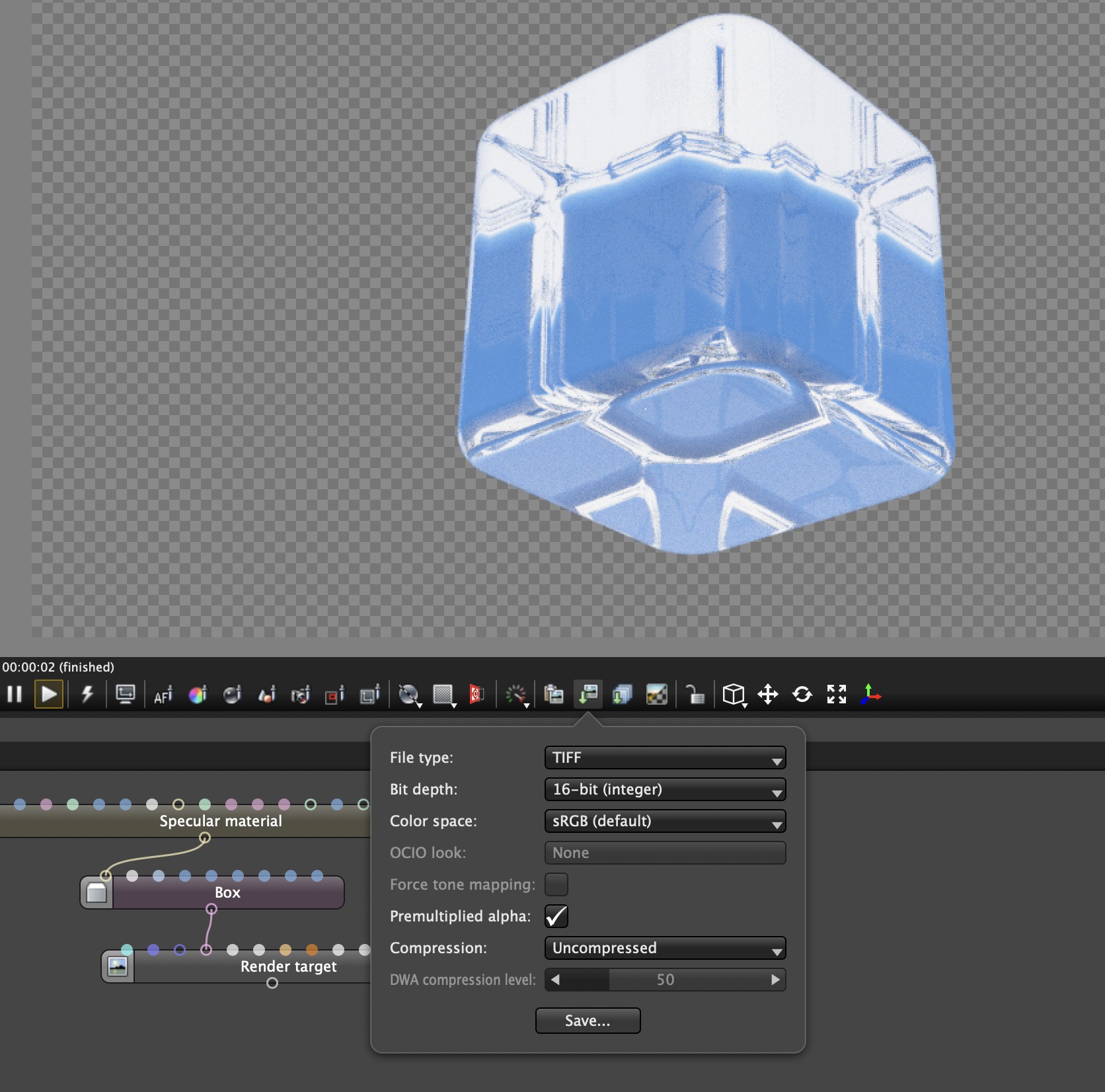

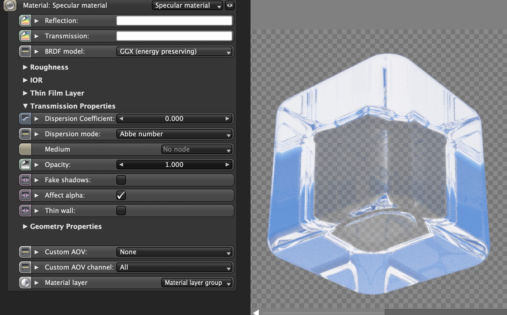

YES! I think you're kidding me. I asked a question specifically about C4d Octane, not about Standalone. Especially not about the beta version Standalone. I hope you'll fix the problems of recording alpha in TIF and PSD in the C4d Octane in the next update. Thanks for the helpful advice about ORBX.skientia wrote: Mon May 12, 2025 2:15 pm Blank test project file In Octane Standalone 2025.a beta 1, the TIFF results are as expected (working, no issue whatsoever).
Exporting the Cinema4D project file as ORBX to import in Standalone for testing purposes would be informative. It would double-confirmed the issue is C4D Octane related.
ok I can confirm that the alpha is missing if "Multilayer file" is checked in the Render AOV manager tab. But only for the Beauty pass itself.
If that checkbox is off, then the Alpha is present (tested latest build and previewed in After Effects).
One workaround until we fix this would be to add an Output AOV with just a Beauty, that will have an alpha. All other AOVs (and the Denoised Beauty too) do have alpha.
Thanks for reporting.
