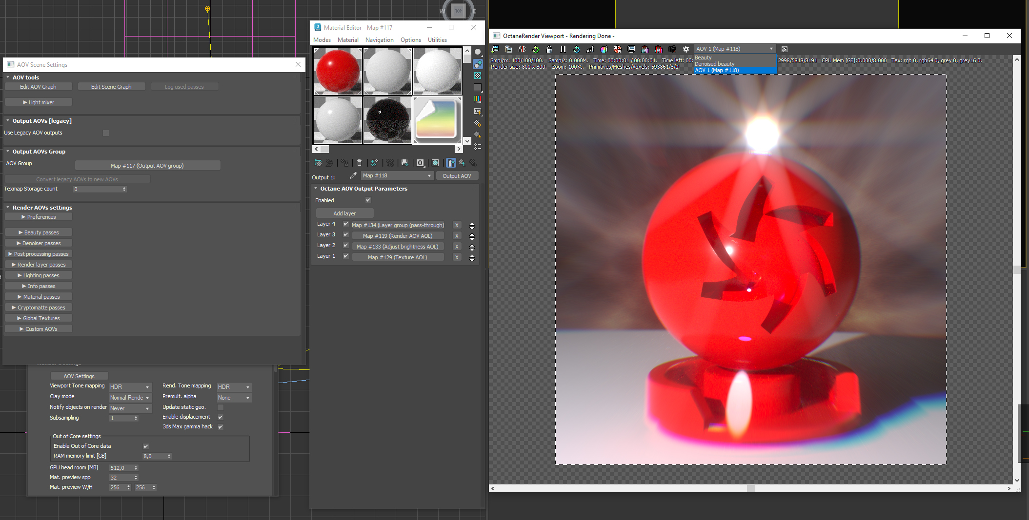

Is it possible to get a denoised post processing pass? When using the post-processing pass it contains artifacts from the un-denoised beauty which causes issues in post, I would like to render a separate denoised pass of it if possible? Without baking into my beauty
paride4331
Posts: 3998
Hi tombyrom,
Would a workflow like this be helpful for you?
Regards
Paride
