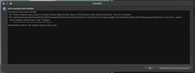

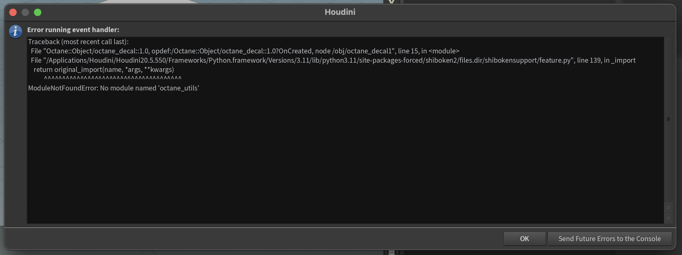

I’m having trouble figuring out how to properly use Decals in the latest version of the plugin.
I keep getting errors.
Here are some screenshots with the issues I’m running into:
Any help or tips would be greatly appreciated!

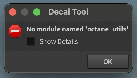

Thanks Dom!
I replaced the file, but unfortunately it didn’t fix the issue.
I’m still getting the same error: "No module named 'octane_utils'"
MacOS 26.5.1, M1 Max, Houdini 22, Octane 2026.5

michaelskripin wrote: Tue Apr 22, 2025 3:52 pm Thanks Dom!
I'm so sorry, this reply totally missed me.
So I was not able to reproduce this issue.
What octane & houdini version are you on?
Could you check in your octane installation, if you can see the script folder?
Inside it should be an "octane_utils.py" file. If you don't see this, then please try installing a fresh version of octane.

dom_otoy wrote: Tue Apr 29, 2025 4:56 pm What octane & houdini version are you on?
Hi!
I’m on Octane 2025.1 for Houdini 20.5.550, macOS 15.4.1.
I checked — octane_utils.py is in place.
Any ideas?
Thanks in advance!
