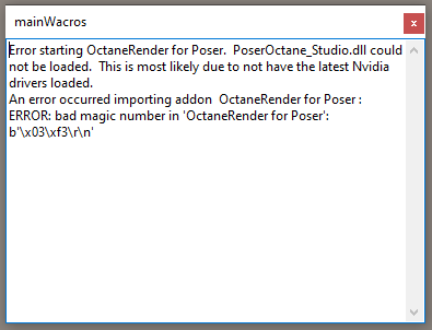

Hi Paul,
thanks for the update of the plugin, but it won't start on my end.
I'm getting the following error msg., even tho I've just updated to the latest nvidia driver (572.83) for Win 10 64bit, the just released new Poser version (13.3.1041) and rebooted.
The latest or 2024 version still run, if i re-install it again.
Any suggestions, please? Thank you.
Edit: I just noticed, I haven't installed an OR 2025 standalone version, would this matter?
Edit 2: I just installed the latest OR 2025 version, within that, it also updated/downloaded and installed the NVIDIA cuDNN thingy, but sadly it still gives me the above posted error msg. (plugin could not be loaded) after starting Poser 13.
Erick
Posts: 249
Joined: Thu Sep 13, 2012 9:40 am
I think I found a solution.
The log gave away, that the octane.dll and octane.dat were not found.
So I located them and put them into the folder, the plugin was looking for them, according to the log (...\Runtime\Python\addons\OctaneRender\Windows\octane.dll and ...\Runtime\Python\addons\OctaneRender\Windows\octane.dat)
Looks like it solved it.
The folder ...\OctaneRender\Windows already had a file named PoserOctane_Studio.dll in it.
face_off
Posts: 15830
Location: Adelaide, Australia
Thanks Erick
I have updated the installer at the top of this thread to fix this issue.
Paul

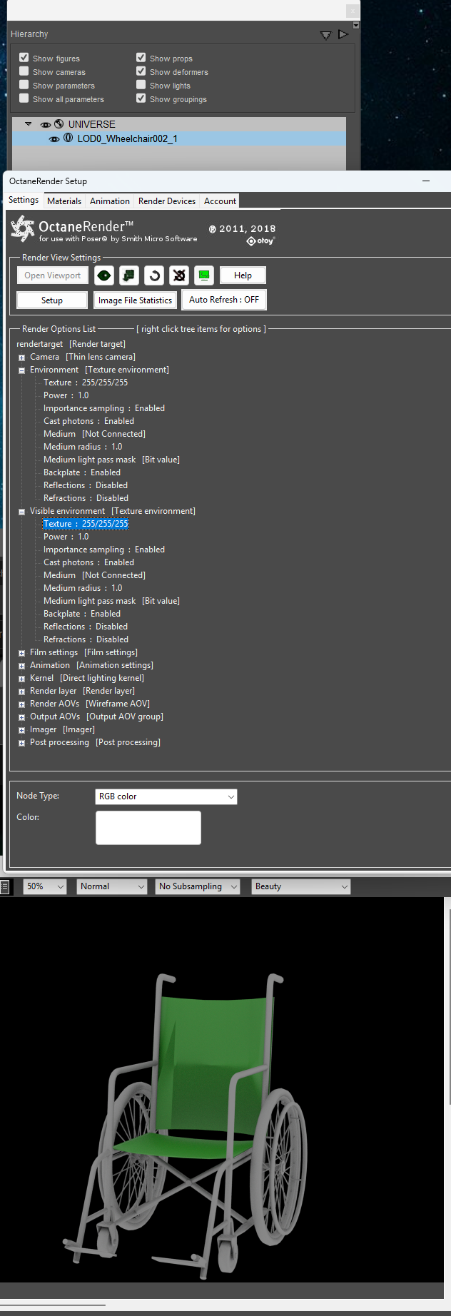

Hey Paul, having an issue. It seems the the back plane is showing just black and the rendering window.
I switch it from planetary or to texture. And the background is still black.
Win 11
Ryzen Threadripper 2950X
128GB RAM
RTX 3060 TI

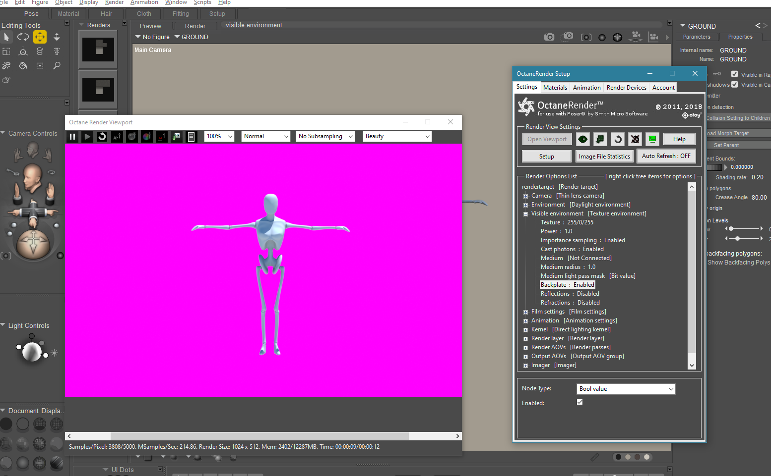

face_off
Posts: 15830
This seems to be working for me.
The backplate only shows where there is no geometry. Is it possible you have the ground plane enabled?
Paul
spartan00j

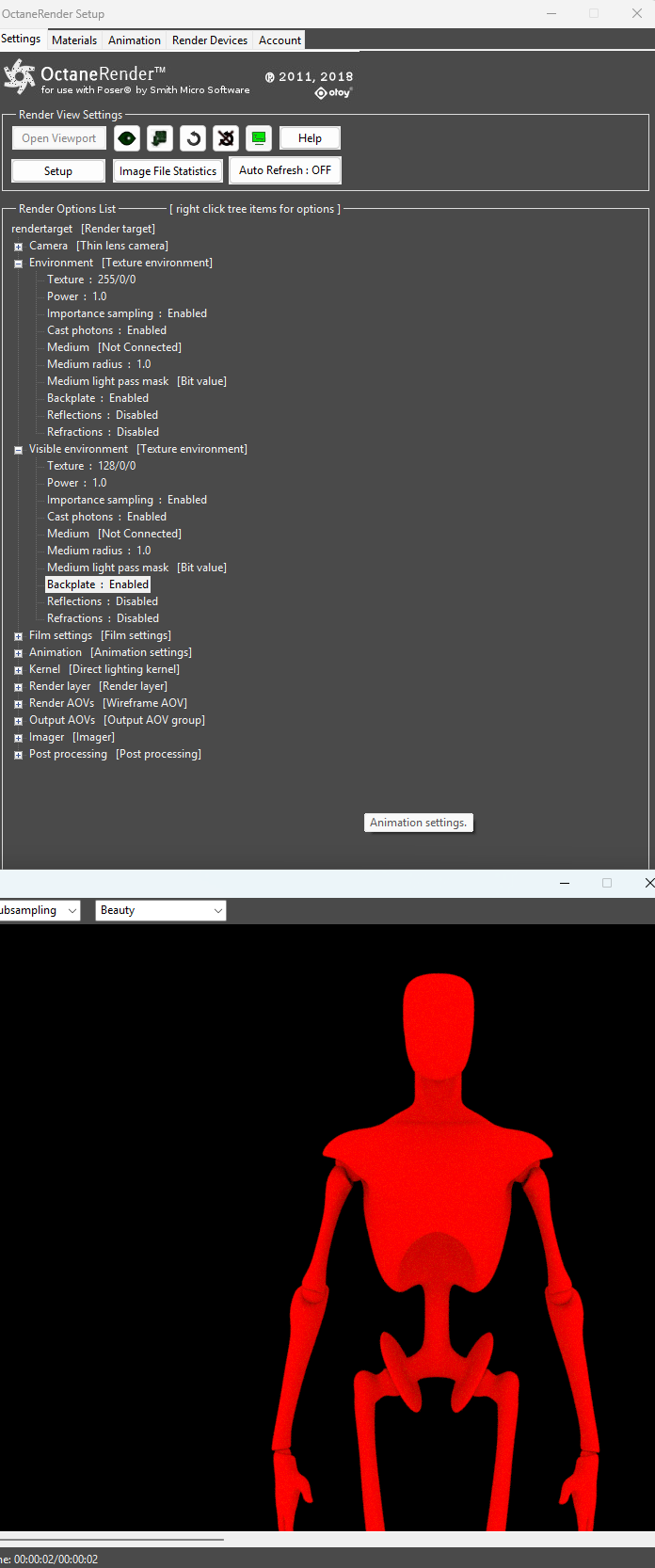

Posts: 357
Joined: Fri Sep 27, 2013 1:27 am
face_off wrote: Wed May 28, 2025 11:02 am This seems to be working for me.
Paul
No, I even deleted it. Same issue
Win 11
128GB RAM
RTX 3060 TI
face_off
Posts: 15830
What is the version number of the plugin that you are using please?
spartan00j
Posts: 357
face_off wrote: Thu May 29, 2025 12:18 pm What is the version number of the plugin that you are using please?
2025.1.0.127.
I think I solved the problem. I tried other old projects and was having the same issue. But one happened to not have that same issue. So I exported the render target settings and applied it to the newer scene. And then save the settings as a default. And I no longer have that issue. Even with newer scenes.
So I think it was an issue with my default settings.
Win 11
128GB RAM
RTX 3060 TI
