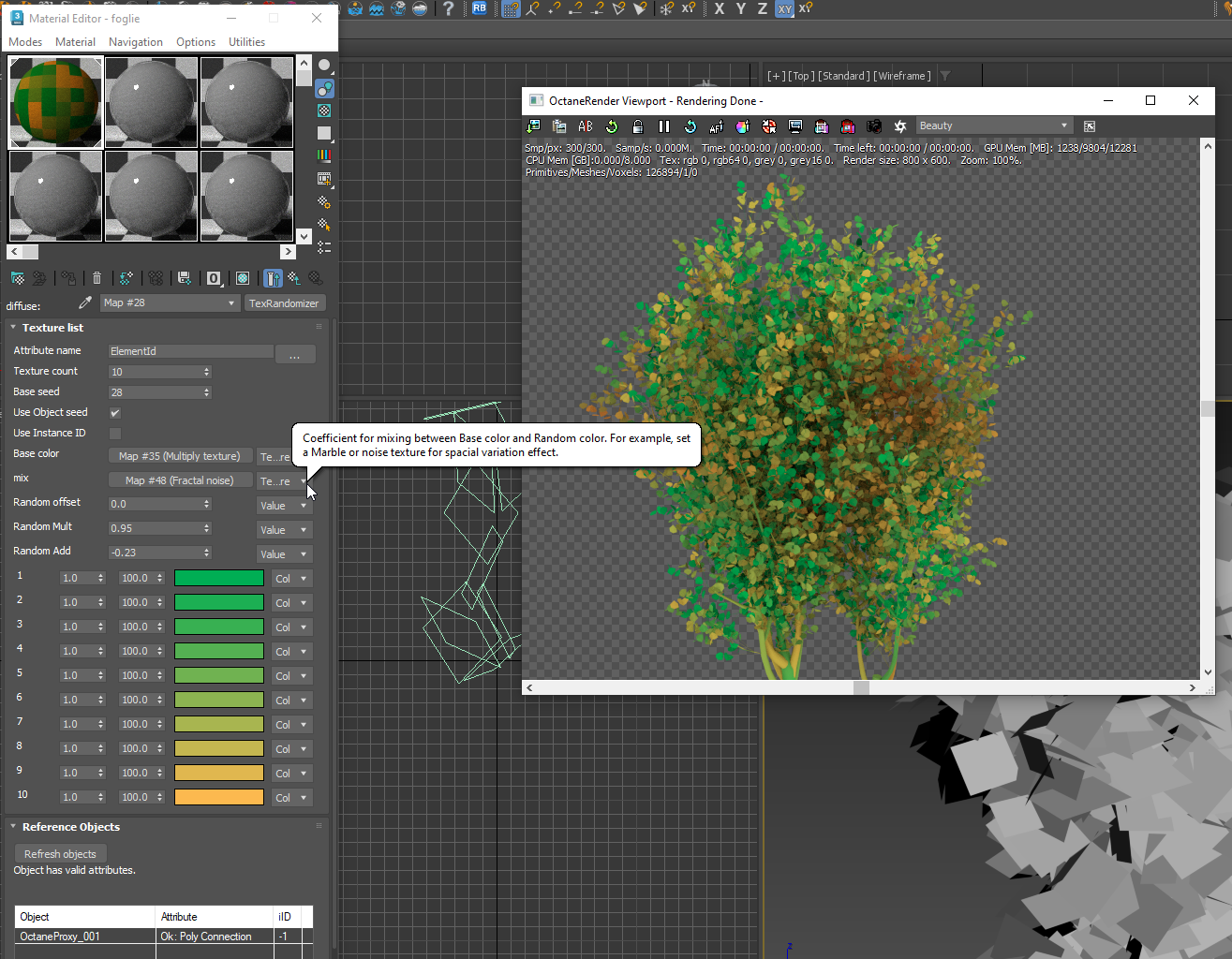

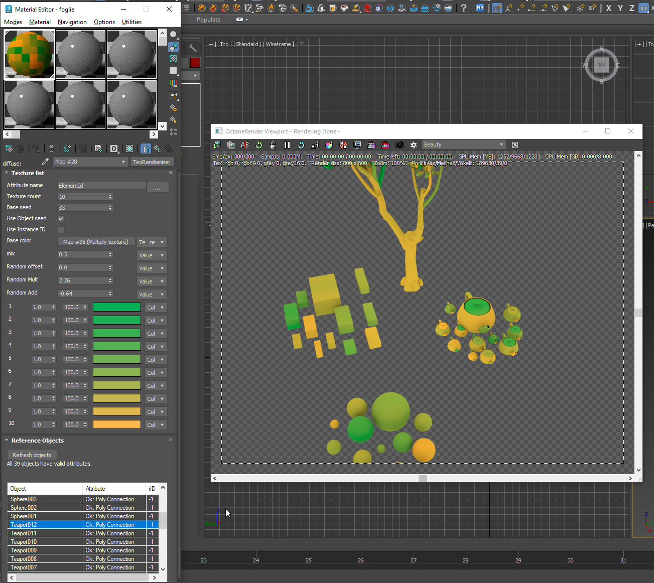

A new texture, TexRandomizer is available from version 2025.1 16.04.
It is designed to assign textures randomly per elements of a single mesh.
To differentiate those elements, it assign an Octane Geometry modifier set to generate vertex attributes with the PolyConnect generator.
(This is done semi-automatically, with the Reference Objects rollout)

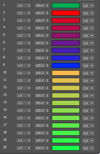

It can use up to 20 textures or colors, with each an Occurrence parameter to set an individual probability per texture.
Those colors can be shifted and multiplied, and then mixed with a Base color / texture.
TexRandomizer can be found in Maps/Octane/Wrappers/

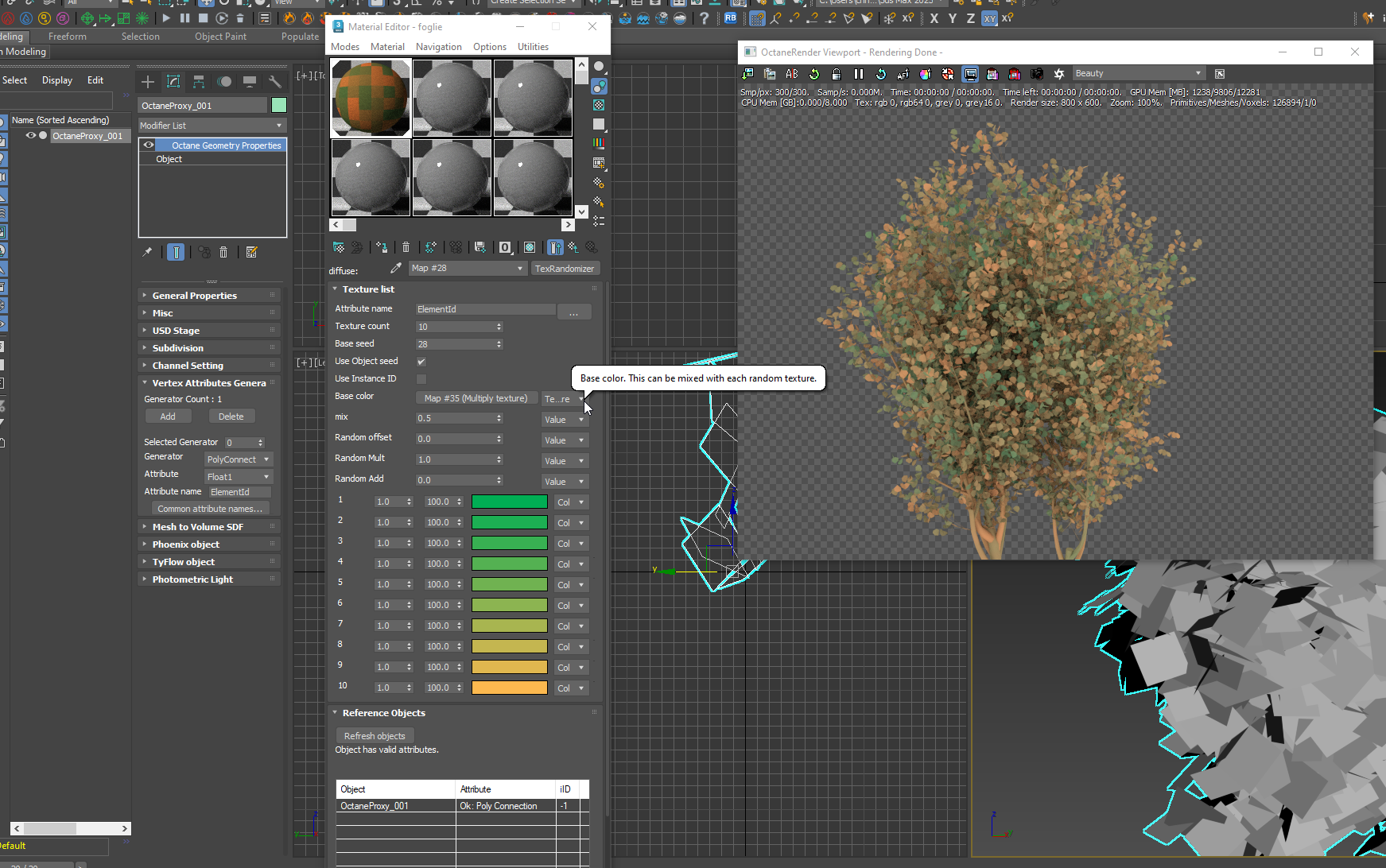

Base color.
A texture or color that will be mixed with the selected random color.
mix
A value, or texture that will indicate how the Base color will be mixed with the random color.
A noise texture can typically be used to randomly mix the base texture based on spacial position.

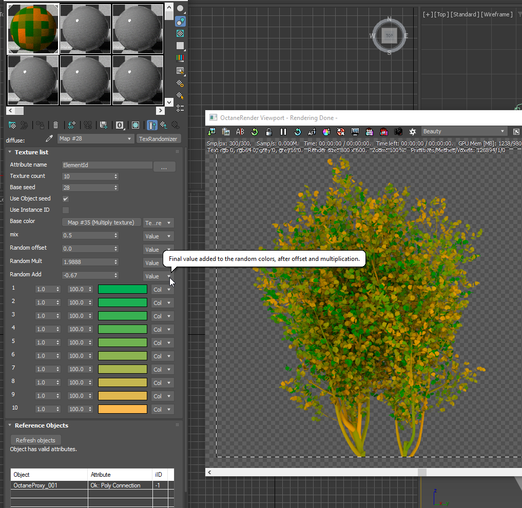

Random offet, Random Mult, Random add:
Can be used to offset and amplify the selected random color, before being mixed with the base color.
The OSL code is something like this:
color baseRnd = ((random_color + randOffset) * randMult) + randAdd;
c = (baseColor * k) + (baseRnd * (1 - k));
Random colors / textures:
There are 2 extra parameters for each texture:
-Mix power : a value between 0 and 1, to indicate how much this texture will be mixed with the Base color
-Occurrence : a positive value, representing a probability to get selected.
Each Occurrence value is normalized in the range (0, total of occurrence values).
For example, if Texture count is set to 3, and the 3 occurrences are 10,20,100, the actual probabilities are 10/130 (7.69%), 20/130 (15.38%) and 100/130 (76.92 %)

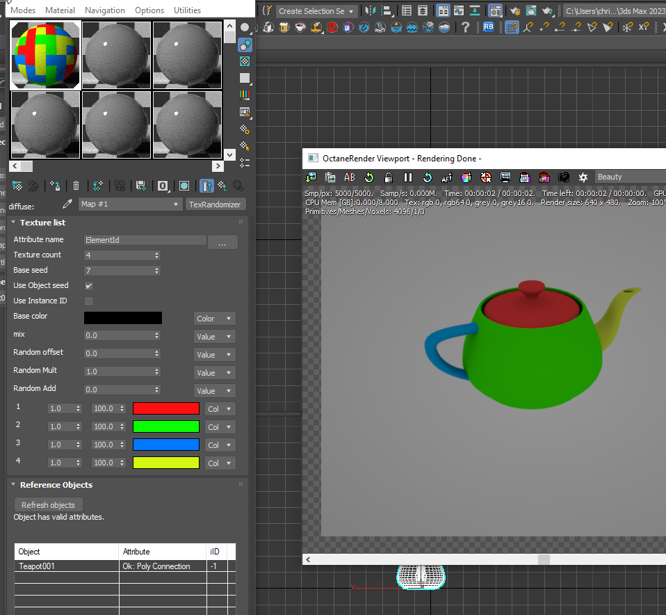

Basic setup steps:
Create a teapot.
Create a Diffuse material in Material Editor.
Set the Diffuse parameter type as a Texture.
Create a TexRandomizer in the Diffuse texture.
Set Texture count to 4
Set the 4 colors as red, green, blue, yellow
Assign the material to the teapot.
Press the Refresh objects button.
Press the 'Fix issues' button.
Open Octane viewport
Change the Base seed to view different random selections.
(see TexRandomizer00_teapot_basic_mx20.max in the samples)

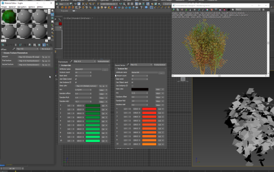

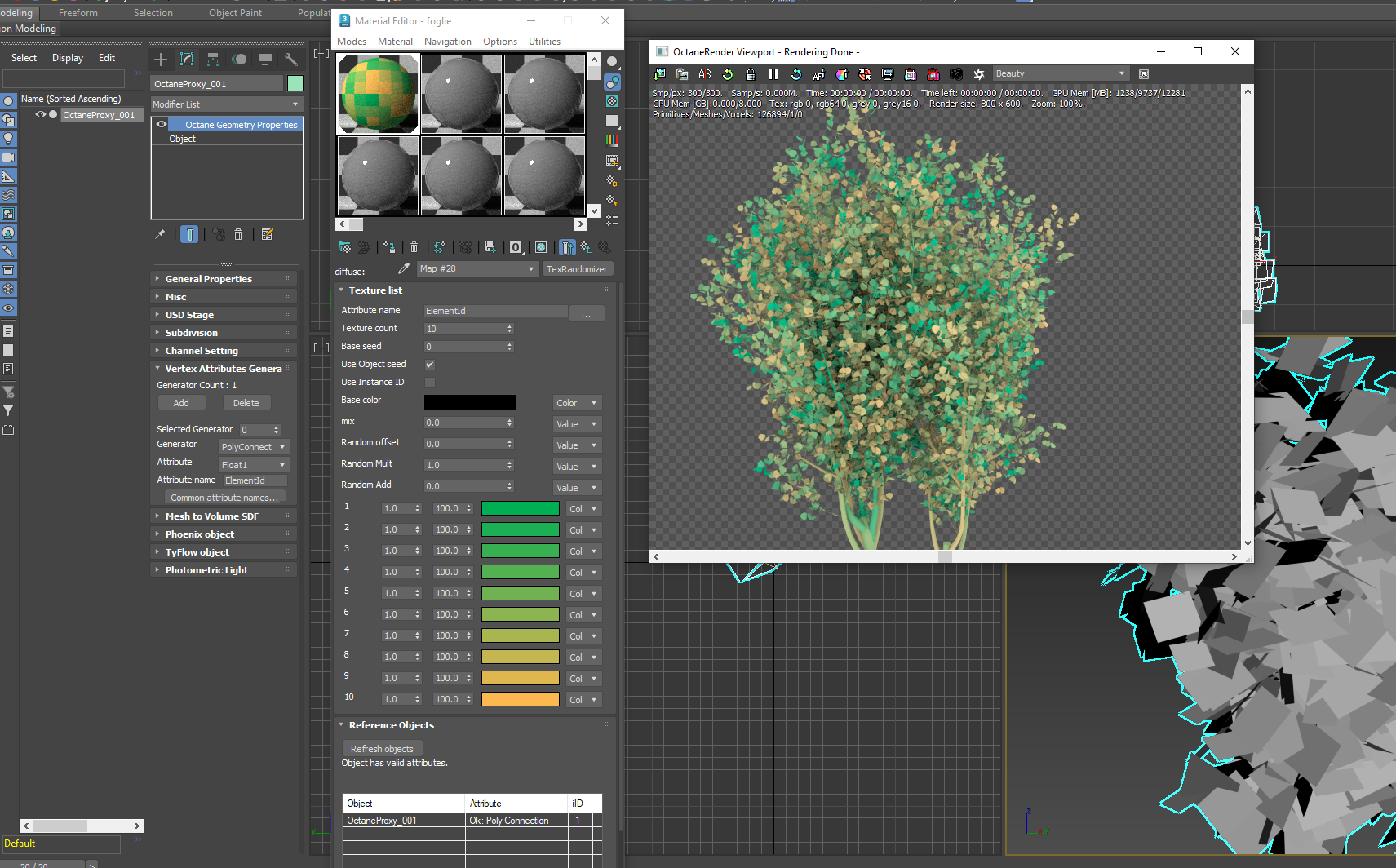

TexRandomizer01_tree03_basic_mx20.max
The default setting of a TexRandomizer.
TexRandomizer02_tree03_BaseTxNoise_mx20.max
The Base color is set as a Multiply texture with a Red color and a Cinema 4D noise,
TexRandomizer03_tree03_BaseTxNoise_darkenRndCol_mx20.max
The random colors are adjusted with Random Mult and Random Add
TexRandomizer04_tree03_BaseTxNoise+noisedMix_mx20.max
The mix texture is set as a Fractal noise, to add variation from spacial element location.

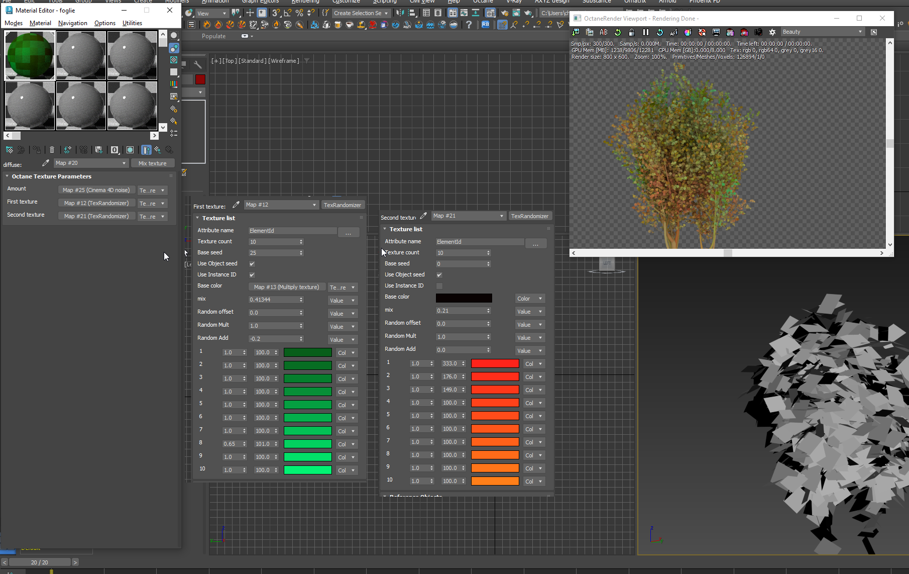

TexRandomizer05_tree03_mixC4D_mx20.max
2 TexRandomizer with green and red tints are mixed with a Cinema 4D noise, to create green and red areas.

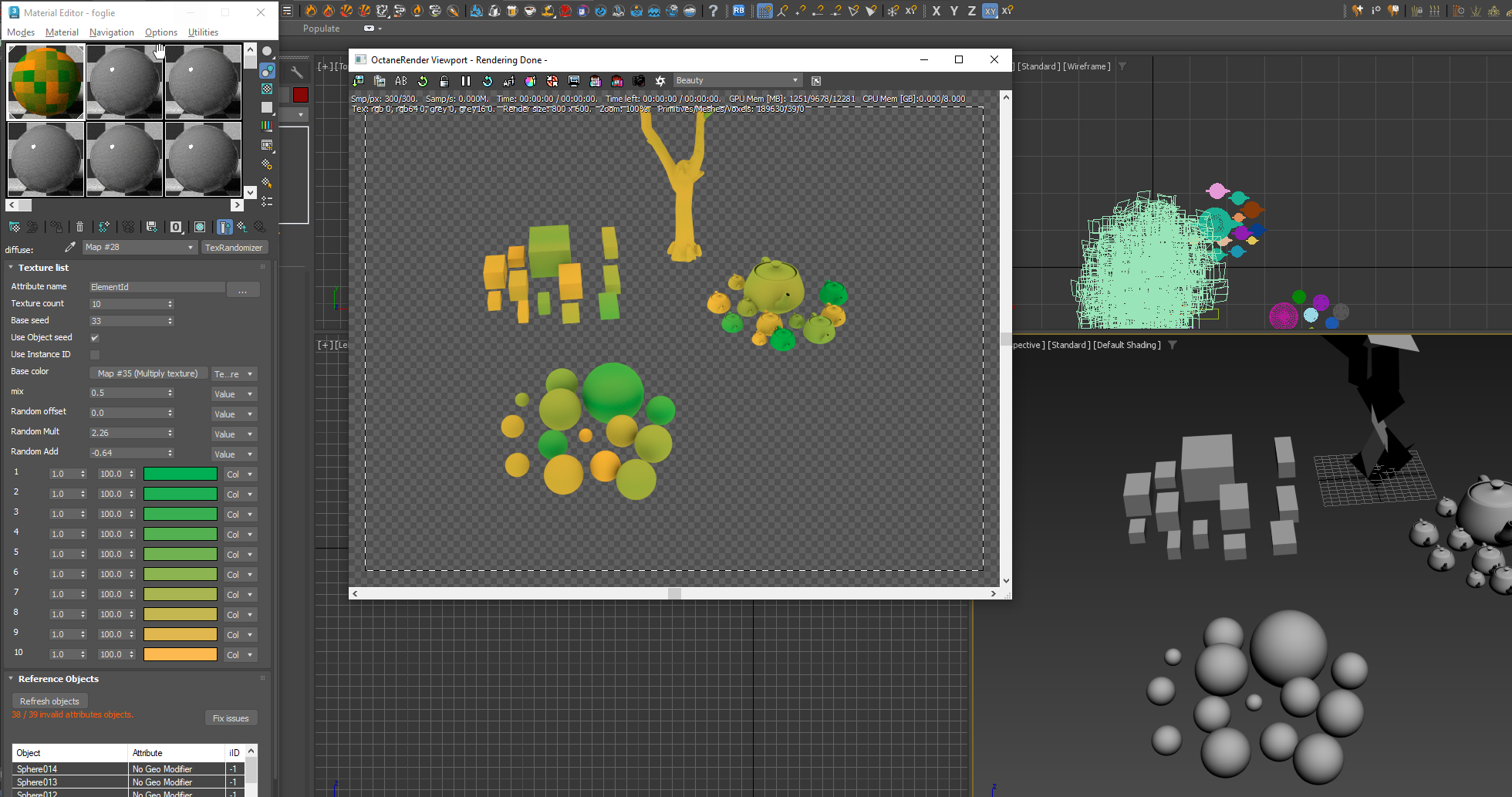

TexRandomizer06_objects_objSeed_mx20.max
Usual objects can be used without Octane geometry modifier / without vertex attributes
TexRandomizer07_objects_elementIDs_mx20.max
ElementId / Poly connect can be added to objects that have multiple elements (teapots).
(Similar to tutorial TexRandomizer00_teapot_basic_mx20.max)

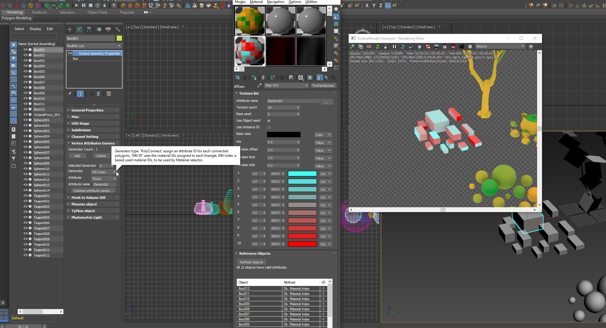

TexRandomizer08_objects_MtlIdx_mx20.max
mesh faces can be differentiated with their Material IDs, using the Material Index generator.
This setup vertex attributes based on the material IDs.
Note that the attribute name is left as 'ElementId'. This works fine, as long as both the attribute generator and the TexRandomizer use the same name.
It could be changed to MaterialIndex for clarity...

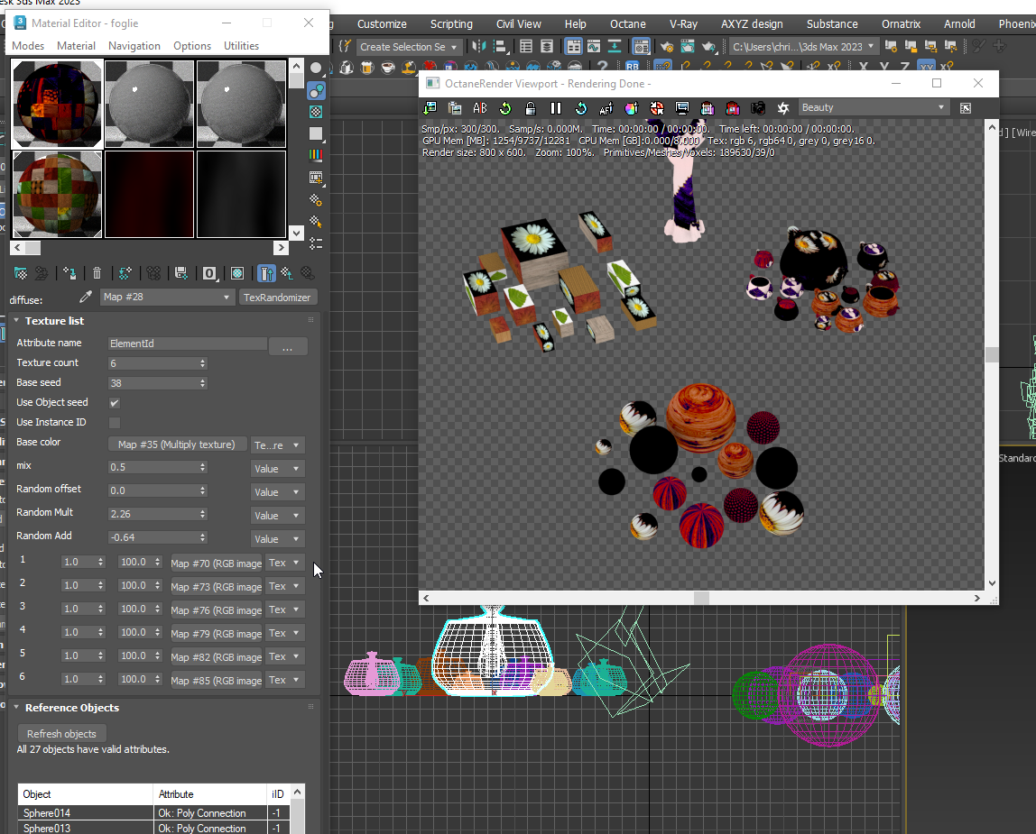

TexRandomizer09_textures_mx20.max
Textures can be used instead of colors.

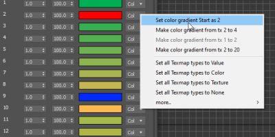

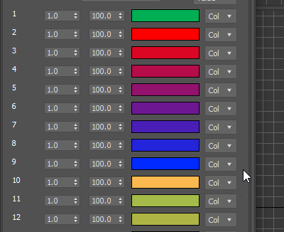

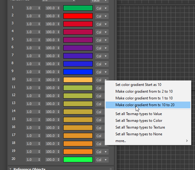

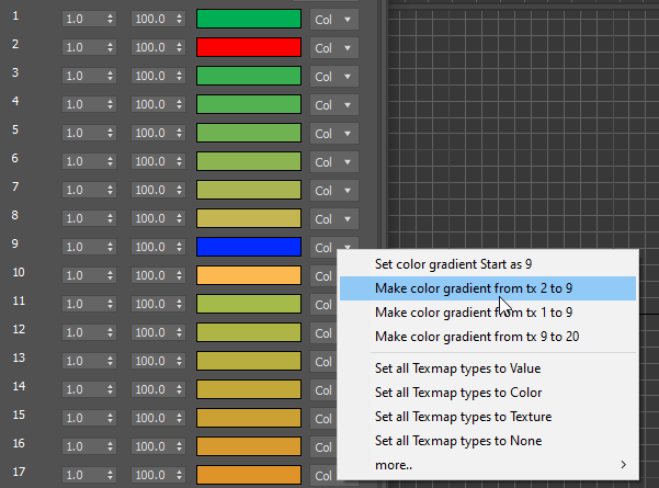

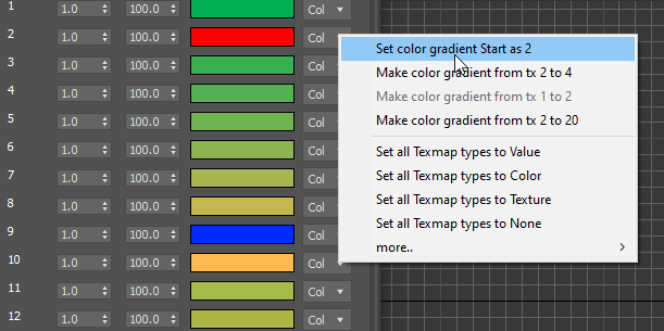

Note: A set of gradient tools can be found in the context menu (right click) of each random texture type.
This allows to create colors from first to current, current to last, and a 'start' to current. The 'start' one can be set with the 'Set color gradient Start as ##' option
