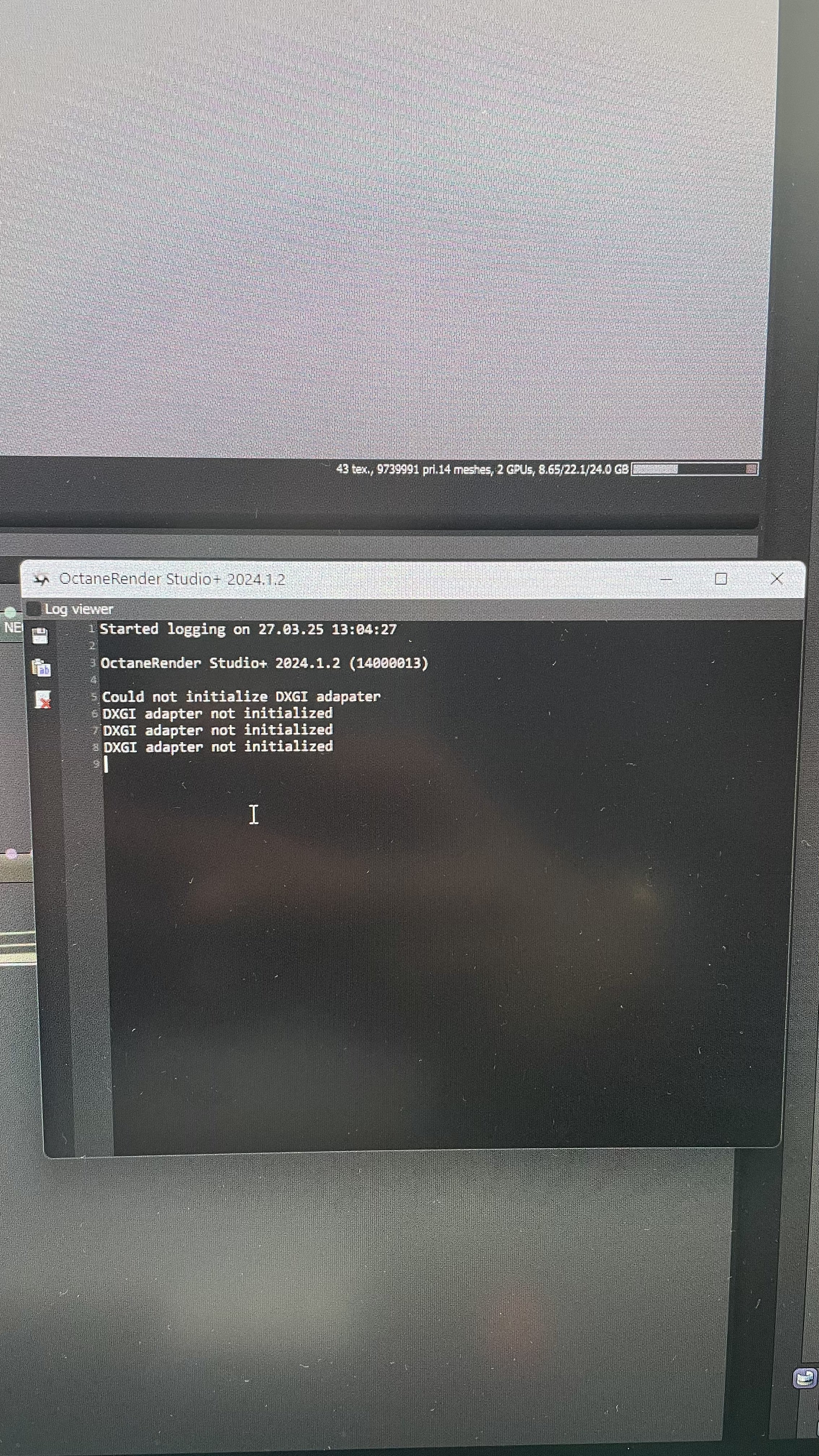

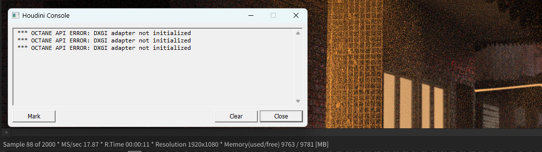

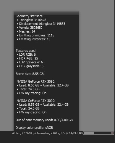

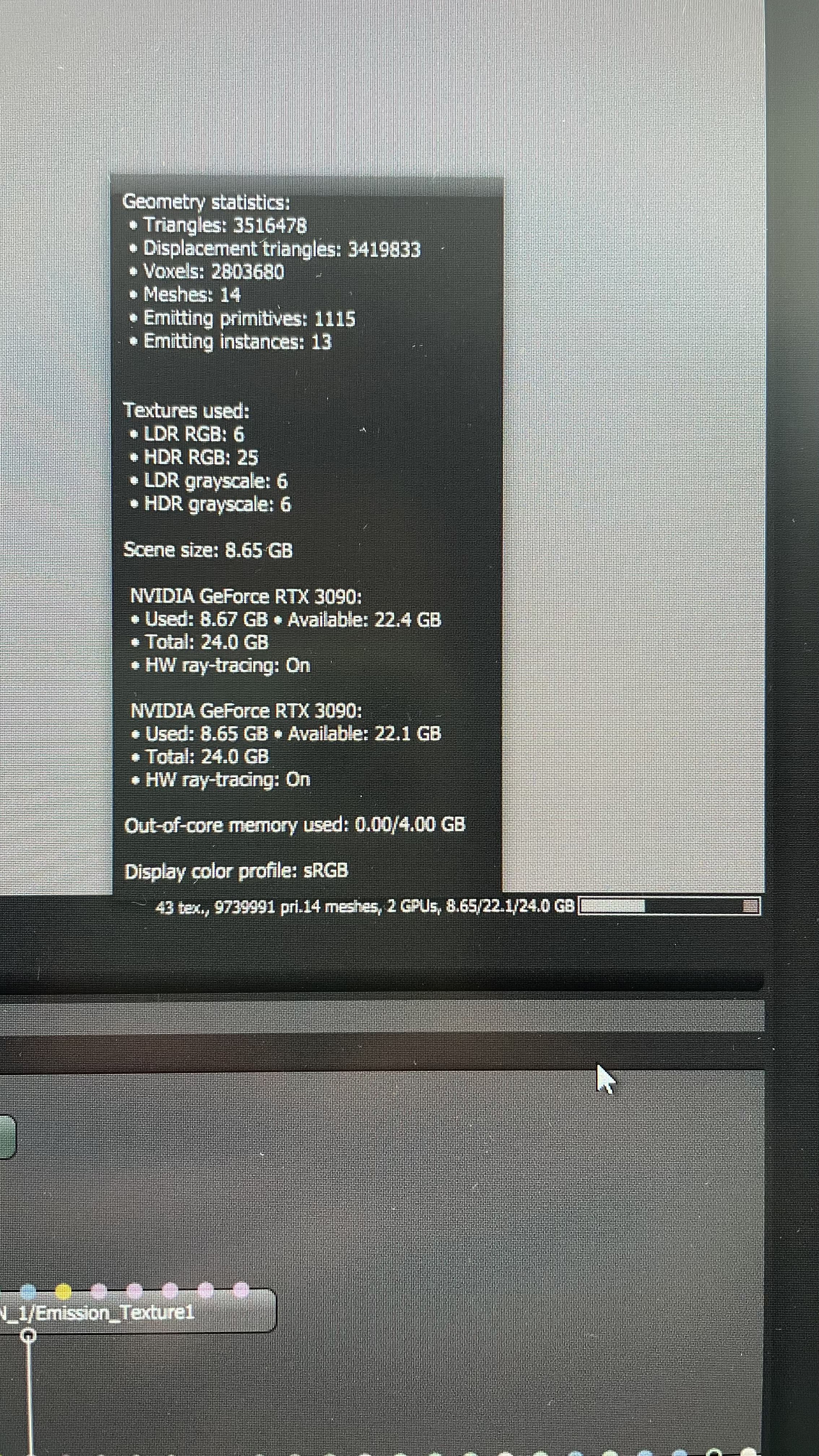

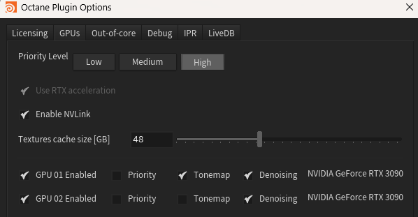

I'm facing the issue that the Error Console shows me this, as well as the Memory that has been used, but it does not visualize the full amount of my VRAM.
I"ve enabled nv link in the the plugin options as well as in the Nvidia Control Center.

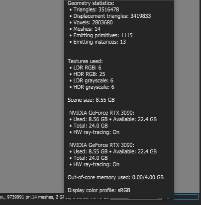

Hi dom_otoy,
thanks for getting back to me. Unfortunately this issue presist also in Octane Standalone. Please see below:

Al88 wrote: Tue Mar 25, 2025 2:14 pm .. but it does not visualize the full amount of my VRAM.
it will not show You 48, it would still show 24, but at least in Standalone, there should be another bar pointing p2p usage: Let me find or make You a screenshot.
that message though, that You make screenshot of does look strange. Do You have the physical bridge between cards installed?

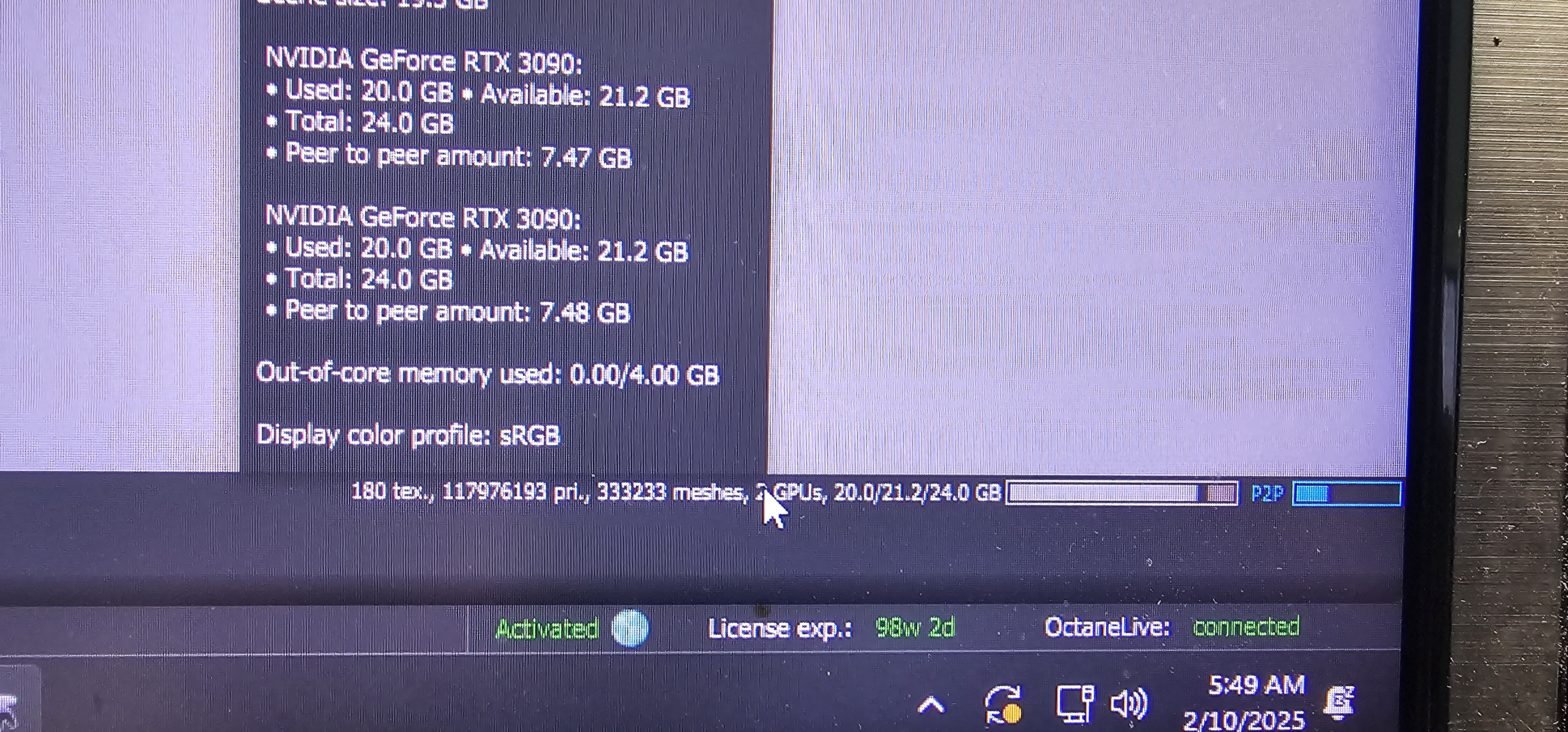

Posts: 3740
That's how NVLINK is reflected in Standalone when it works as it should. Additional BLUE bar is visible and You can also see another line (Peer to peer amount)

Looks like this is an Octane Core issue.
I'll forward it to the devs!

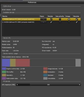

Could you confirm this is also happening to you using some not so recent NVIDIA drivers and share a screenshot of your Octane Standalone device settings window (File -> Preferences -> Devices)?
Also if you could try this with the latest version of Standalone available here and let us know if this still happens that would help.
Thank you.

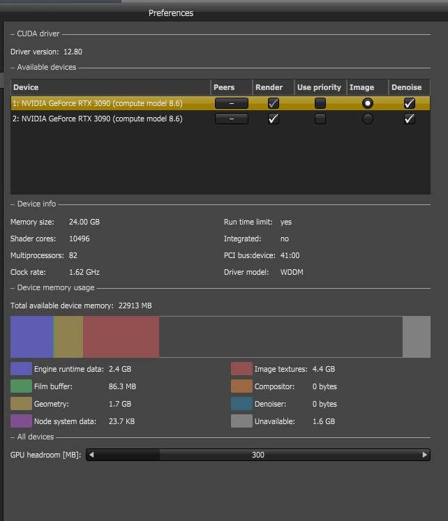

please find below the screenshot for Octane Standalone with the latest driver. I have enabled the P2P, there yo can see it is working. Nevertheless, my goal is actually to have the NV Link working as intended within the Houdini Plugin.
Is there a Driver Version you would recommend?
Without the P2P
Without the P2P

Hi AI88,
The issue might actually be related to using NVLINK, causing Windows not to report the CUDA devices properly to Octane, we will need to look into this in more detail to give a solution. One way you can possibly get around this issue in the meantime would be reverting to Octane 2023 which should not be affected by this issue, and we will get back to you as soon as we have more information.
Besides that, please note that your device settings do not show any peers being selected, so it does not seem you are using P2P despite having installed an NVLINK bridge.
https://docs.otoy.com/standaloneSE/NVLi ... rGPUs.html
