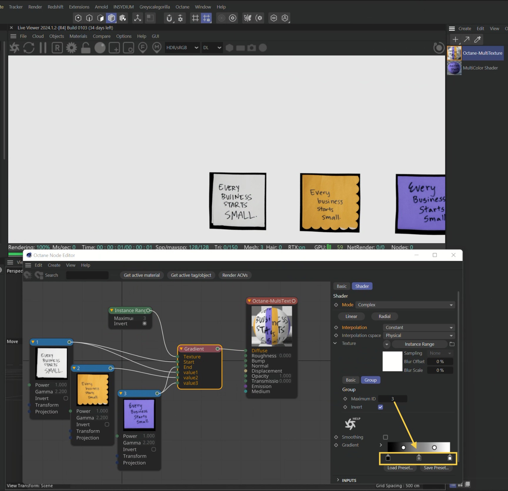

Switch Texture node is not what you need, it is used to show a specific texture based on Input number.
What you need is an Octane Gradient node in Complex mode and Constant interpolation, with an Instance Range node as Input Texture, and you need to create a number of knots in the Gradient equals to the ID Number in Instance Range node, in order to have all the necessary pins for connecting all the different textures:

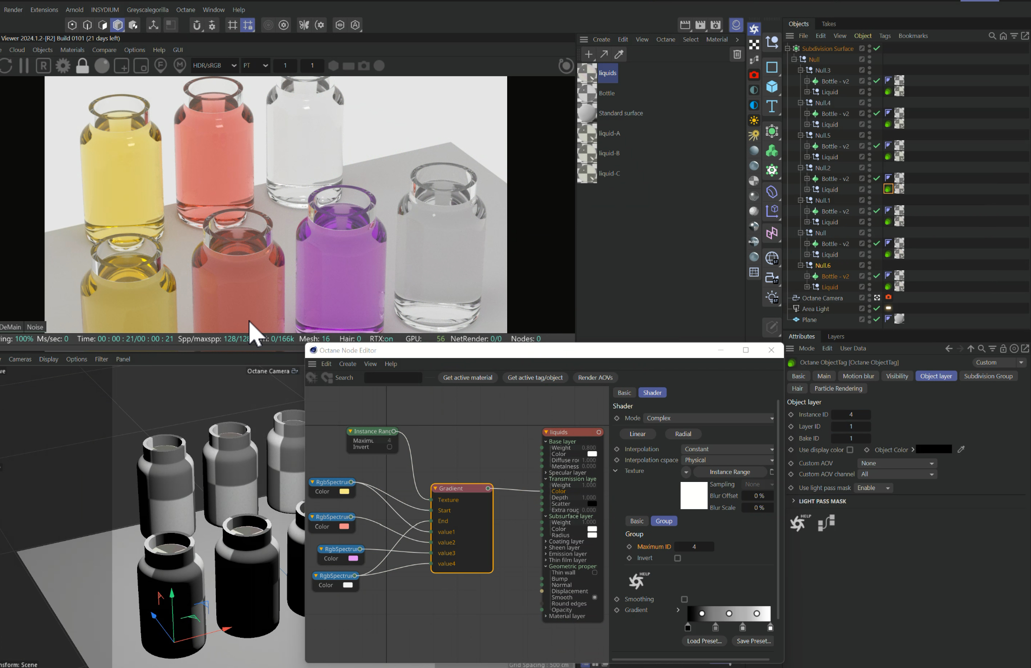

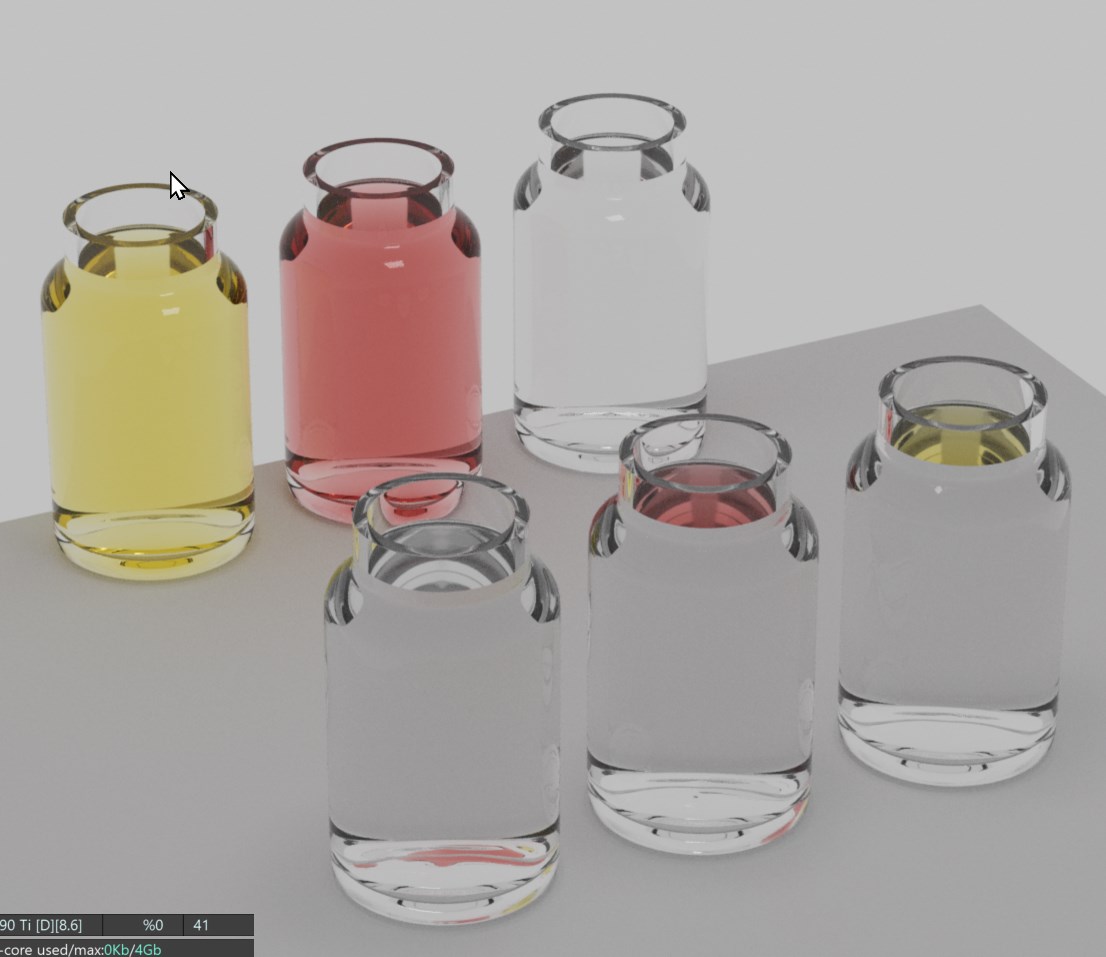

I solved one side of the repetitive material problem with your solution, but a problem occurred with translucent materials."
I added a sample scene.
nested translucent materials have a problem.
Front line uses single material with your solution
back like uses separated materials.

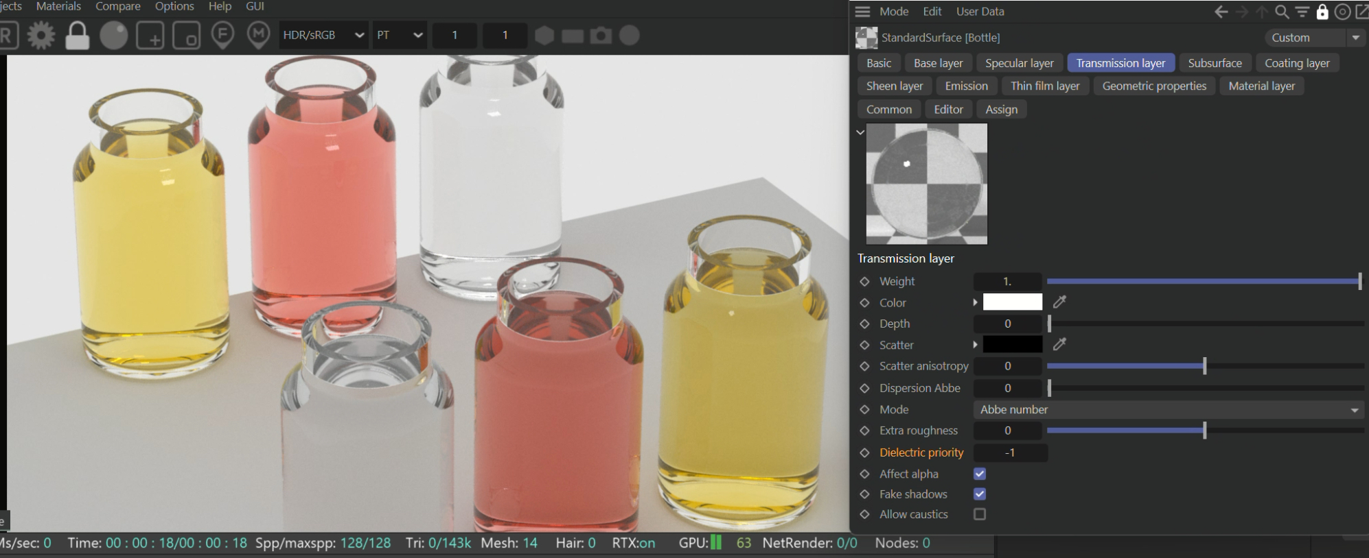

Weird, if you set the Bottle Dielectric priority to -1, it works as expected:

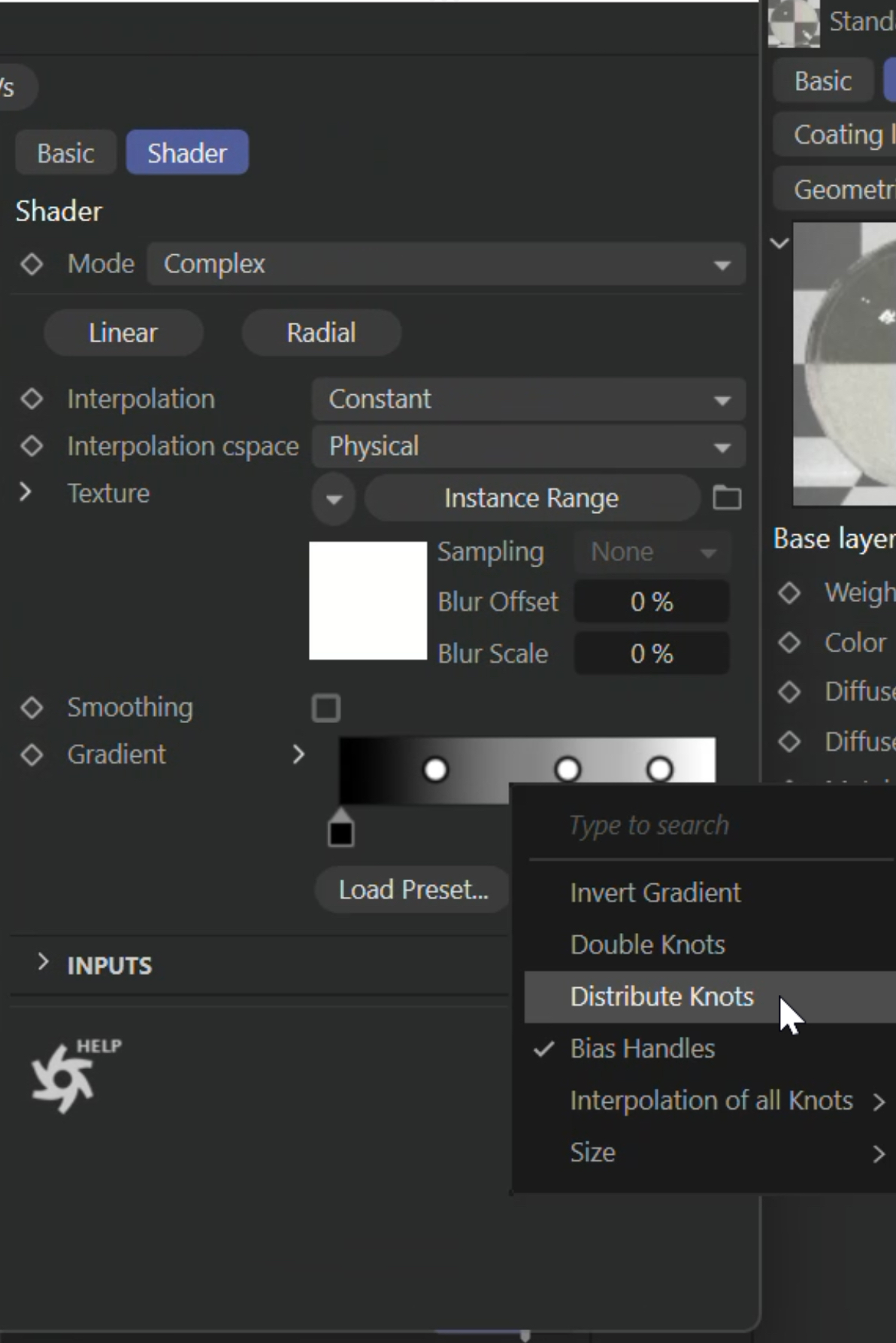

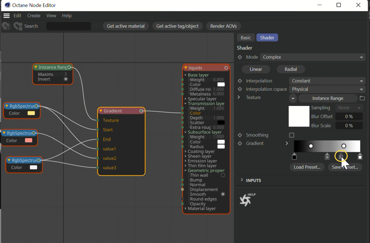

About adding a texture/color to multi texture setup, just click on the gradient to create a new knot:
Then right click on the gradient to distribute evenly the knots:
Then correct the Instance IDs of the object, ed increase the number of Maximum IDs in thee Instance Range node:
