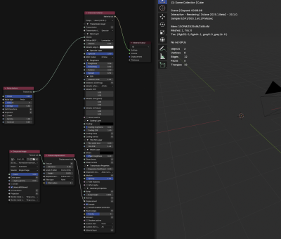

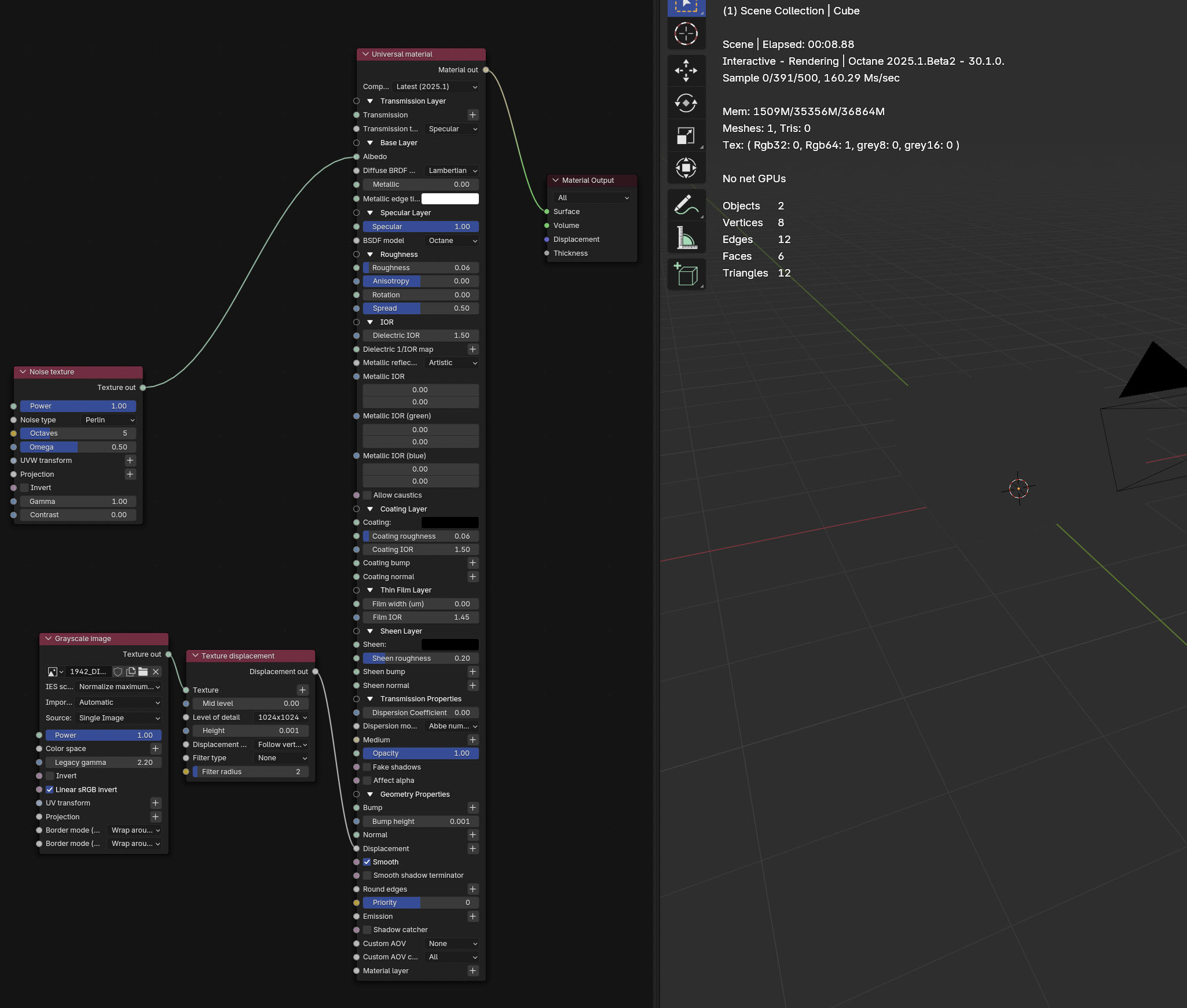

Any time I add a displacement to any material type, the material no longer appears in the render view. I've tried with multiple files, multiple material types, should be easy to replicate assuming this isn't some weird issue only I am experiencing.

I don't have a mac to test this.
Just a few considerations.
Texture Displacement needs UVs to work.
Also, you need a baking node if you want to use a Grayscale or an RGB node with Texture Displacement.

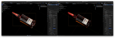

metajerk
Posts: 12
Joined: Thu Jun 13, 2019 12:19 am
Here is the exact same scene loaded in Beta 1 and Beta 2.
Definitely something is up.

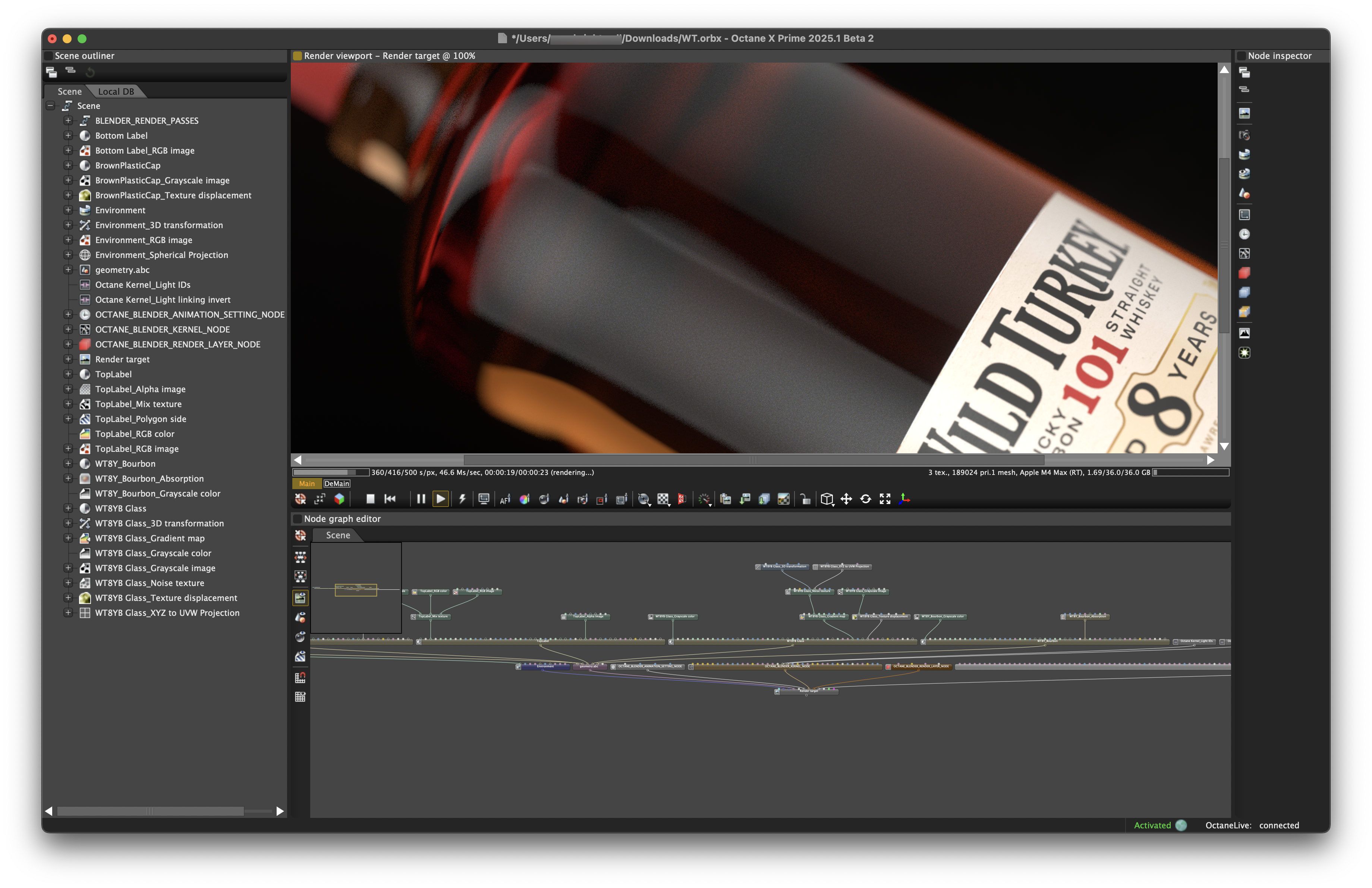

On the other hand, can you please try this exported scene in the 2025.1.Beta2 Standalone and let me know whether the displacement renders there? Thanks!

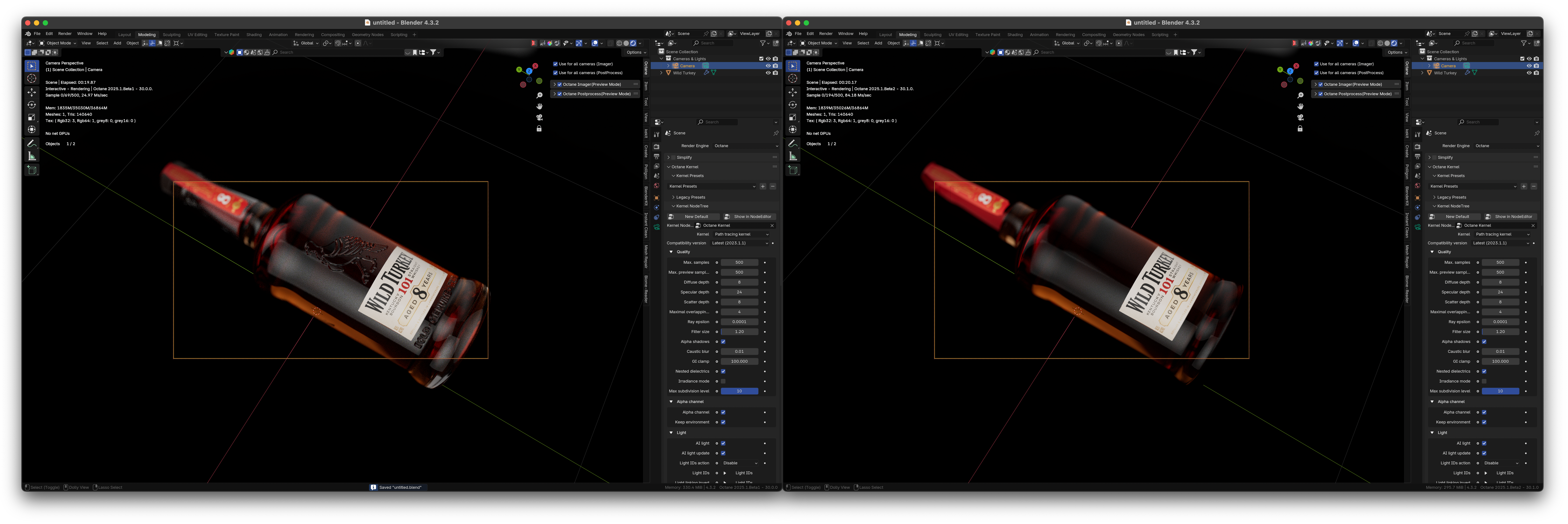

metajerk
Posts: 12
DrawFun wrote:The 30.1(2025.1.Beta2) renders correctly in my tests on OSX 14.x. We'll test it on 15.x further.
It does not render correctly. Screenshot attached
