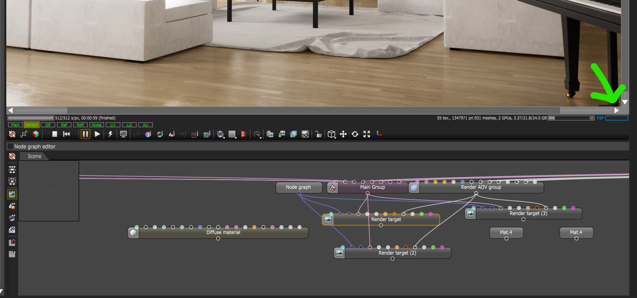

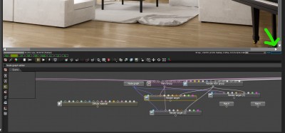

Looking good, guys.
Any plans to add the Nvlink P2P Memory Pool usage in the liveview interface?
Octane Stand Alone has it since many versions since 30XX series were around.
Would be great to have it in C4D and monitor its use.

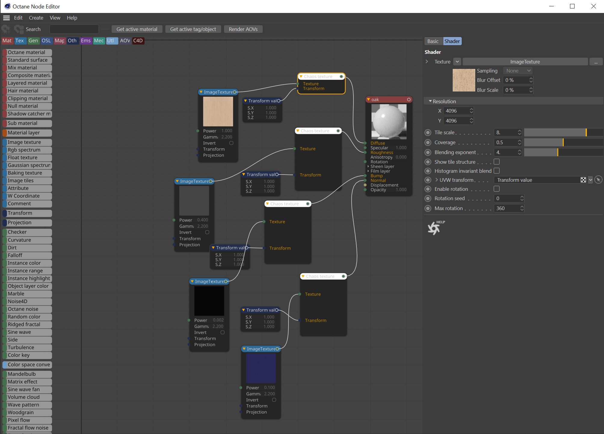

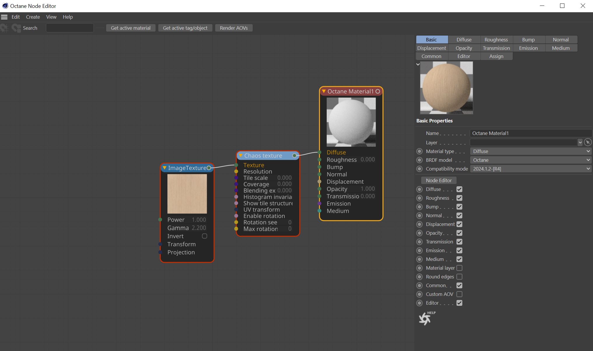

I have encountered a problem with Chaos texture. I have created a material with Chaos texture and saved it on LiveDB manager.
As I try to use this material from Live DB, on Octane Node Editor the Chaos texture node is changed in appearance, it losed input pin .
There is also a problem in preview Octane Material node, it appear white, this is a problem that occur for some time.
Regards

augdalmo wrote:Hi,
Regards
Yes, chaos nodes from LiveDB/ORBX still use the old chaos node for now. This is because LiveDB stores materials as octane OCS, and not as plugin nodes.
We are currently working on supporting conversion from LiveDB/ORBX to the new node system. But for now it will generate the older nodes.
Ill see if i can fix the whiteness
