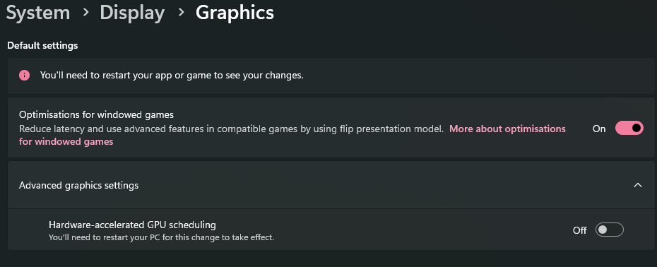

What I would like to know is:
your Nvidia Driver Version
Your HAGS settings "Hardware Accelerated GPU Scheduling" settings and if you perhaps have set Cinema4D to "Game Mode" in that window.
We saw that the checkbox "Optimisations for Windowed Games" can cause all kinds of instabilities with C4D+Octane.
Your experience definitely is not "normal".

Hey DinoMuhic
Yep just sent reports and few videos
As for NVidia Drivers, there are various combos. Now is the most stable it has been for a while, with everything on the latest version. But still get crashes. Only been since moving to windows 11 that its bad.
Do you mean these settings as pictured? (I've just turned off)
thank you
