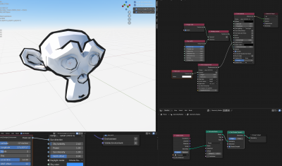

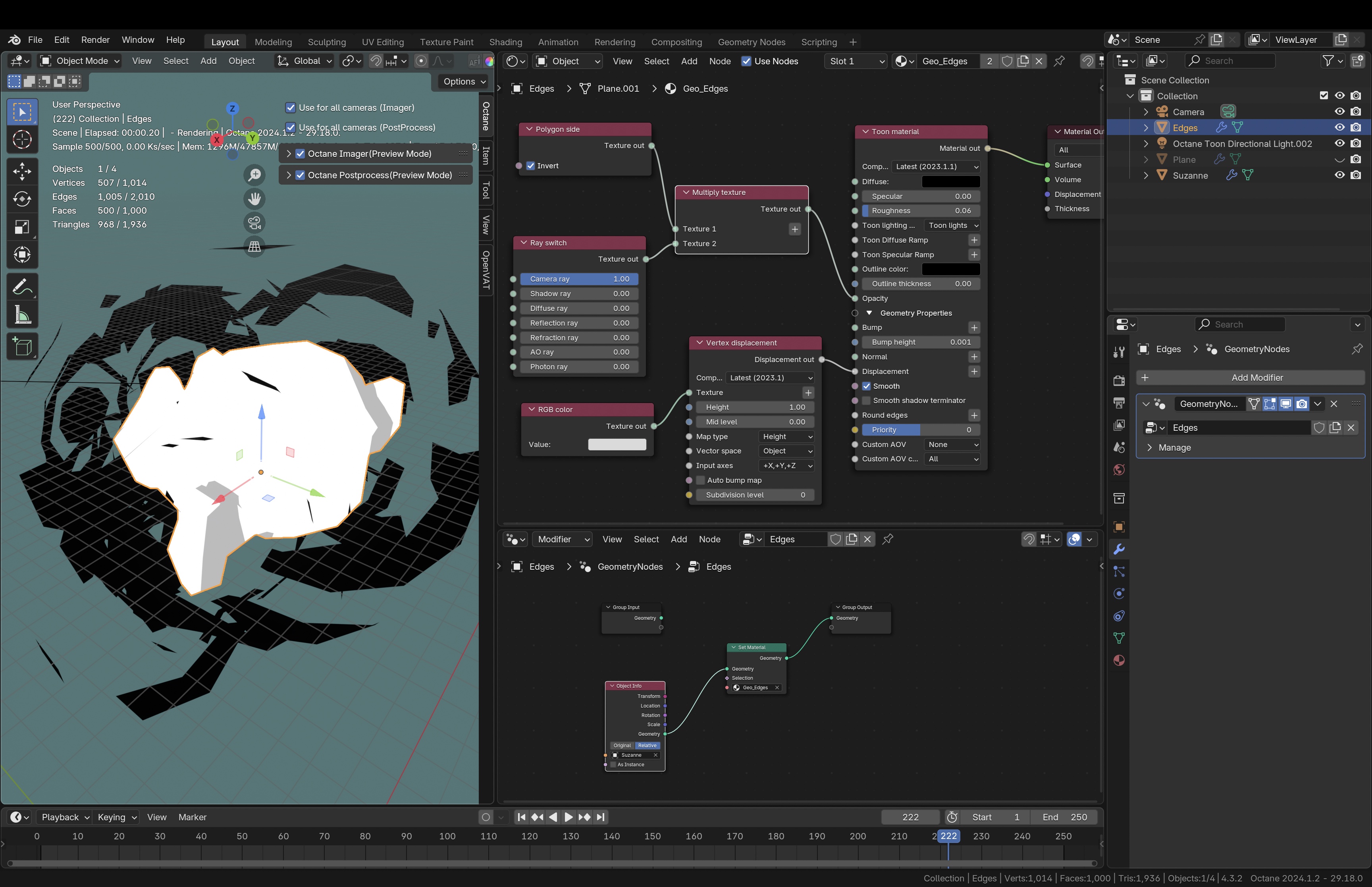

When using Shade Auto Smooth (the smooth by angle modifier), with a toon material and a vertex displacement on it, the displacement looks broken.
Shade Auto Smooth and Vertex Displacement

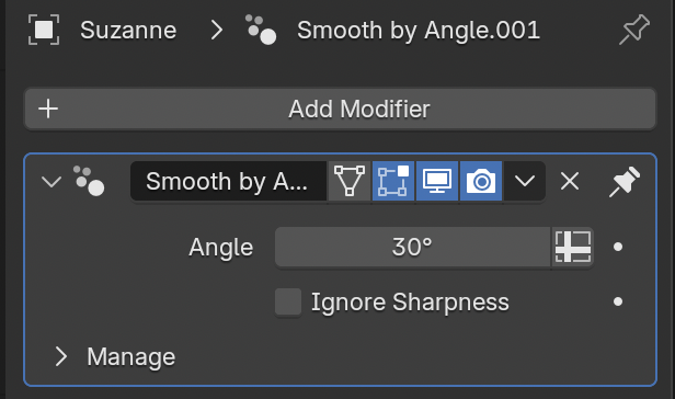

Smooth by angle modifier

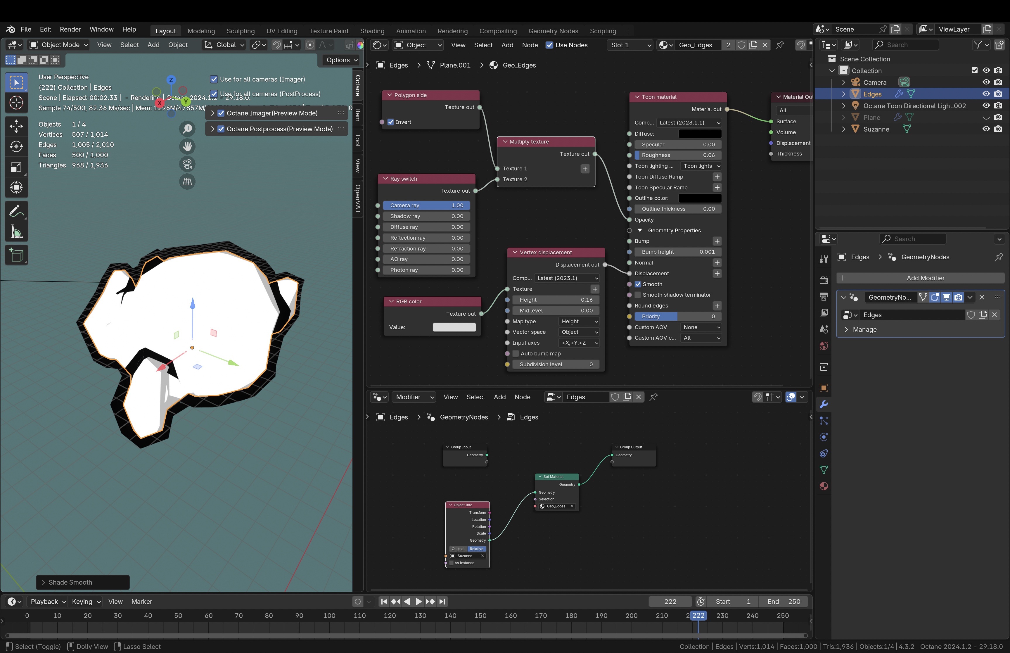

However it looks fine when used with "Shade Smooth".
Shade Smooth
Shade Smooth

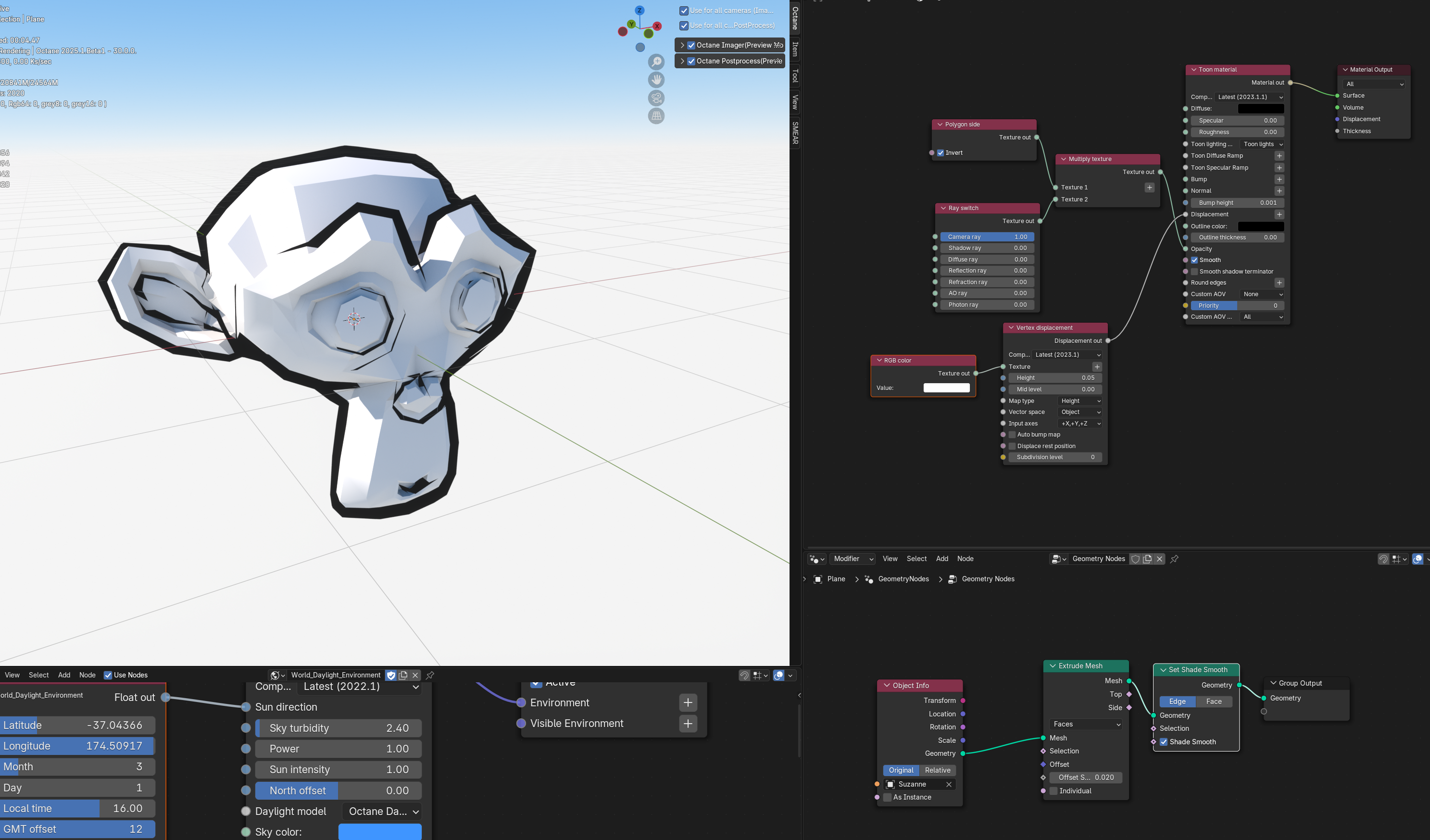

No, that's not a bug.
Just add a Set Shade Smooth in Edge mode to the geonodes you're using to generate the edges.
Vertex Displacement is not even needed if you're using an Extrude Mesh node, which produces a better result.
