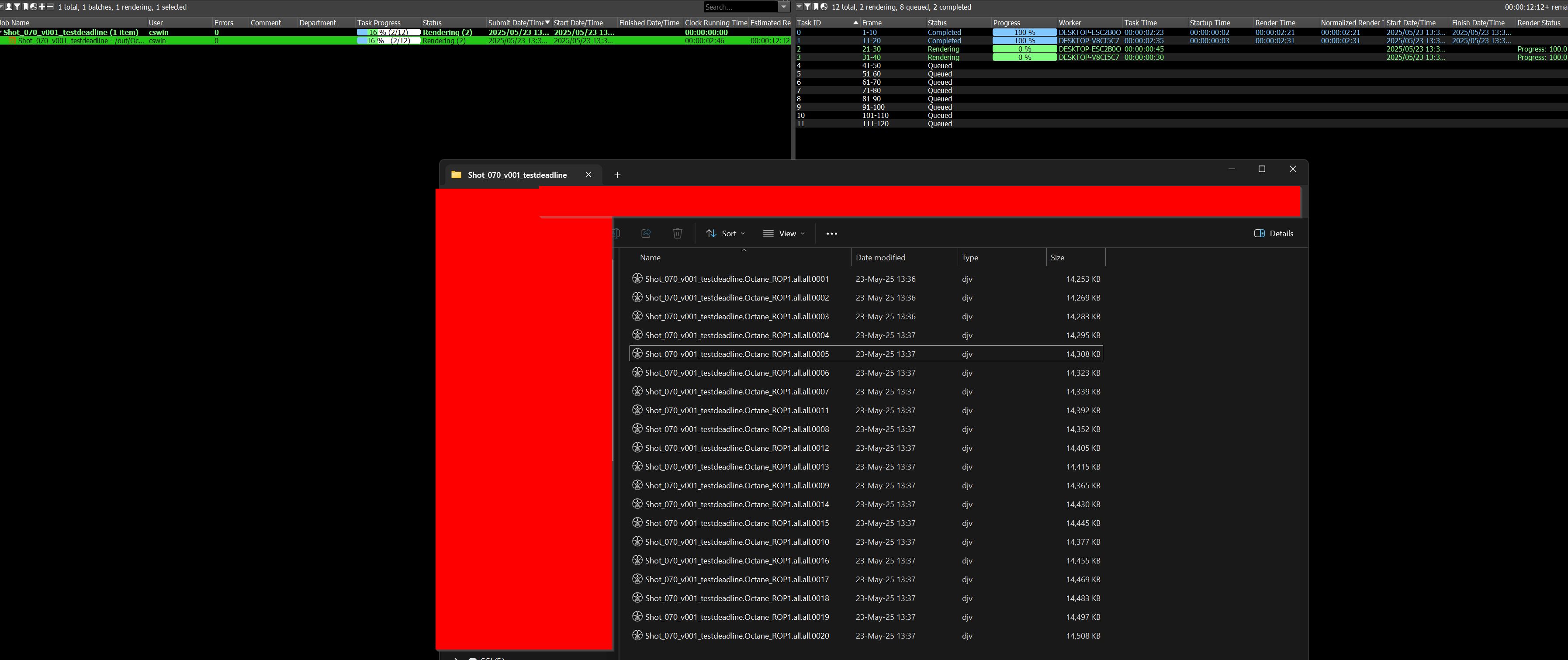

seesharpstudio
Posts: 17
Joined: Mon Jan 16, 2023 2:48 pm
What is not working regarding Octane and Deadline?
Here is working fine with 2 workstations.
Best,
Cosmin
marcikola
Posts: 29
Joined: Sun Aug 18, 2024 10:01 pm
Hey! Which version are you using? The latest octane?
