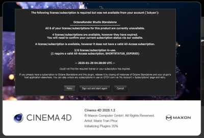

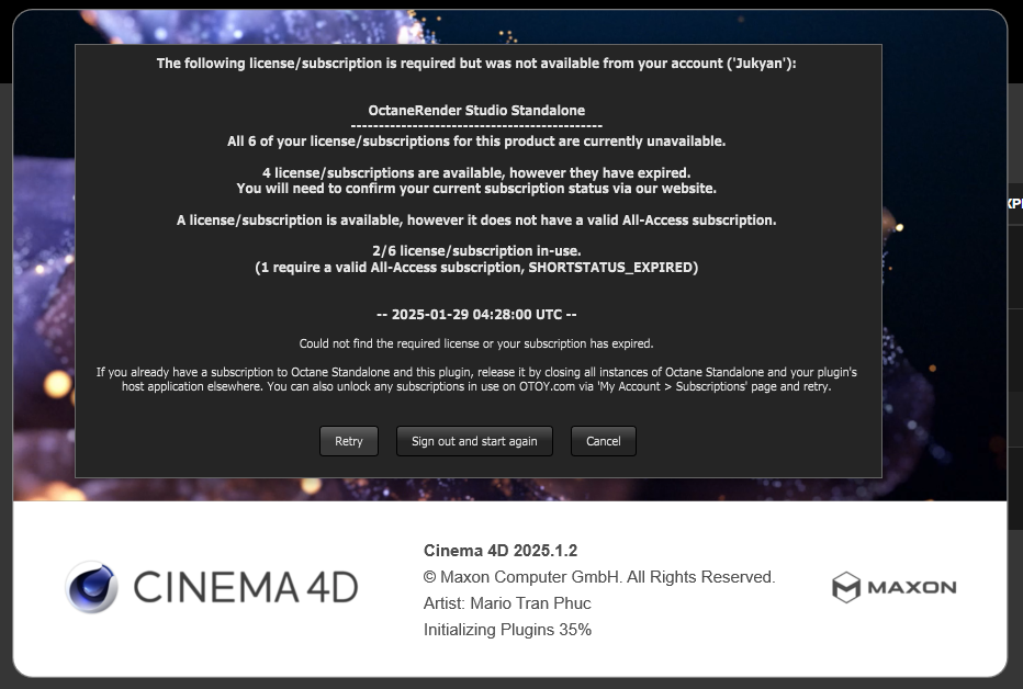

Hi there,
I do large scale Octane renderings for video mapping shows,
I have a studio C4D & Octane+plugin license, both clearly saying you can use team render & a couple node renders. C4D team render works well already.
But when I launch the C4D render client on my second computer, it gives me a cryptic message about licenses telling me it won't work.
(see picture attached)

Posts: 10646
this is expected, with Maxon Team Render, you need a full Studio+ license for each node of the network.
On the other side, if you want to use other machines for speeding up the rendering, you can use the Octane Network Render feature for adding the GPUs of the machines in your LAN to the Primary Workstation via Ethernet in both Live View / IPR, and Picture Viewer/Render Queue final render, with animated and static scenes. So you can use its power in every phase of the scene preparation, speeding up a lot the workflow.
The secondary machine will run the Render-Node in daemon mode, while your first machine with Studio+ license will be the Workstation, and you can add or remove the Render-Nodes (10x) from the rendering on the fly. Max 200x GPUs internal and external, depending on the network interface speed.
We suggest a minimum of 1Gbit Ethernet connection between Workstation and Render-Nodes, but better to have 10Gbit, with complex/huge scenes.

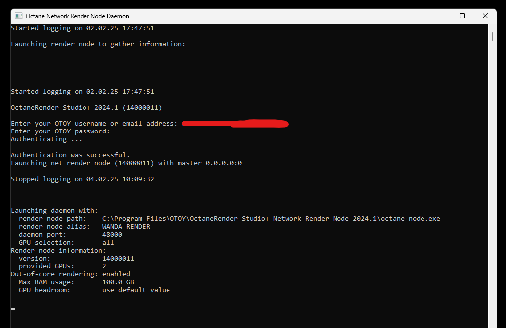

Now there are errors when installing the daemon on my render nodes. I'll try again soon.

The main thing to be aware of is that the Render Studio version on the workstation and the Network Render Node versions have to match, but the host 3D app plugin may have additional updates and versioning. For instance, both your Render Studio and your Network Render Nodes might be something like version 2024.1.2 and your C4D plugin might be 2024.1.2_R2. That's fine. The "R2" suffix on the plugin is for host app specific version tracking and doesn't impact compatibility for network rendering. If the render node does not match the installed Octane workstation version, you usually get an "incompatible" warning for that node in the Octane Network Render Settings window, and sometimes if it's way off, the render node just won't show up at all.
Also be aware that Network Rendering has separate settings for the Live Viewer for look dev and for the Picture Viewer for full batch rendering. Live viewer settings are under the Live Viewer Window menus>Options>Network Rendering>Settings. Picture Viewer settings are under C4D Render Settings>Renderer: Octane Render>Main>Network Render>Network Preferences.
It can get messy if you are in the middle of a transition between one version pipeline and another. If possible, I like to remove all previous Octane Render Node versions from their host machines to prevent confusion. Sometimes it is necessary to have multiple versions installed, however, and depending on startup items, security permissions, etc. you may have to manually check each node after a restart to make sure the correct node version is active.
