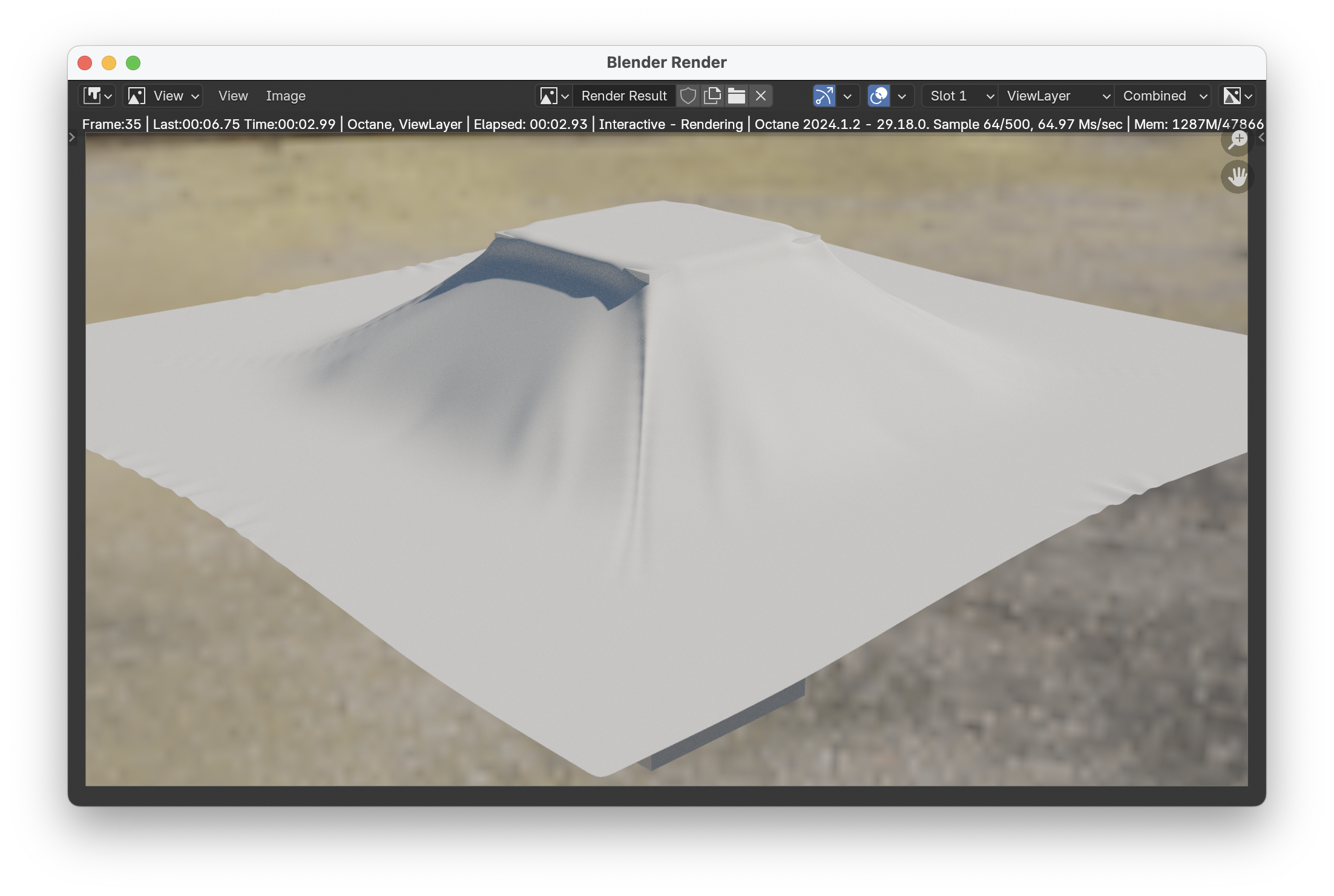

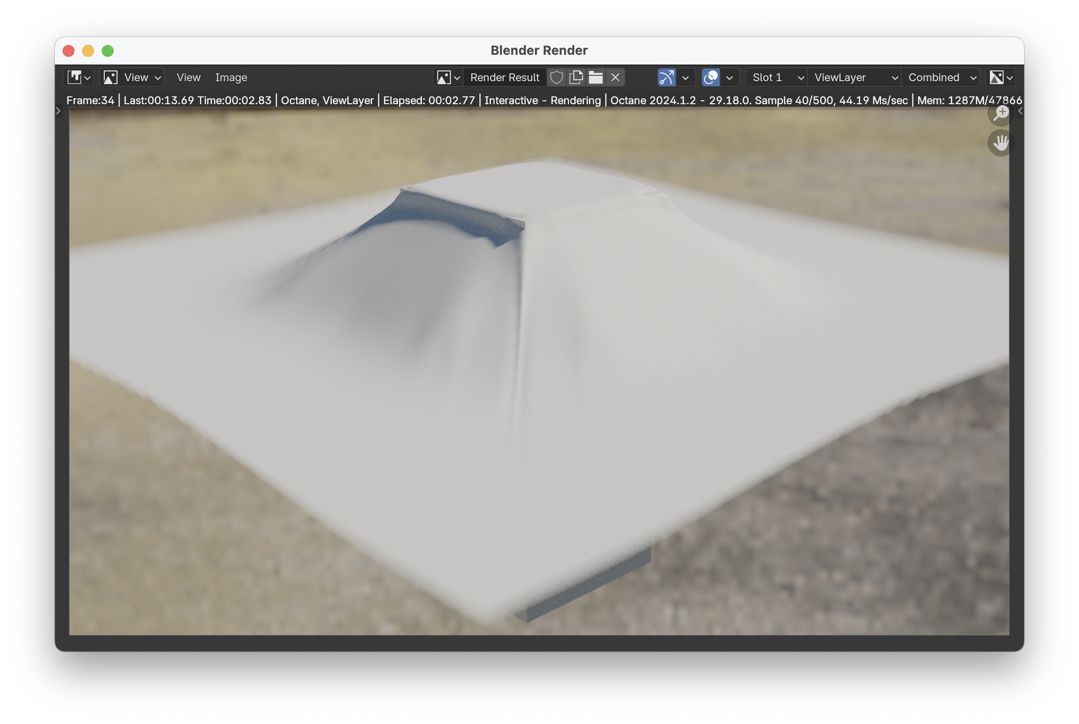

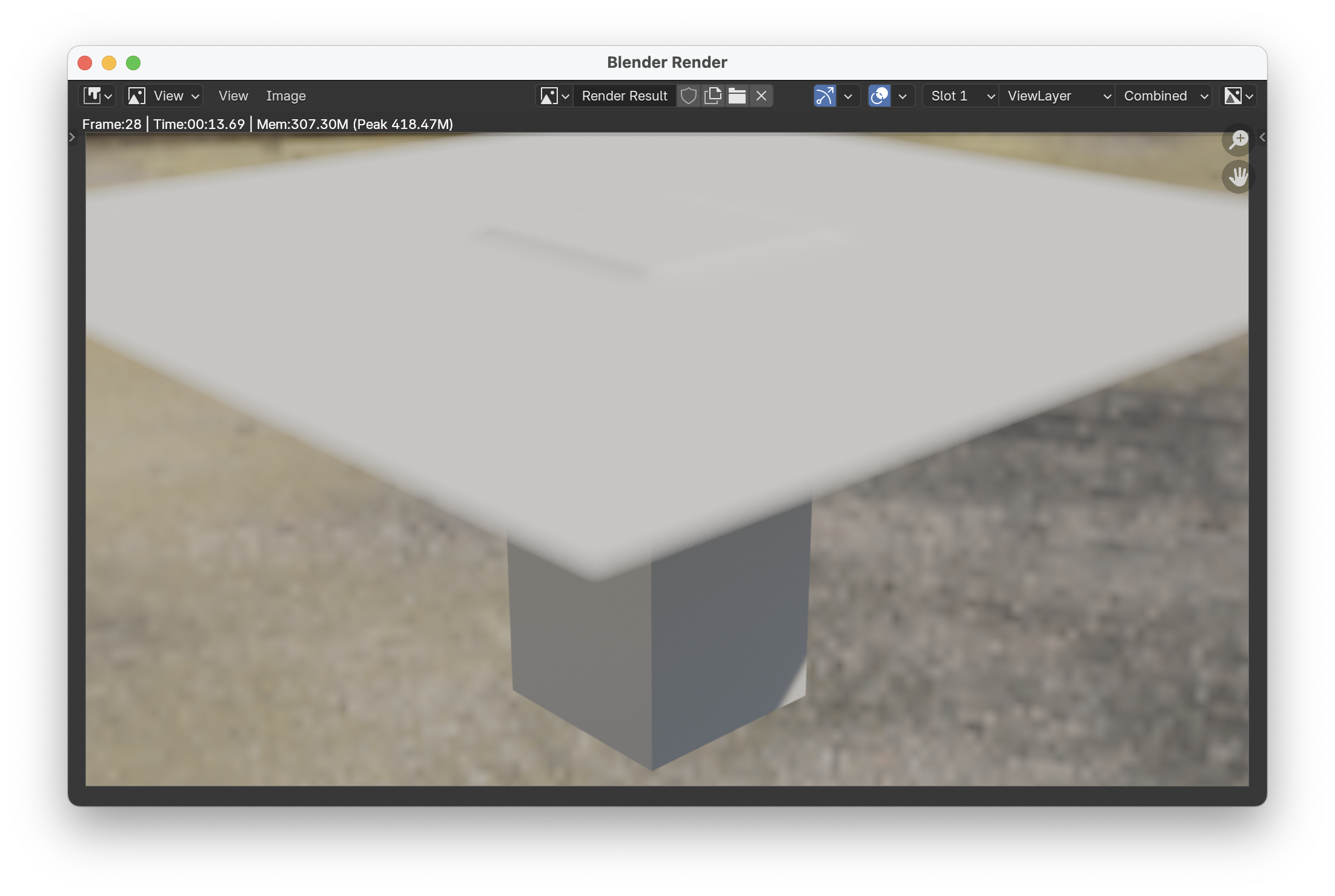

Can't get motion blur on cloth sims even if I export them to alembic and import back to Blender.
What am I doing wrong?
Both checkboxes are checked. I've tried Deformation checkbox, object type - Reshapable proxy
UPD. That alembic and simulation itself has strange behavior. Motion blur works till frame 35
I have scene where I made flying sheets of paper with cloth sim. They fly fast and have no motion blur =(

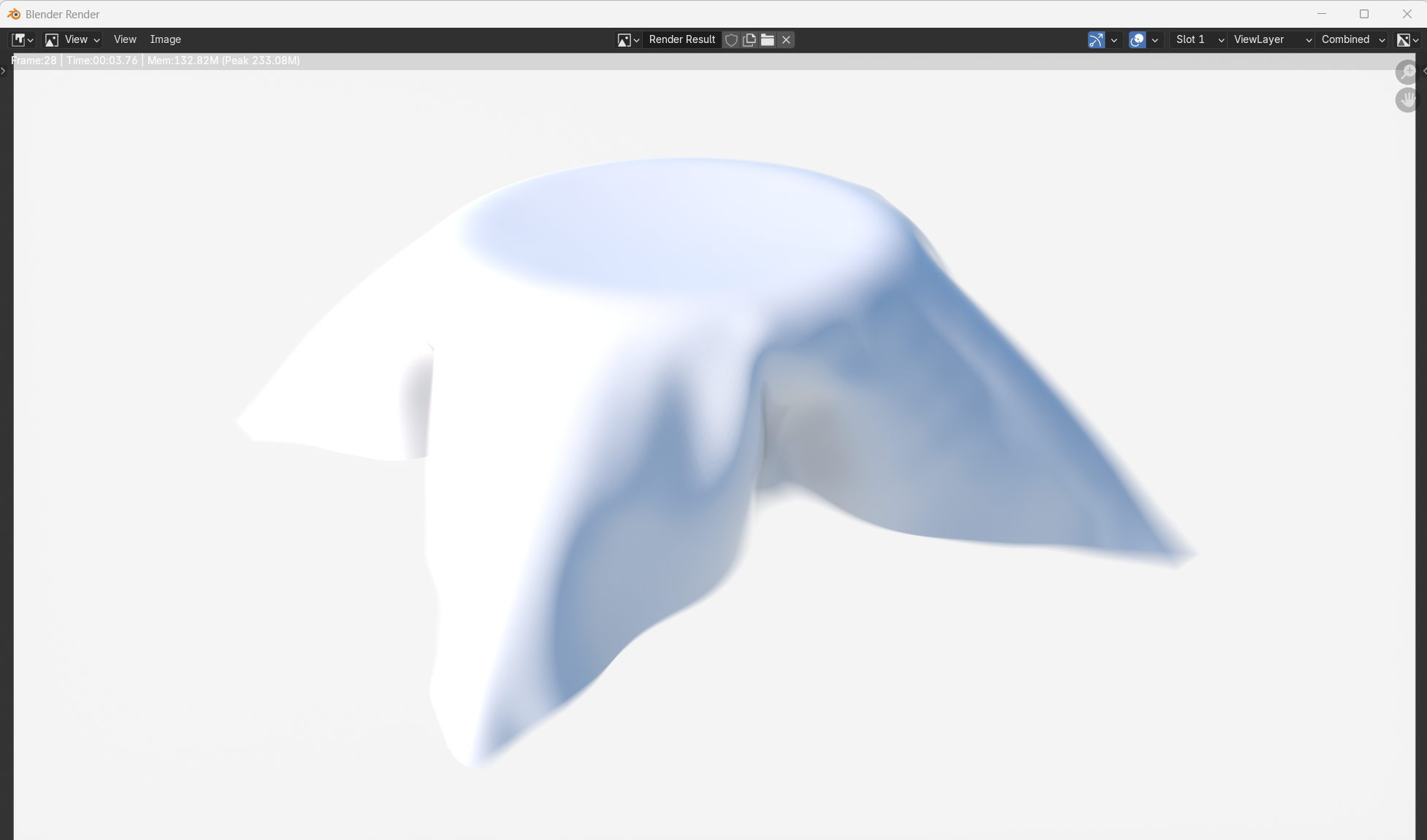

Works fine here:
To make your scene work, you should get rid of the Smooth By Angle modifier.
