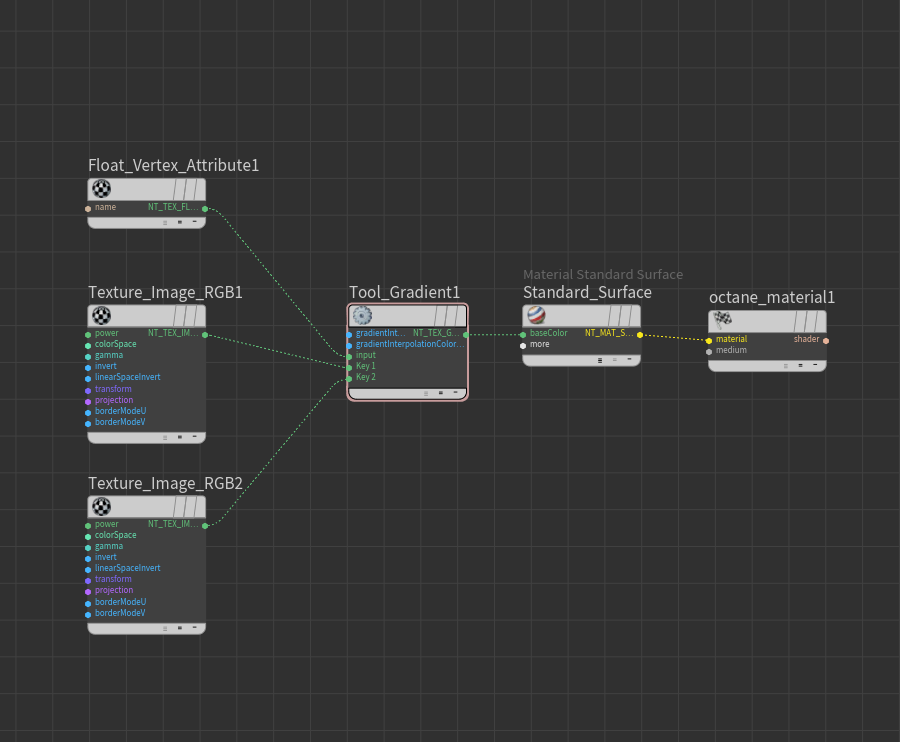

Just plug the textures into a gradient node like this:
Float to int expects float values as input but Float Vertex Attribute outputs Color values. That's why it's not working

galleon27 wrote:Just plug the textures into a gradient node like this:
Thanks but yeah in that case I usually use the "tool mix texture" but in my current case it's a texture set and five groups, so I need to switch between 5 textures multiple times, so that workflow is quite impractical.

Hey, thanks for your response. What I'm trying to do should actually look like that:
But then with multiples of these texture switch constructs.
The red arrow is where I actually have a connection in Houdini, seems like this is what's not working. Probably like galleon27 said but there is no conversion node from vector to floats, or is there?
Then just plug in more textures in gradient node.

Oh, I didn't understand you meant this could be used for more than two textures - that works, thanks! :)
chocbot
Posts: 73
Joined: Sun Apr 17, 2016 3:03 pm
So I have a solution!
Though, I'd still be interested about the texture switch node's workflow? Is it not supposed to be used with attributes to control it? What's the use case then?
