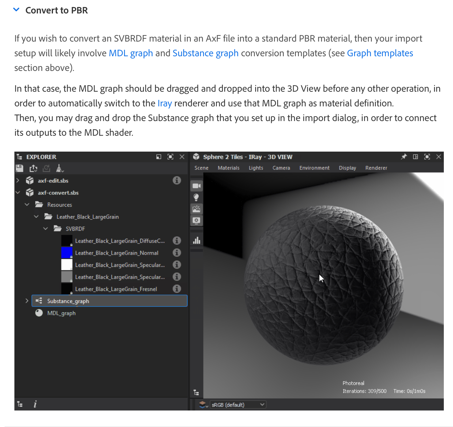

But it seems that you can convert them to standard PBR materials using Substance 3D:
https://helpx.adobe.com/substance-3d-de ... ormat.html
