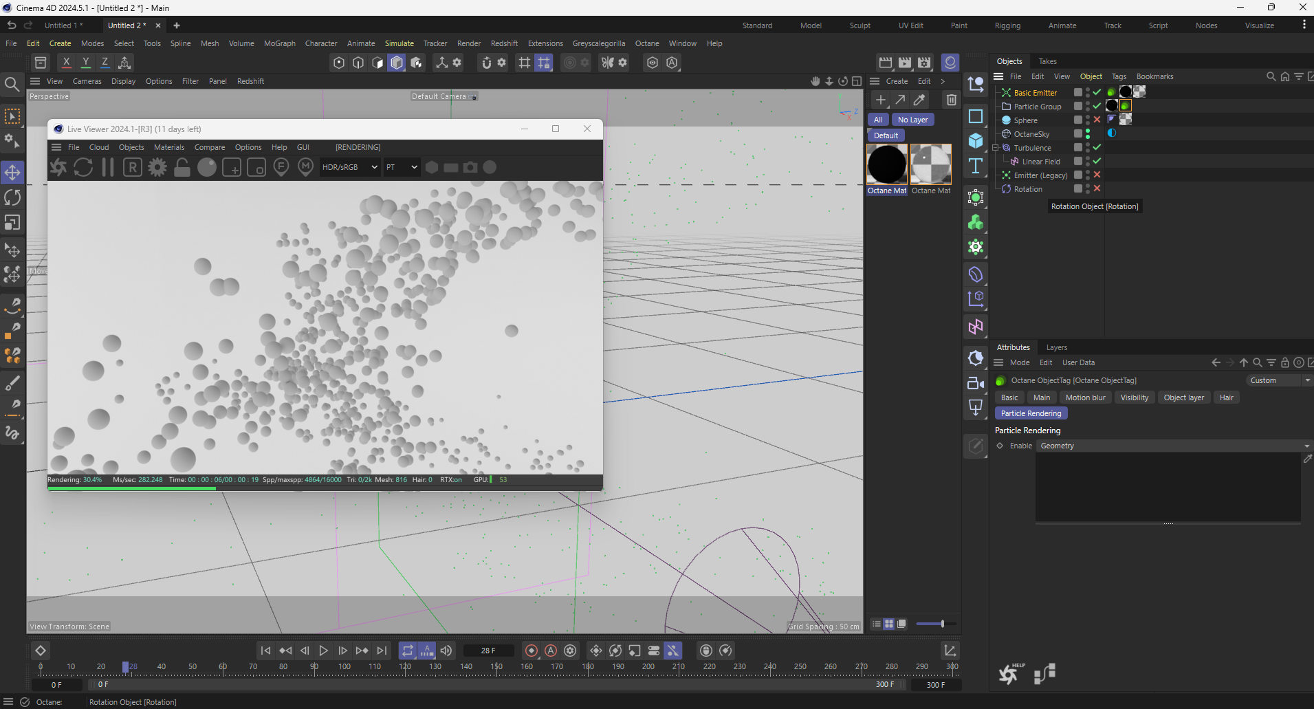

Hey there! Recently came across this problem. I can't seem to see the material that ive applied in the live viewer. Any idea? Thanks!

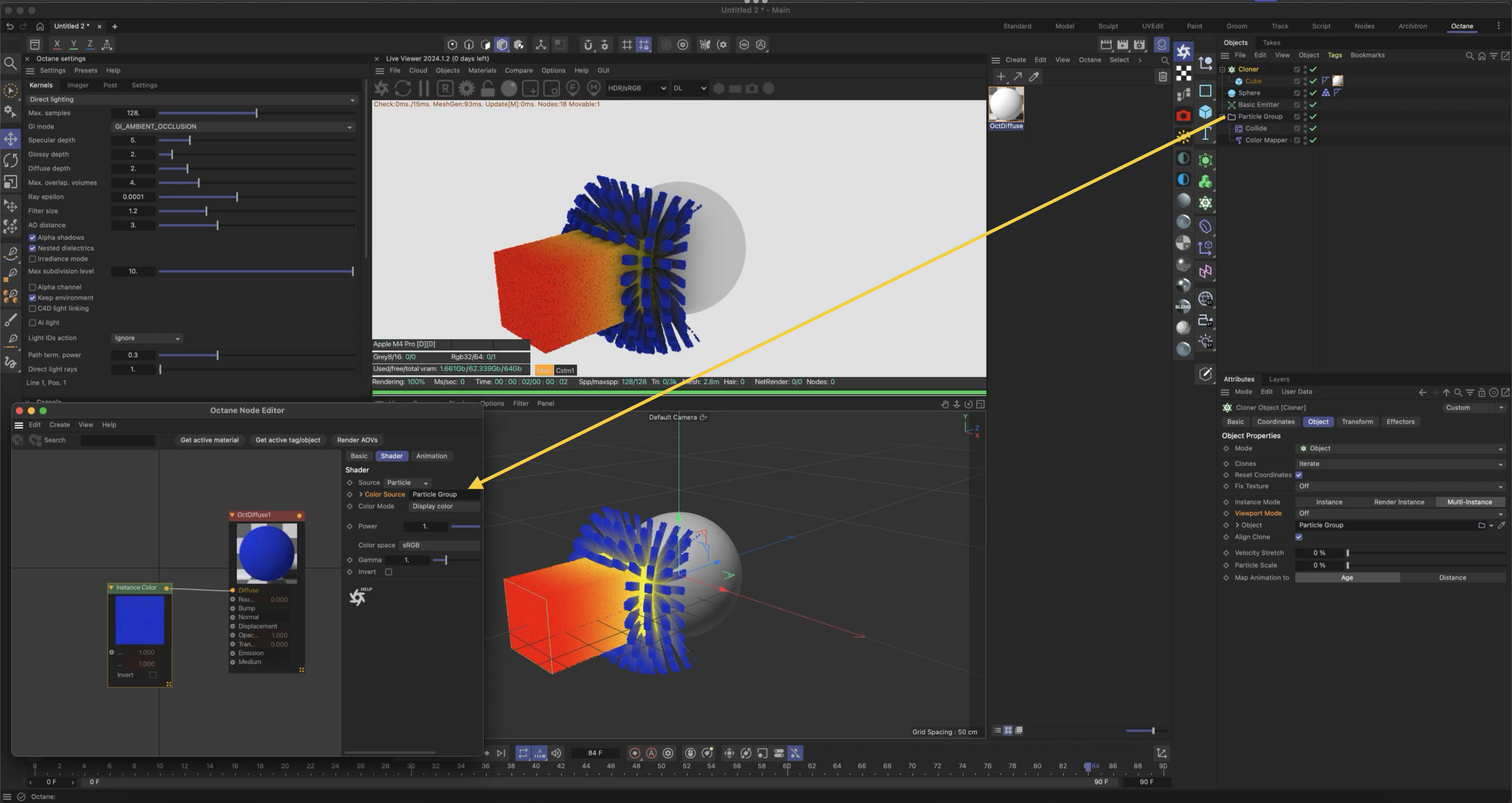

did you have a look at the video?
If you use MoGraph Cloner in Multi Instance mode and with Viewport mode set to Off, only the particles are displayed in viewport.
And for material, you need to use the Instance Color node to get the color of the particles directly from the Particles Group:
ciao,
