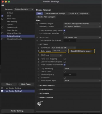

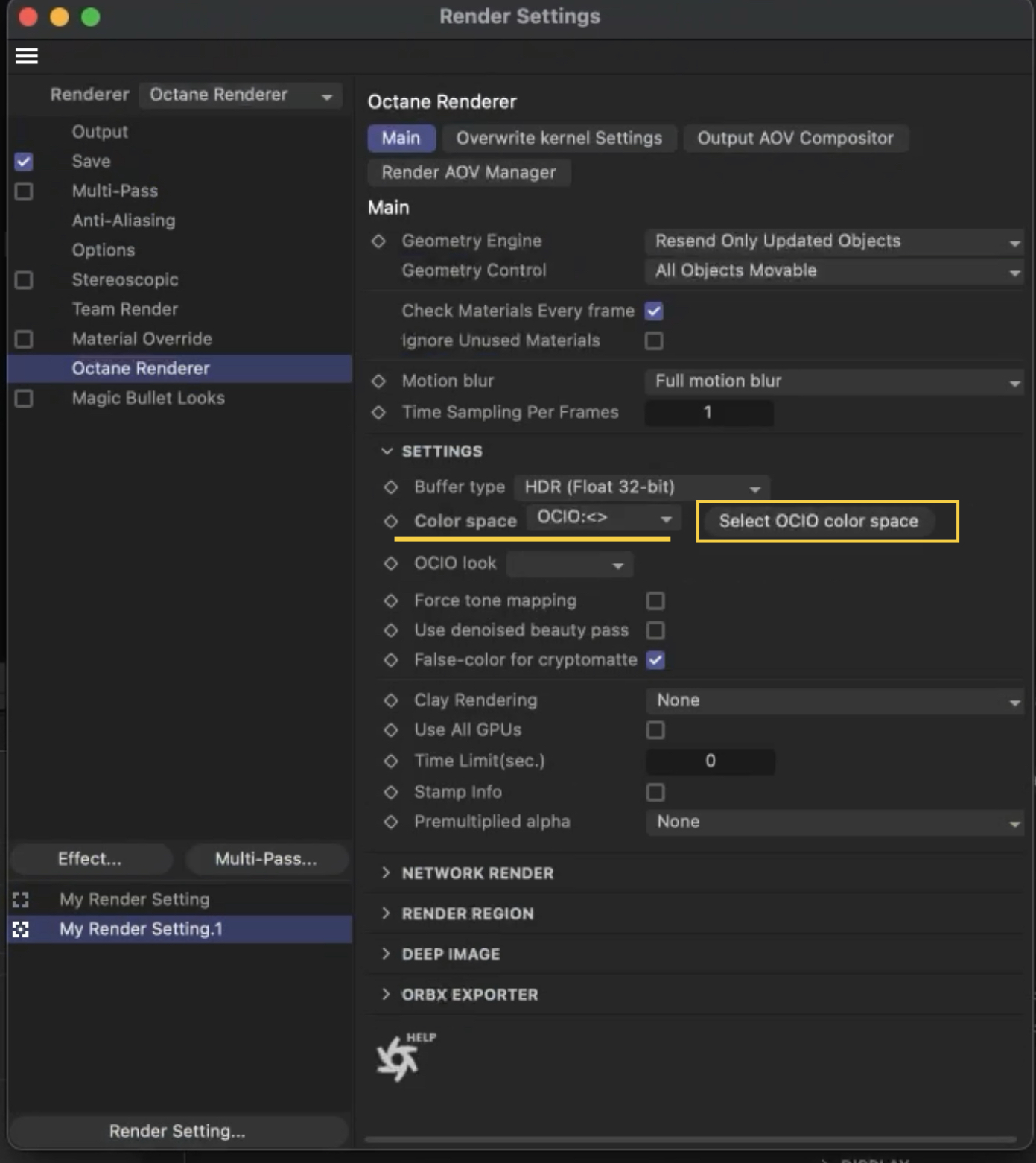

in general, "Failed to build OCIO output transform for imager: No OCIO config loaded" error happens if you set the Color Space popup to OCIO, but you don't click on "Select OCIO color space" button on the right to assign a specific OCIO color space, in Render Settings/OctaneRender/Main tab:
