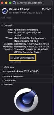

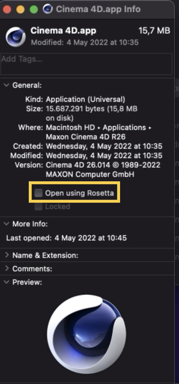

you don't need the Demo version for macOS Apple Silicon, since you can install the full free Prime version for C4D 2025:
https://render.otoy.com/plugindownloads ... 01_OSX.zip
But please, you MUST disable the "Open with Rosetta" option, or plugin cannot be loaded, since it is native for Apple Silicon.

if under Mac, please make sure to have disabled the "Open using Rosetta" option in the Info panel of the Cinema 4D.ap.
