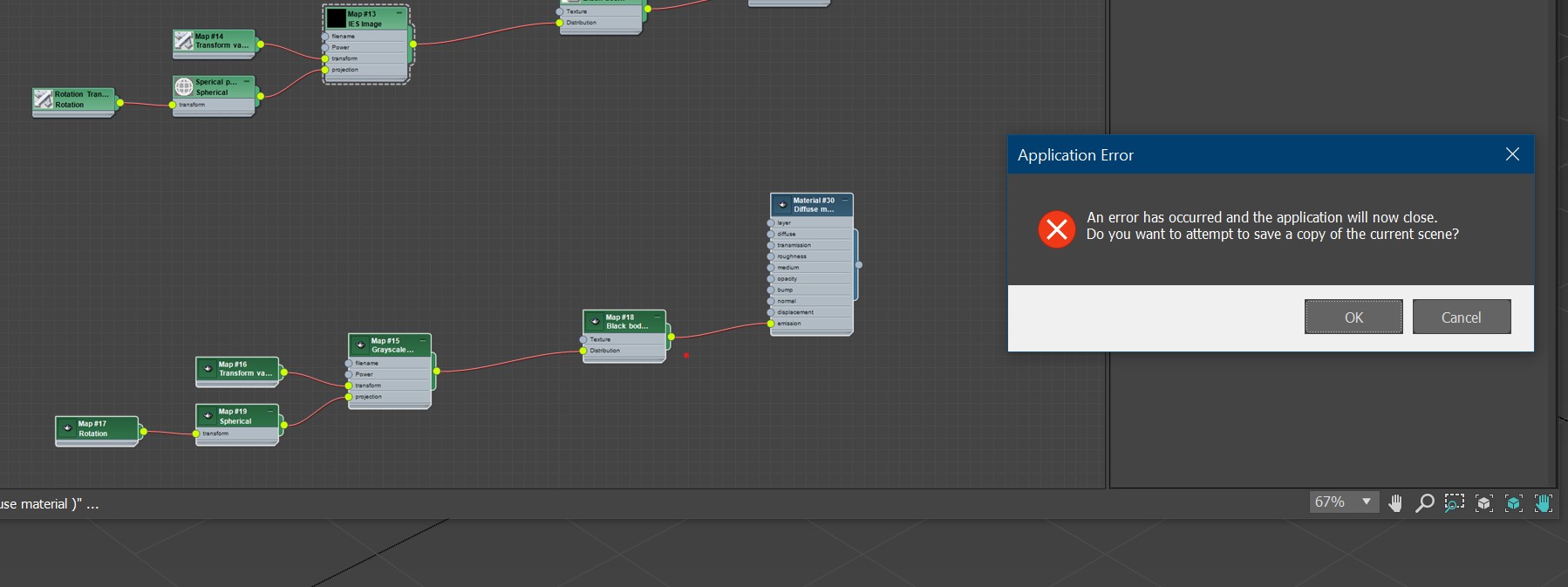

THERE IS A BIG BIG issue with the latest versiones (08 included)
i CANT copy blackbody emission materials that have IES attached to them. it crashes instantely. this is a VERY BASIC workflow for me.
any idea? latest nvidia driver. happened with and older Nvidia drivers also. max 2018
Max Crashes when copying BlackBodyem mat with IES

Hi MartinBoom,MartinBoom wrote:THERE IS A BIG BIG issue with the latest versiones (08 included)
Thanks for reporting this issue.
Sorry about that !
This should be fixed now in the latest release (15.12)
