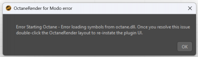

Hello, I recently moved from Win10 to Win11 with a fresh install, and now on modo launch I get this error:
I reinstalled the plugin but the error persists.
Any suggestion?

Hi - disable the PRIME version of the plugin.
Paul

I have only installed the Studio+ subscription version... I don't know nothing about PRIME version: is there a documentation about that, so I can learn how to disable it?

Which version of Modo are you running please? And which version (ie. release number) of the Octane plugin have you installed?

The last of both: modo 17.0v8 (with the eol license now) and OctaneRender_for_Modo17_2024_1_0_201_STUDIO
But actually in the log says OctaneRender Prime 2023.1.2 (13000200), that -fun fact- I never installed after the complete OS reset... lol!
Ok, uninstalled 2024.1, today I discover that modo comes with a build-in Prime version of Octane... I wasn't aware of that. Disabled the kit, reinstalled 2024.1, and now everything works perfectly.
Thanks!

Well, with 17.1v1 the error description is now different and specifically talks about disabling the Prime or Studio+ version of Octane kit... much clearer than before.
