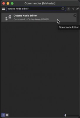

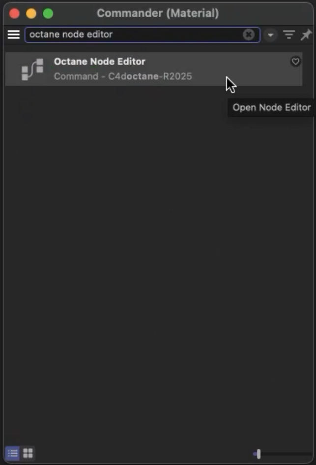

you could personalize your C4D Layout by adding the Octane Node Editor command, so you just need a click on it to show the selected material in Octane Node Editor :
ciao,
Beppe

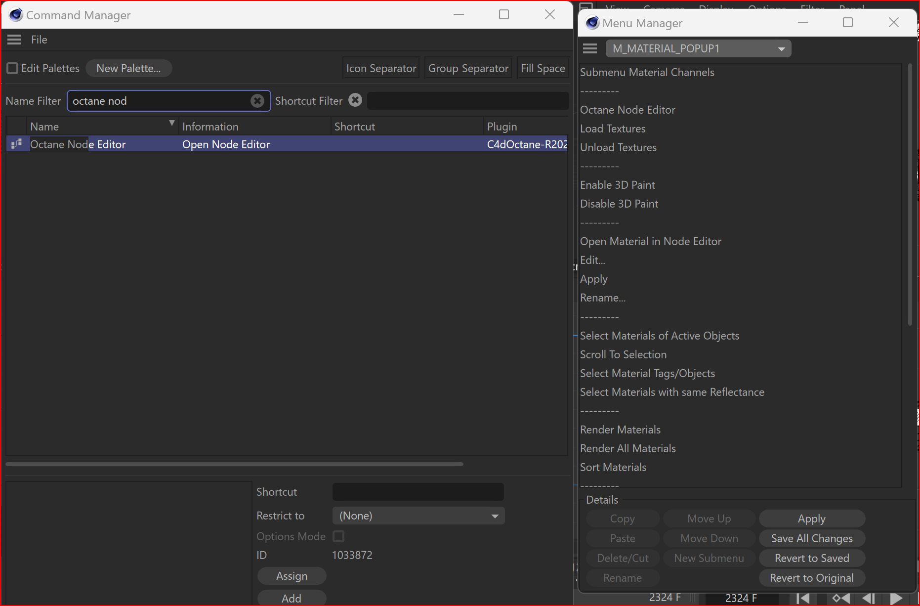

I like having the Octane Node Editor at the top of the contextual menu when right-clicking on a material in the Material Manager. In the Menu Manager it's called M_MATERIAL_POPUP1. This makes for quick access to the Octane Node Editor for the specific material clicked on.
Contextual Menu Octane Node Editor

Oh I didn't realize you could edit the right-click contextual menus in that way. That's a pretty good workaround, thank you!
