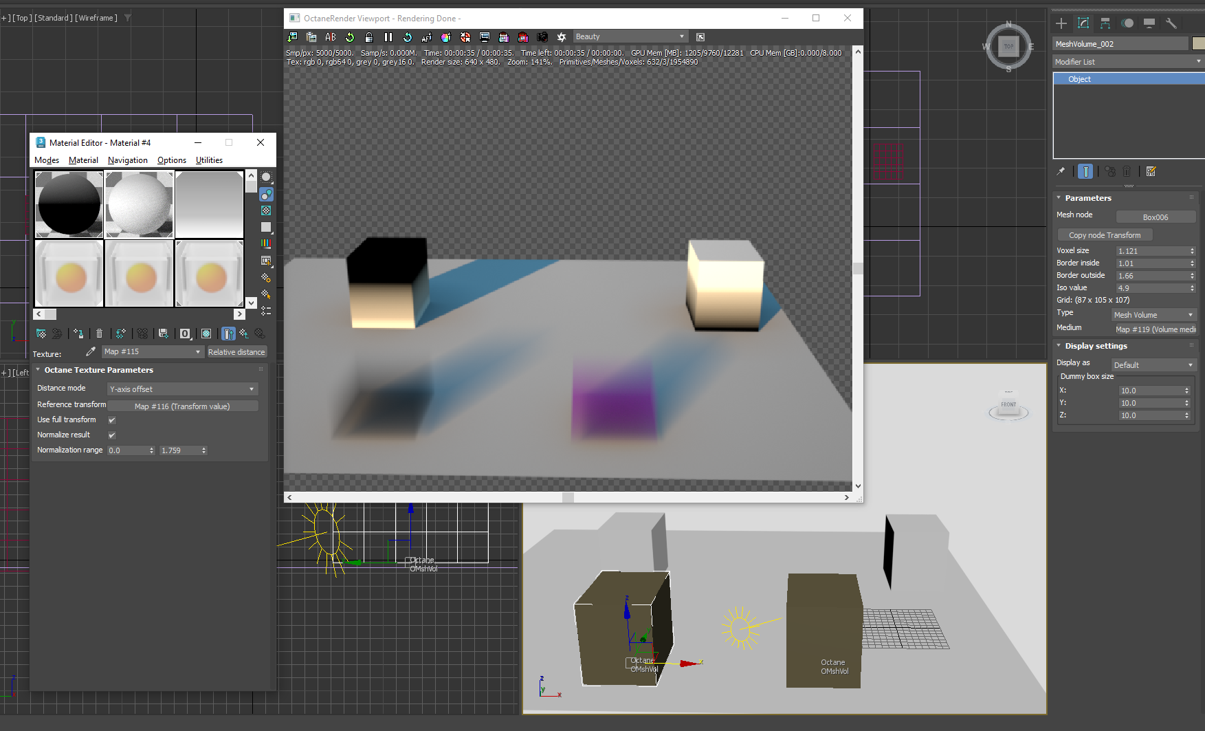

Hi tombyrom,
There are several maps that could do this.
What about the distance texture ?
You can specify the axis, a scale with the normalization range, and the bottom Z value with the reference transform
(note that Octane 'y-axis offset' is for the 3dsMax Z axis)
Connect it to a Gradient texture for more control, optionally invert it depending on the usage and you get some values from 0(1) to 1(0) from bottom to top
Here the Left cube uses this in the Absorption of a Volume medium, the right cube uses it in the Transparency weight of a Std Volume medium..

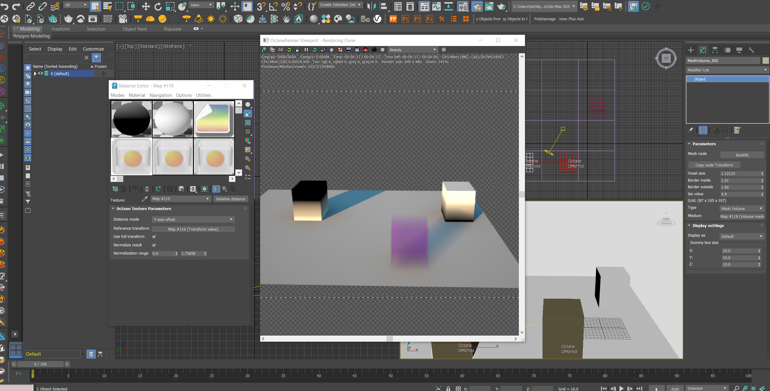

Hi neonZorglub,
Thanks for providing a file, when I open it and hit render it looks nothing like your screenshot?
The left hand one does not show anything and the right hand one has no fall off on the medium?
Why would this be the case?

Don't worry I think I've got it working the file provided had the textures plugged into the wrong slots on the mediums, I can get it looking like your screenshot now.
Thanks for this it should help me

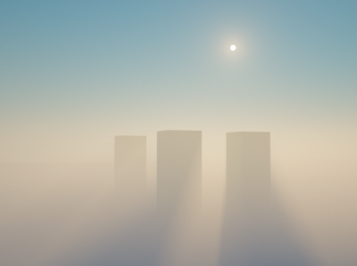

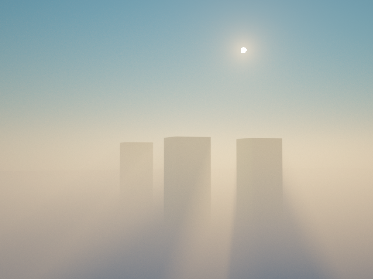

No worries, the relative distance map in the transparency weight and then using the transparency depth to tune the falloff works perfectly for what I will need in the future. I used quite high numbers for the depth but it's prob scale dependant.
Also to get this working even nicer set the scatter anistropy on the Std Volume Medium to something like 0.5/0.6 and then you have perfect fog which blends with it's environment, the attached image using path tracing.
