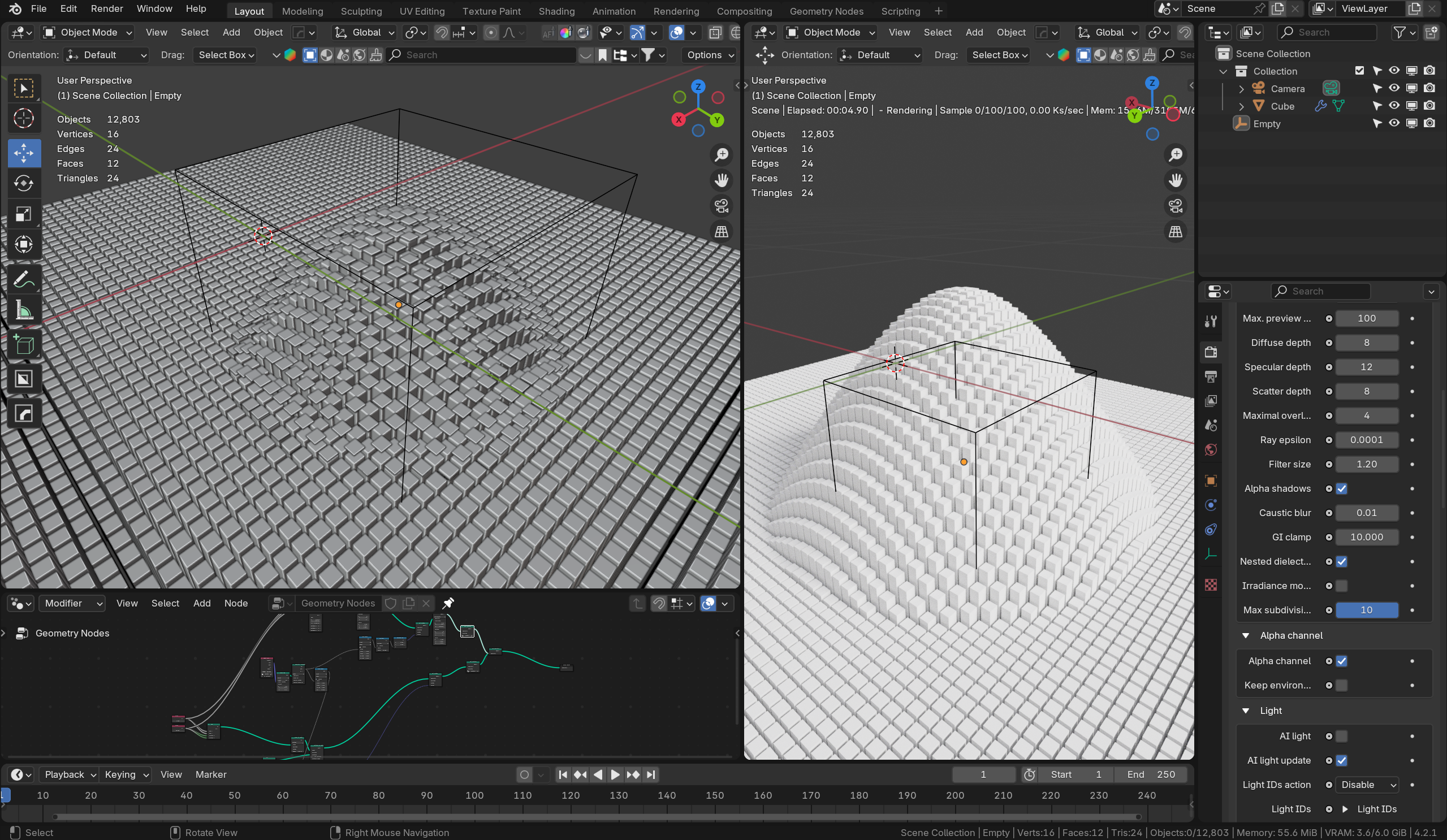

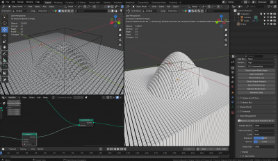

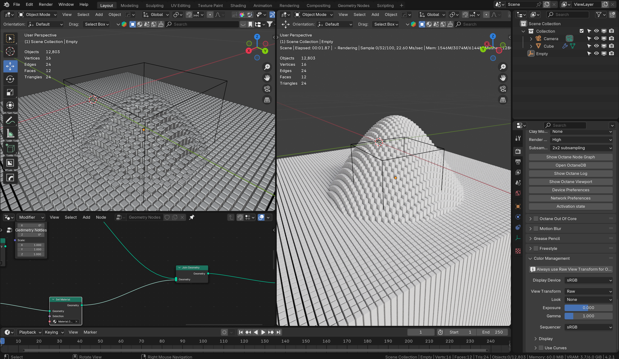

In Octane Blender 29.15, when using the Join Geometry node in Geometry Nodes to scatter and combine different objects, the result looks normal in the viewport but appears different in the Octane render view
