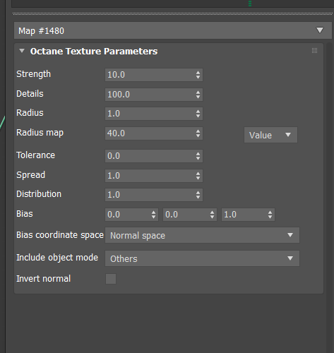

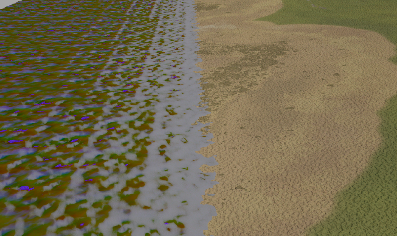

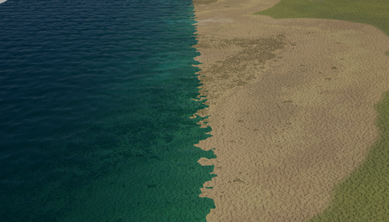

Basically I don't want displacement or very little near where water meets the edge. Using a dirt texture to mask where the water intersects with another object and a 128 grey value to for no displacement.
Mix texture
Amount = Dirt texture
First slot = 128 grey (no height)
Second slot = Displacement texture

Personally, I think this is a bug, because this is vertex displacement and not texture displacement, vertex is not bound by the same restrictions as texture displacement, think chaos texture or tri-planar for example. When I put the same mix node used for displacement into the albedo (image above) you can see it is correct, grey is where it should be on the texture, so to me it makes no sense why this would not work in the vertex displacement node in my opinion
