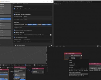

The "OCIO look" node in Octane compositor has no options although the OCIO config is loaded in addon preferences and the OCIO looks showup in Imager settings.

It works fine here in OctaneBlender 29.15 (to be released soon).
It also works fine in the current version here.
I'm using PixelManager package
https://github.com/Joegenco/PixelManager
In Standalone the "OCIO look" in compositor works as expected with it.

It works fine with that file as well here:
OCIO look is missing options, not OCIO color space.
