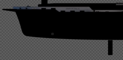

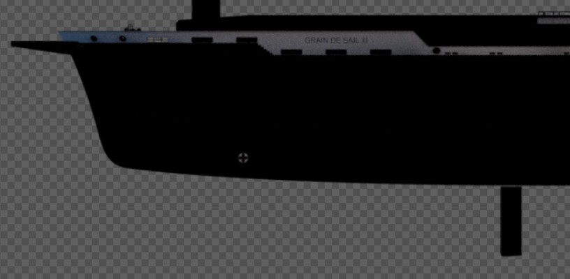

bump canal dont render iwith octane camera in ORTHO
KaDDD
Posts: 10
Joined: Wed Jun 26, 2013 6:33 pm
hi gays
is is in the title
when i m in octane camera with orthogonal view , all bumped surfaces look black :shock:
please check that , a value of 0.001 make shaders more darkest, i was in obligation to remove all bumps values for rendering my scene...thats not fun .... :|
paride4331
Posts: 3954
Hi KaDDD,
It's an SDK issue and will be fixed.
The current solution is to set the Material compatibility mode to 2022.1.
Regards
Paride
