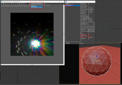

Hello there,
Here is a way to catch caustic in a pass ?
Thank you in advance !

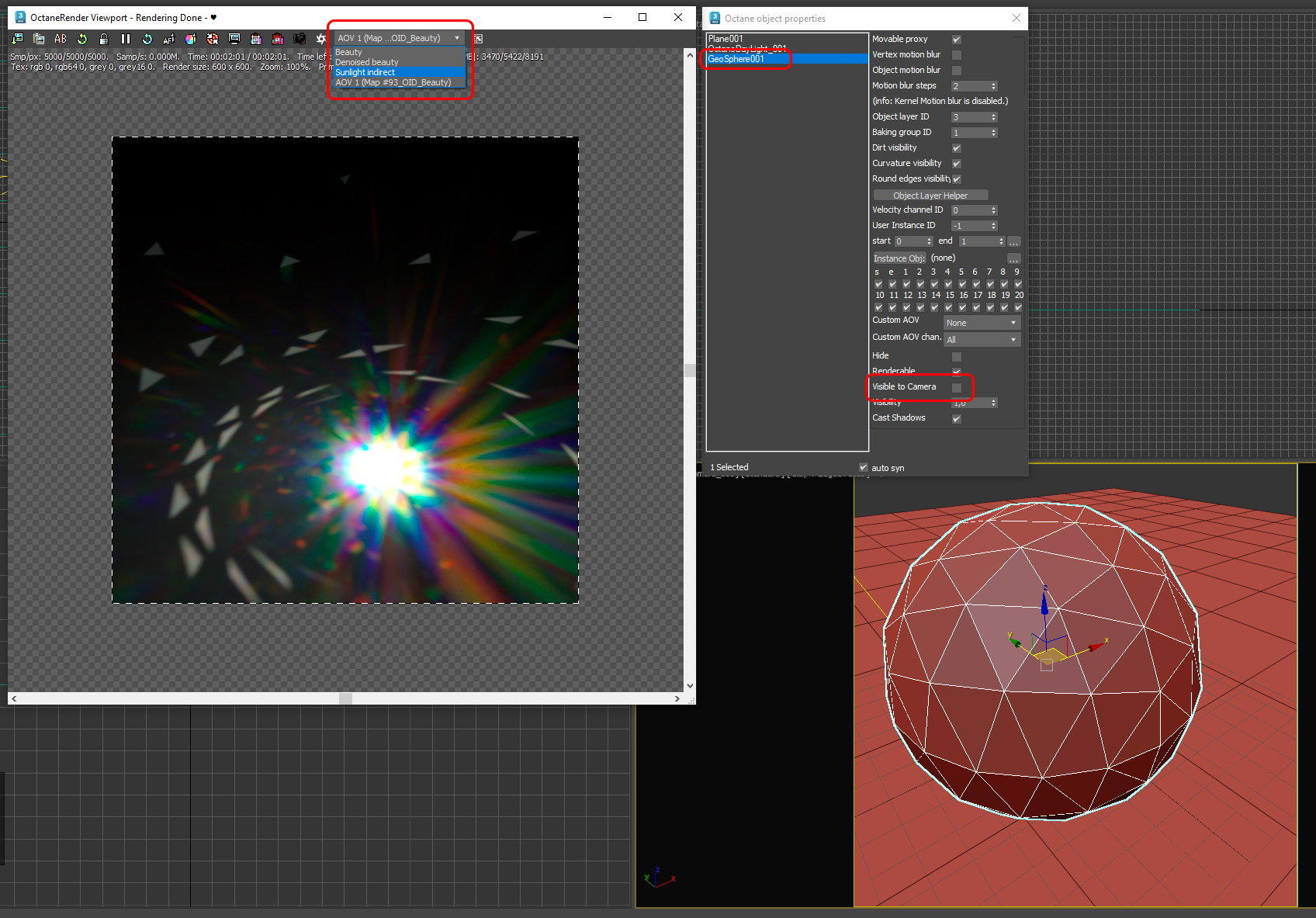

There isn't a multipass for caustics, but you can work around this by using an indirect light pass (for example, a sun in the case of the screenshot) and setting the objects to be invisible to the camera.

Thanks Paride, it's doing the trick ;)
