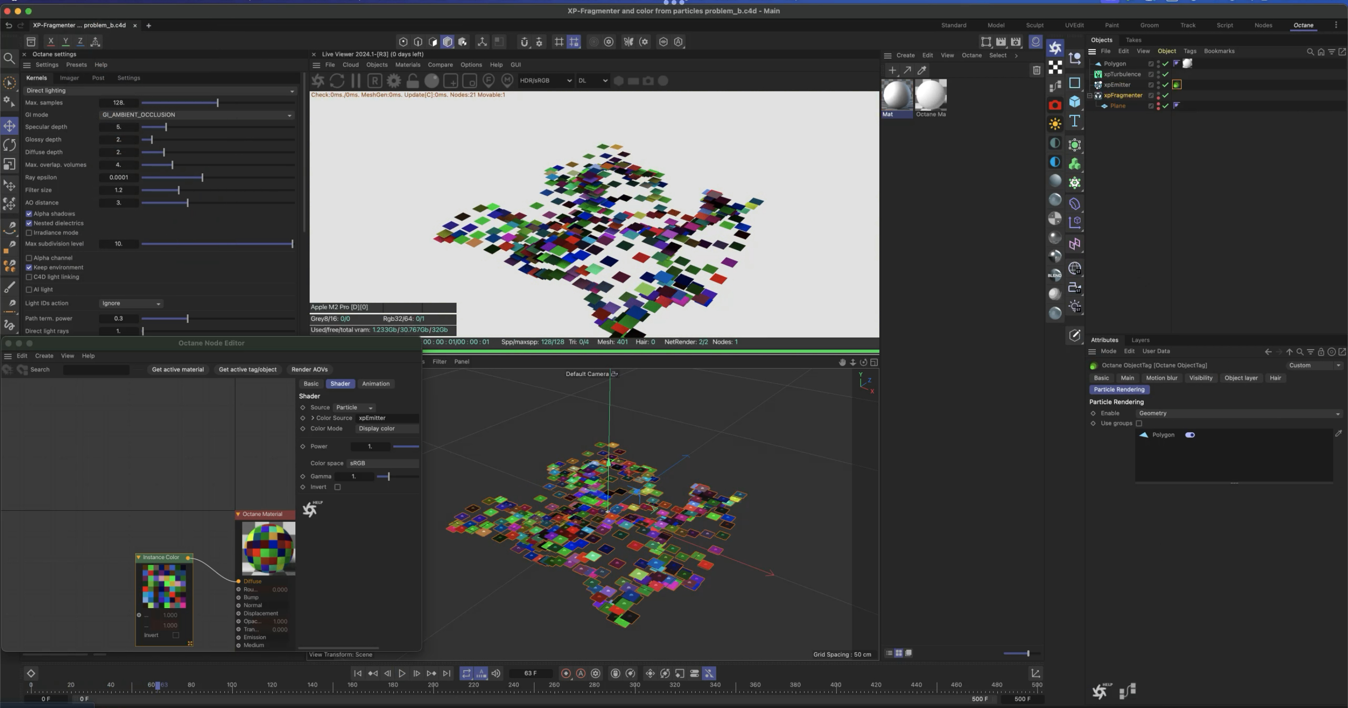

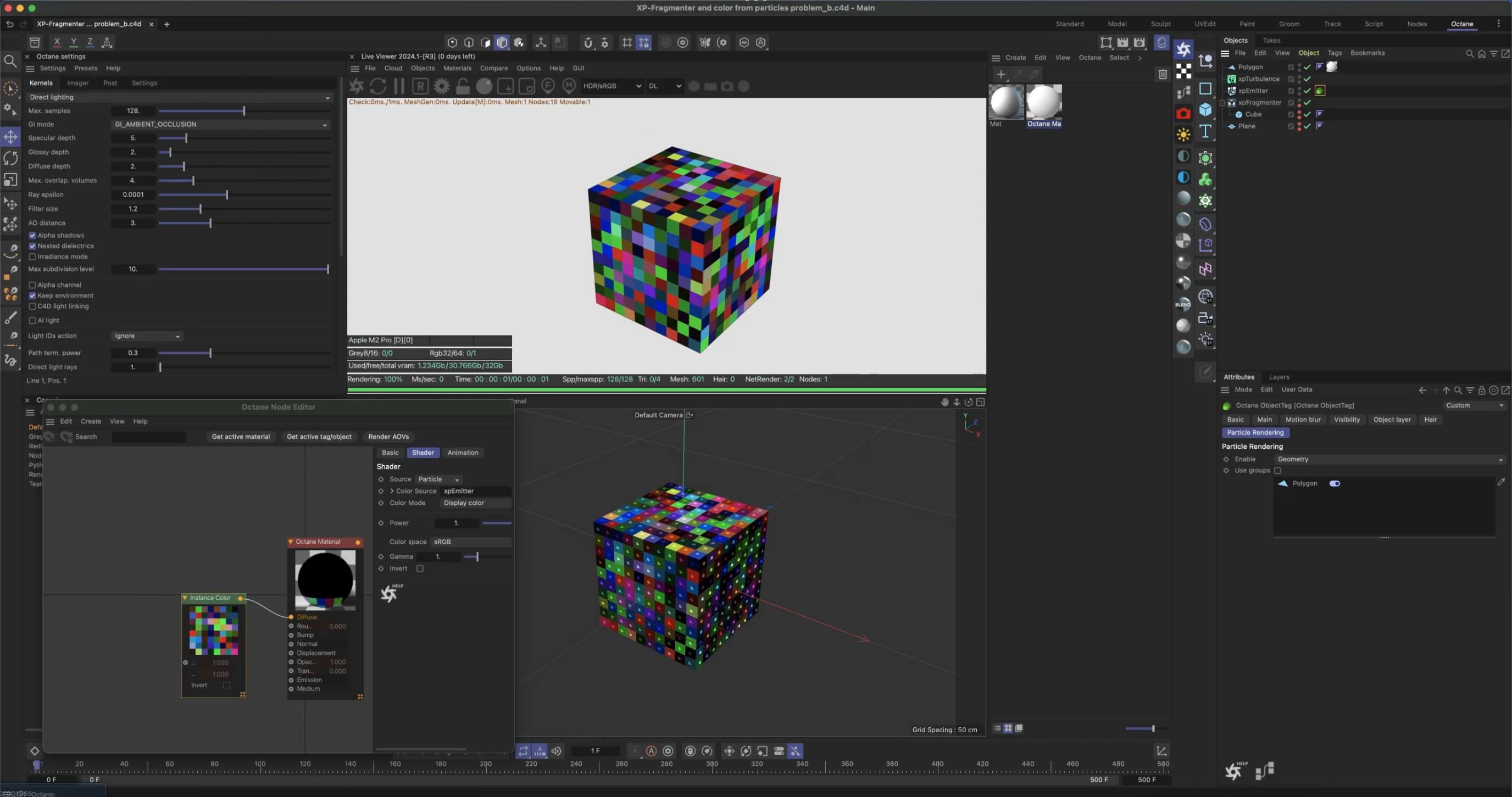

Hello, I have got a problem within this feature... I use X-Particles xpFragmenter with the option color from particles on but it does not work in Octane renderer... Please see the attached project example here: https://drive.google.com/drive/folders/ ... sp=sharing
I have sent a message to the Insydium Support and they replied to me that this feature is working in Redshift, Cycles 4D and Standard C4D Renderers... and that I should ask your devs what node should I use in this case to bring object display color into material (Like the Mg Color Shader does for example). Please, help me out :)

sorry, I'm not able to get the colors from xpFragmenter object, but, you can obtain the same effect by assigning a simple polygon to the emitter via Octane Object Tag of the same dimensions of the single polygon of the mesh to fragment, then assign an Octane material with Instance Color node that points to the xpEmitter to get the colors:
