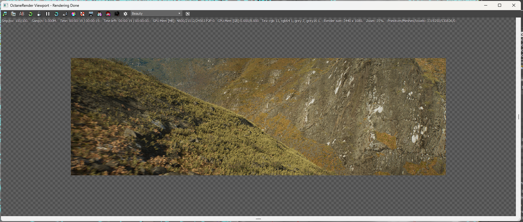

I do a lot of animated landscape scenes, but lately I am having issues with that 3dsmax/Octane crashes after rendering just like 25 frames or less.
I am using forest pack to scatter many objects in the scene, but even when I have a scene that is more simple, it still crashes.

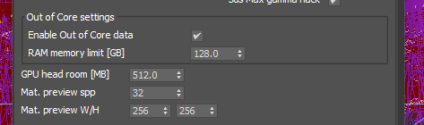

It sounds like a cumulative memory use issue to me. I'm not a Max user, but you should be able to see the Octane Logs from your Octane Preferences. If so, it should be pretty clear in the log. You can also look at Octane Settings>Devices>Octane Device Settings to see how much memory is being consumed and by what. You might need to enable Out of Core Data, which will slow things down a bit, but might get you all the way through the render.

Thanks man,
I have 220 GB in my PC so i should have enough. The Out of core memory was only set to 8GB, is changed this to 128.
Ill try and render a test.

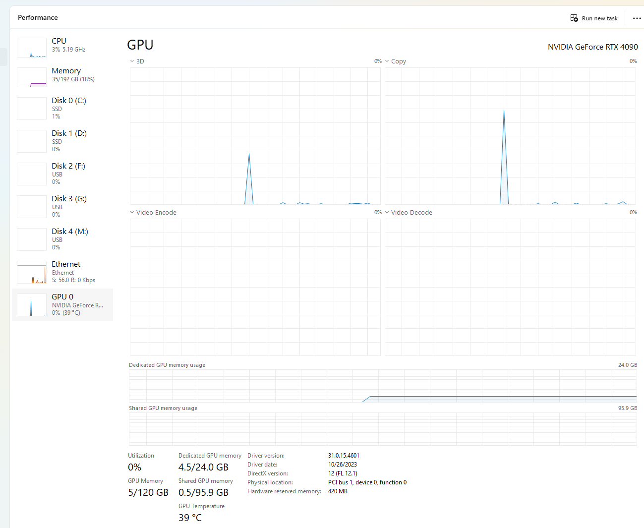

So, I found out something weird. When rendering these big scenes, I was playing a game meanwhile octane was rendering. While playing there where no crashes, so I just left the game going while rendering. And 3ds max and Octane did not crash.... And my scene got rendered out. It has worked for all the scenes I have rendered since then. Funny thing though, when the game decided to crash, max and octane also crashed....

I think this makes sense. The GPU memory is being used by Octane, 3ds Max, and the game at the same time. If for some reason the VRAM gets saturated or something else, the game will crash, just like any other application that's using the memory at that moment. Personally, I wouldn't use video games while rendering.
