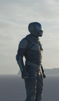

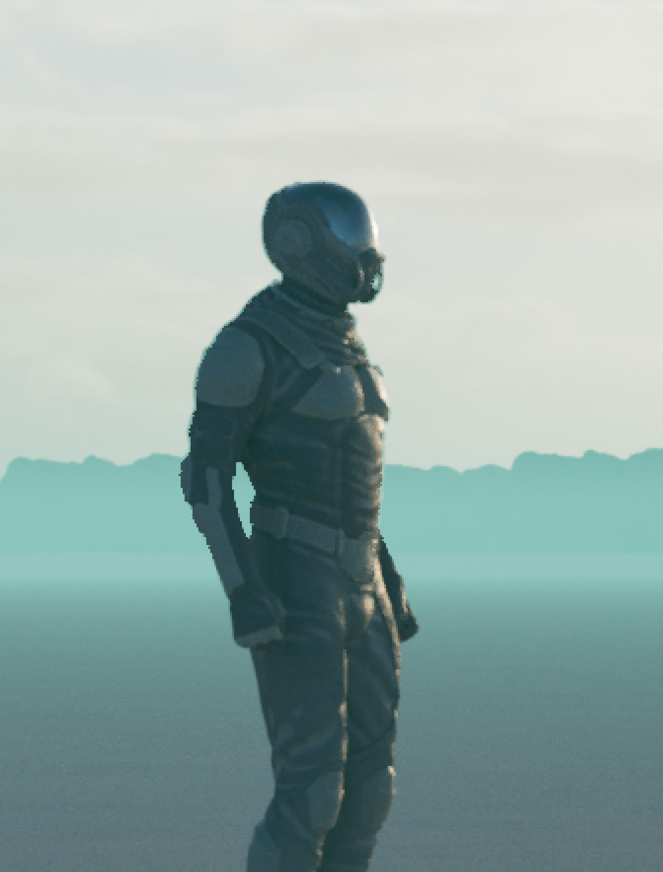

Hello,
I am trying to use the Post Volume Effect Fog as it gives the exact settings and look I need (distant/aerial fog) which I cannot achieve with any other fog method in Octane.
It's great but unfortunately, I am getting jagged edges around objects when the fog is on, I have checked all my settings I can't see anything that I can change to fix this? Is this something that can be mitigated? Or is it a limitation as it is a post-process effect?
See my example, the upper part of the model on the edges is jagged when this feature is turned on.

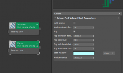

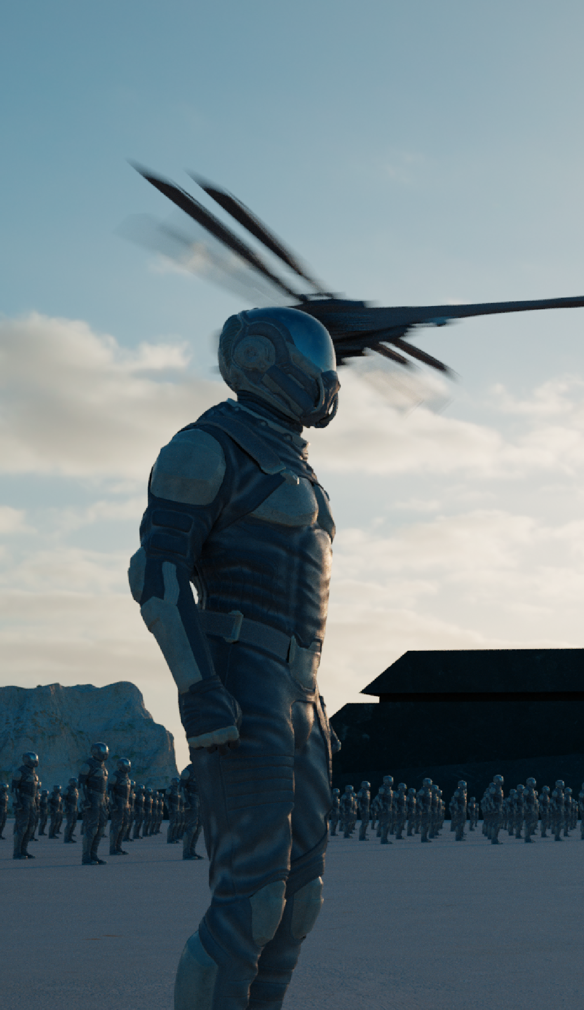

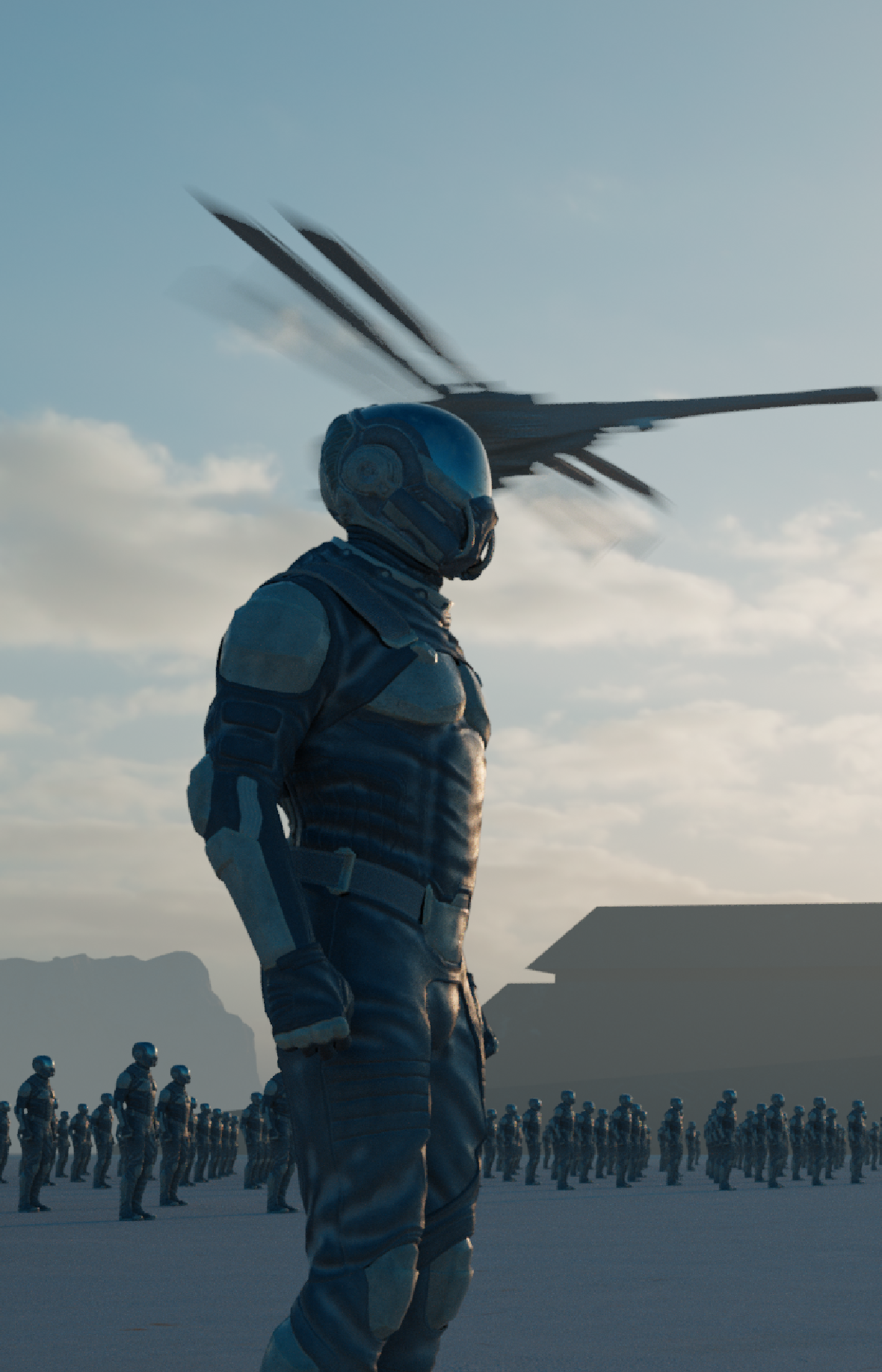

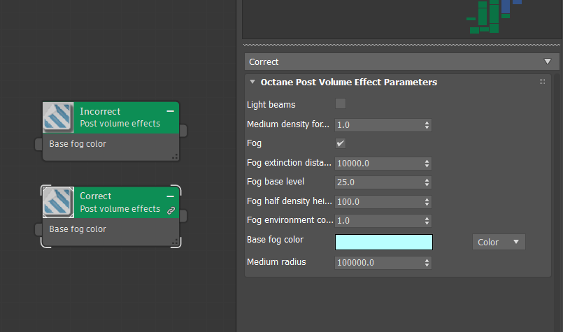

Also, I fixed my own issue, see screenshots attached. Effectively it was due to certain values, and the fog was too close, with new settings I see no issues around objects closer to the camera but still get the distant fog look I want.
So this prob only works well when it's far away, if you need close-up dense fog then use a scattering medium on the environment and use the emission technique for no noise.
No post-processing
No post-processing
Post-processing turned on with new changes
updated settings
updated settings
