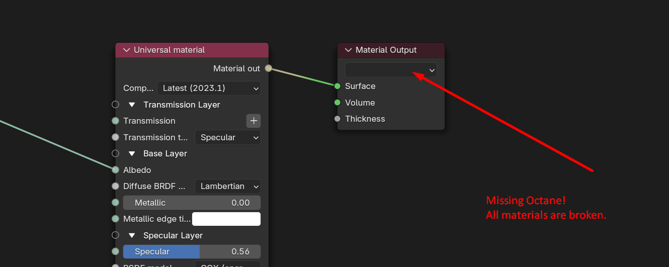

I just updated from the Non-addon version of 2023.1.3 v28.16 - to 28.17 (stable) - the latest 2023 available as of last week.
All the textures are broken from files I created in 28.16 - I found that all the shaders which end with the material output node, suddenly are missing 'Octane' in the dropdown menu - ergo, the shaders just come out as white diffuse.
(see screenshot).
If you click on this dropdown, Octane isn't even in the list, despite this being the Octane specific build, and the add-on is activated within, etc. Octane IS the active rendering engine as well. So just odd that it's not appearing in this list.

The "Octane" option doesn't exist anymore.
Materials should load fine by the way, with the option set to "All".
We fixed this some time ago, by the way.
Can you please send me a very simple scene showing the issue?
