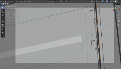

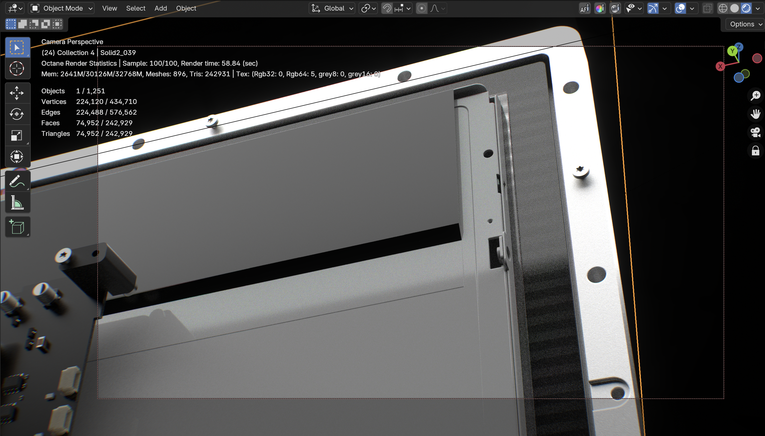

Any idea where this Zoom level difference comes from.
The two screenshot are just toogled between Solid View and Render View. NO Zoom level was adjusted.
Also trying to select objects in render view selects the objects in the Solid View Zoom level.

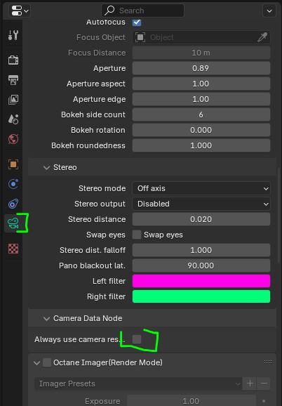

If you have "Always Use Camera Resolution" on, please turn it off for now.
If that deosn't solve the issue, please send me the scene so I can take a look. You can replace your meshes with a simple box.
Thanks!
interelectronix
Posts: 109
Joined: Fri Sep 22, 2023 9:25 am
Please give me a hint where to find "Always Use Camera Resolution"
linograndiotoy
Posts: 1503
Sure!

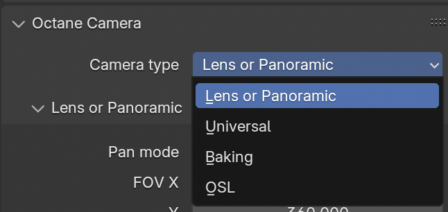

I also don´t see the Thin Lense in the dropdown. Am I missing something there ?
Andreas_Resch
Posts: 323
Joined: Sat Jul 28, 2018 6:29 am
No worries. Probably sticking with "Lens or Panoramic" should be fine. I'm not an expert on different camera types. I just used the one that worked. Not sure about the Thin Lens issue. Might be one of the addon bugs. I'm not up-to-date about Octane any more.
