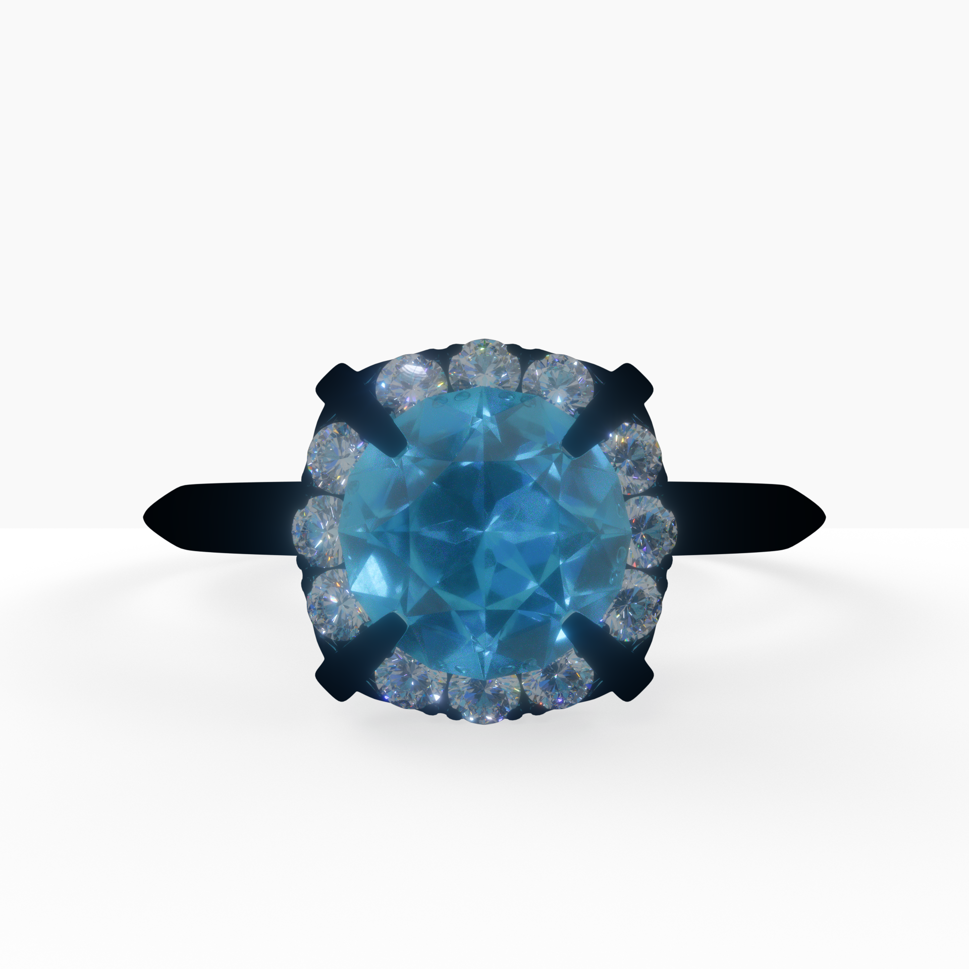

hmm i dont even understand whats happening, its like random "things" not working - like is not refreshing between files in queue, something stays in memory ?
this time looks like mask is not working ? example error image:
pierscionek-zareczynowy-my-beauty_zolte-zloto_akwamaryn_0-62ct_diament_2_Out1_0000.png
and 3 renders before are fine, just black parts are yellow gold, and stone material switched.
it's enough to stop render queue, checkbox check that broken render again, voila - it's fixed
can i somehow force 'reload/refresh' octane on every render ?
i'am at the point of writing script to restart whole c4d and see if thats working, but it's so much work :<
Posts: 16068
Location: Türkiye
Can't be sure without seeing the script and scene. But there can be a lack on update of materials.
Could you share it with me?
