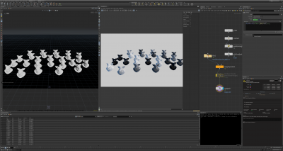

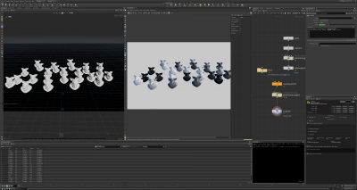

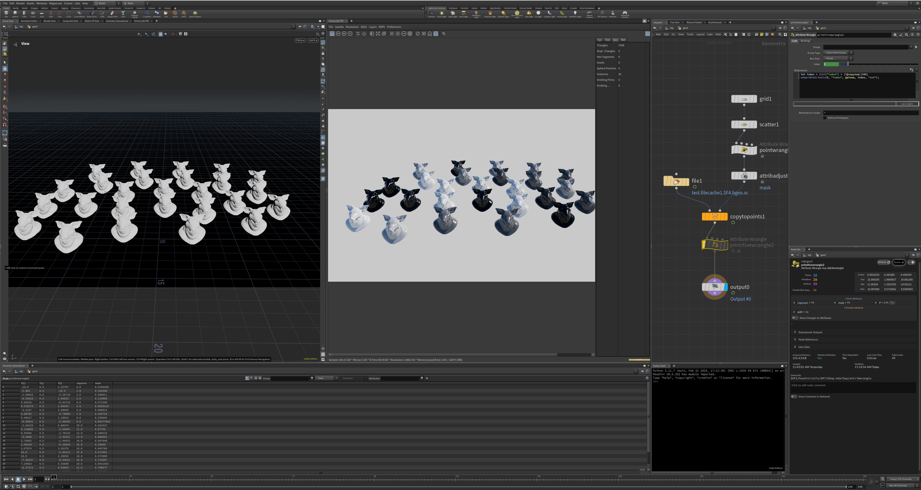

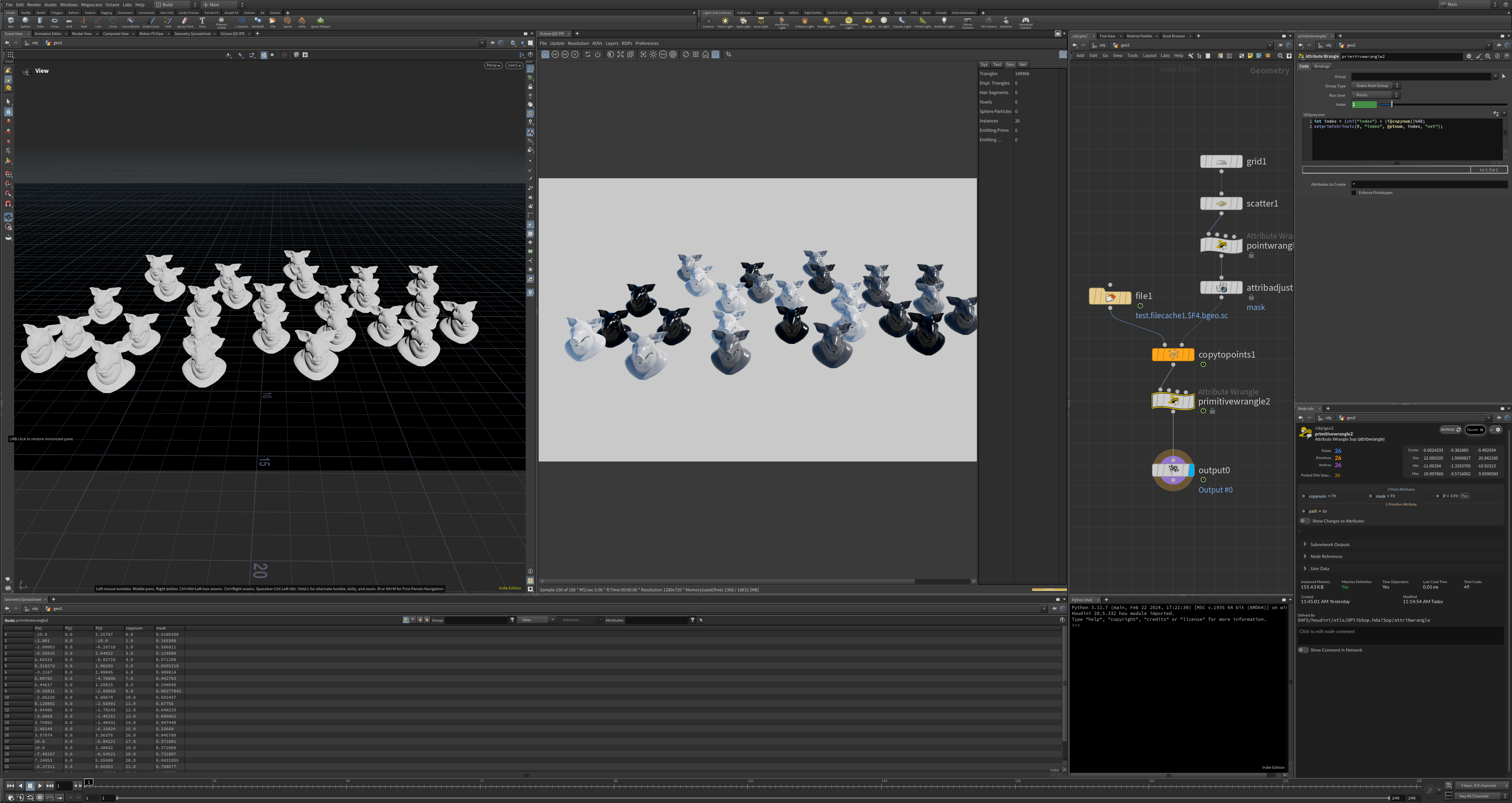

Ok. I can't seem to get it to work. It's still unpacking the instances in render time. Triangle count is not the same as you can see.
Maybe i'm doing something wrong or i just don't understand what it's supposed to do.
Not using intrinsic index attribute
Using intrinsic attribute to offset animation
That looks right to me, if you open that scene in the previous builds you will see the test geo animate all at the same time.
Rendering one item of that test geo will yield about the same VRAM usage as what you have for all instances.

ricky_otoy wrote:
Tested it in the previous version and it is as you said.
This is such a game changing feature. Thanks
