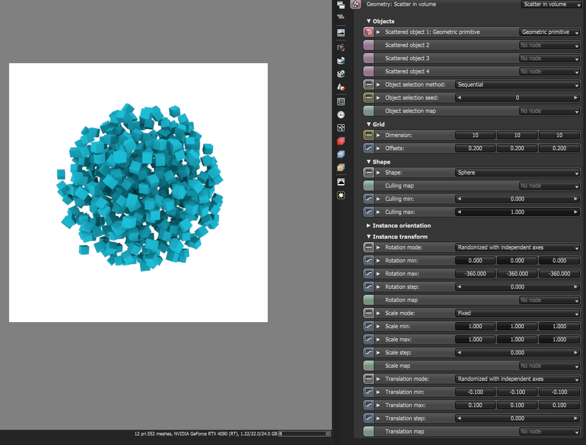

p3taotoy
Posts: 227
Joined: Sat Nov 24, 2018 1:06 am
Location: Washinghton, USA and Waikanae, New Zealand
many thanks
This is great
There seems to be a grid order to the scatter... I have tried translation offset min and max and that helped a bit but it does translate them out of the range a bit.
Is there a ratio of or formula in the Dimension and Offsets that somehow gets rid of that grid structure
