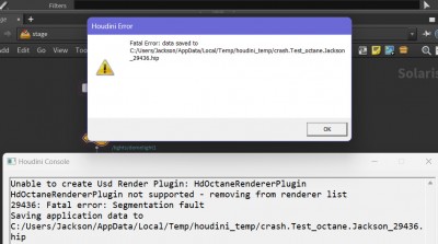

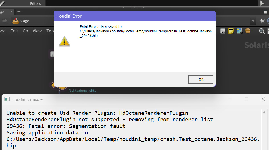

Location: Ukraine, Kyiv
Good day, tell me please, what could be the reason for such an error?
Win 11 x64 | Amd threadripper 1950x | 128gb | Rtx 3090ti

BK
Posts: 1567
akvahouse wrote:Good day, tell me please, what could be the reason for such an error?
Hi akvahouse,
Thank you for the post.
Would you please let us know the Houdini version and OctaneSolaris version?
Does Houdini work when OctaneSolaris is disabled?
Could you please send a ticket via our support [email protected]?
cheers
Kind Regards
bk3d

akvahouse
Posts: 36
Joined: Wed Apr 02, 2014 5:29 pm
Hi akvahouse,
cheers
Houdini 20.5.278, Octane 2023.1.3.2|OctaneSolaris - RC13
Houdini works well only before I start using octane, and when I switch to solaris and choose Octane for viewport rendering it crashes. But the strange thing is that octane works in a normal context without any problems

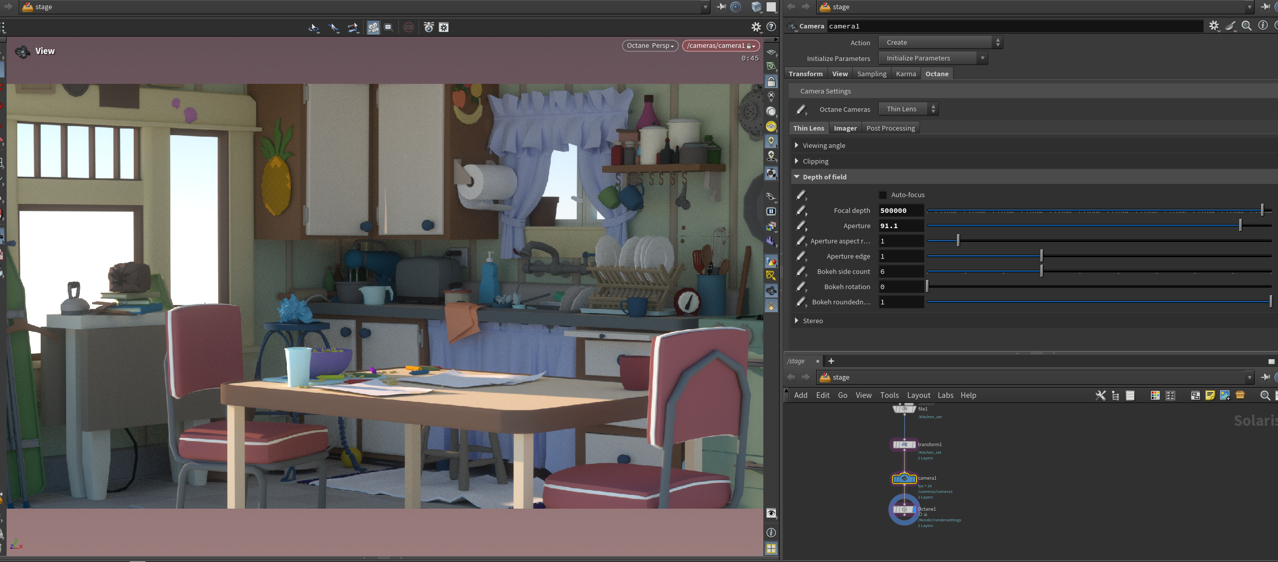

akvahouse
Posts: 36
Deapth of field doesn`t work in this build?
