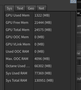

Running into a problem (bug?) that has cropped up sometime between 2023.1.0.2 and 2023.1.3. I used to be able to render 20 million point instances with relative ease, and now the system runs out of system memory and fails. I have built an example scene for those that are interested.

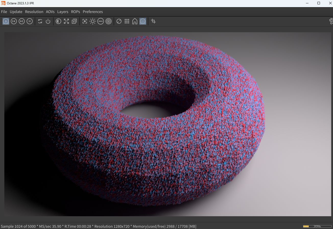

I can render 20M points rather quickly, its just when they are instances it fails.
IPR mem usage readout
