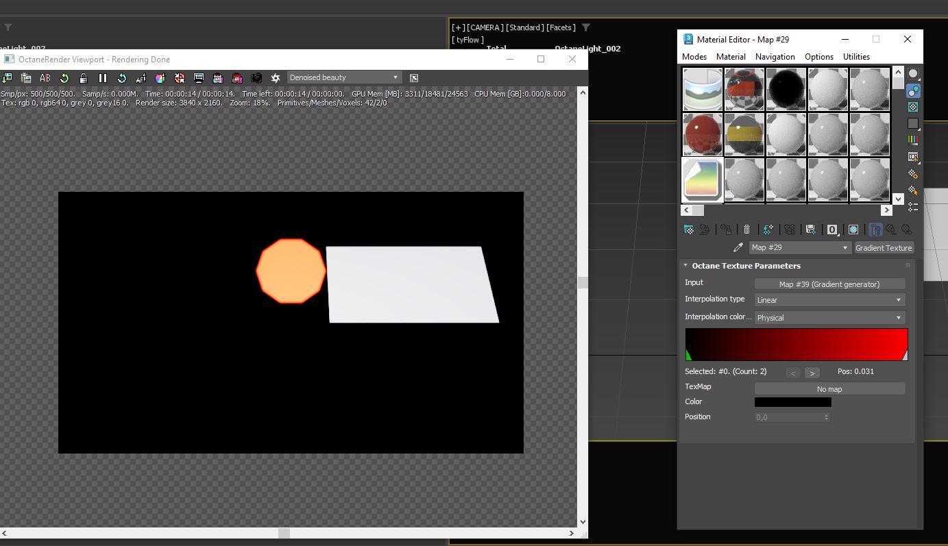

each time I see an octane tutorial with c4d, I wonder why Octane Gradient texture UI on max is so erratic !?!
Its really not a pleasure to use...
octane gradient texture
Same here, I don't understand how to use the gradient texture in Octane Light in Max... see there at 9min : https://www.youtube.com/watch?v=R8732-Hg3PI

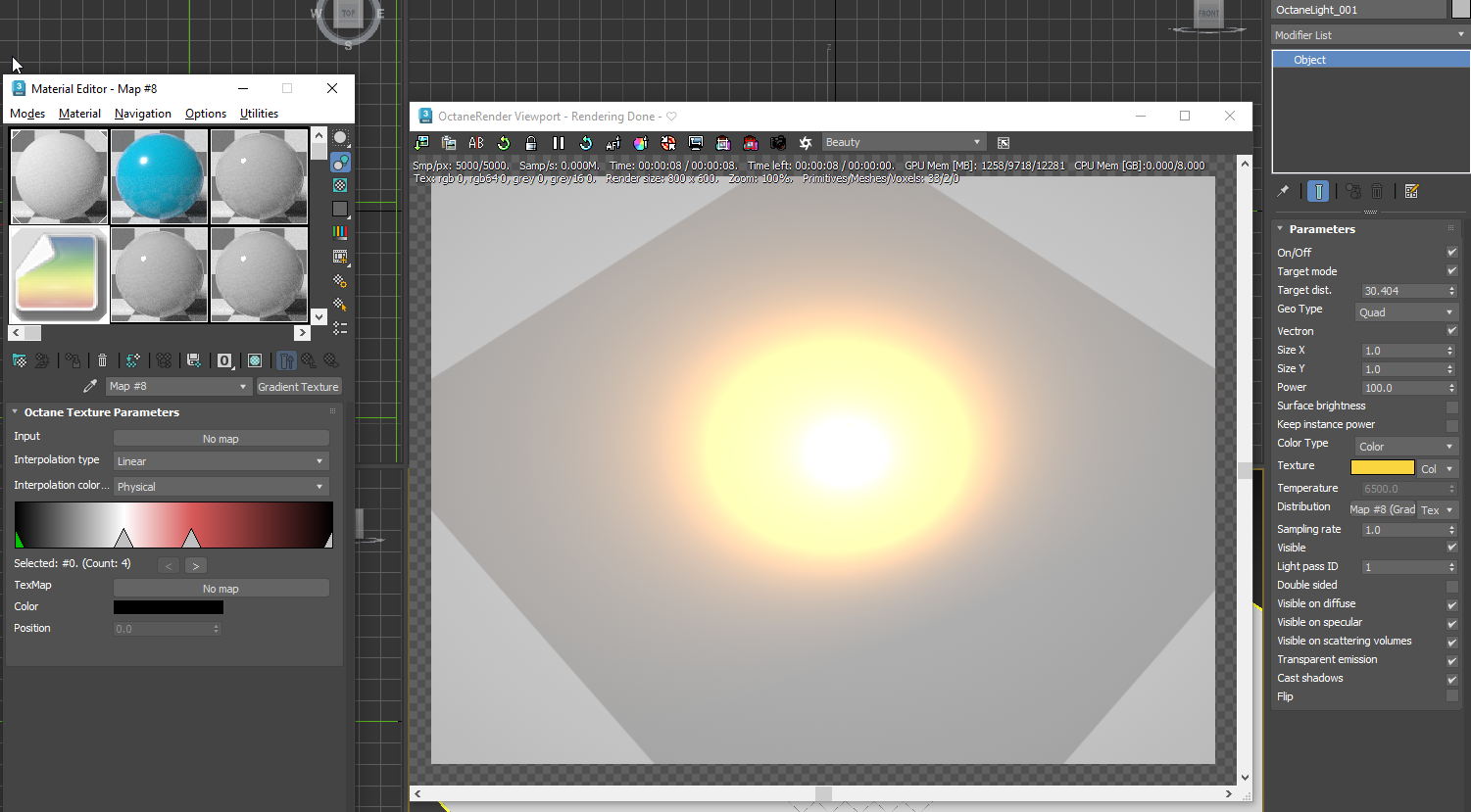

Hello NeonZorglub, is it possible to use the gradient texture inside a the distribution slot inside an OctaneLight ?
AMD 9950x3D / RTX 4090 / RTX 3090 / 192 Go DDR5 / Win 11
http://www.remy-kerbiquet.com
- neonZorglub
- Posts: 1082
- Joined: Sun Jul 31, 2016 10:08 pm

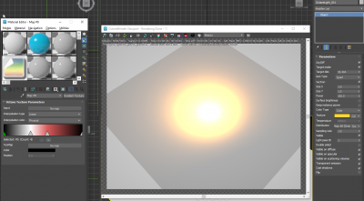

Hi remKa,remKa wrote:Hello NeonZorglub, is it possible to use the gradient texture inside a the distribution slot inside an OctaneLight ?
Yes, that seems to work. I see some effect changing when changing the gradient keys..
I'm not too sure what it is supposed to do, or what to expect.. but it worth experimenting with it..
Here are some samples.. Thanks

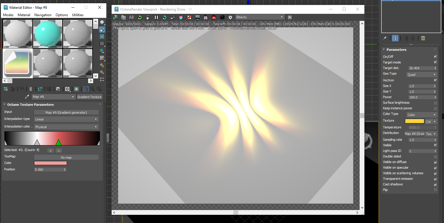

Thanks, but I don't get the difference between texture and distribution, I get different projection for a same gradient texture.
Would it be possible to get a preview of the gradient in the classic material editor (like in the Slate Editor) and in the max viewport (like in C4D as soon as we use a texture in the OctaneLight) ?
- neonZorglub
- Posts: 1082
Hi remKa,remKa wrote:Thanks, but I don't get the difference between texture and distribution, I get different projection for a same gradient texture.

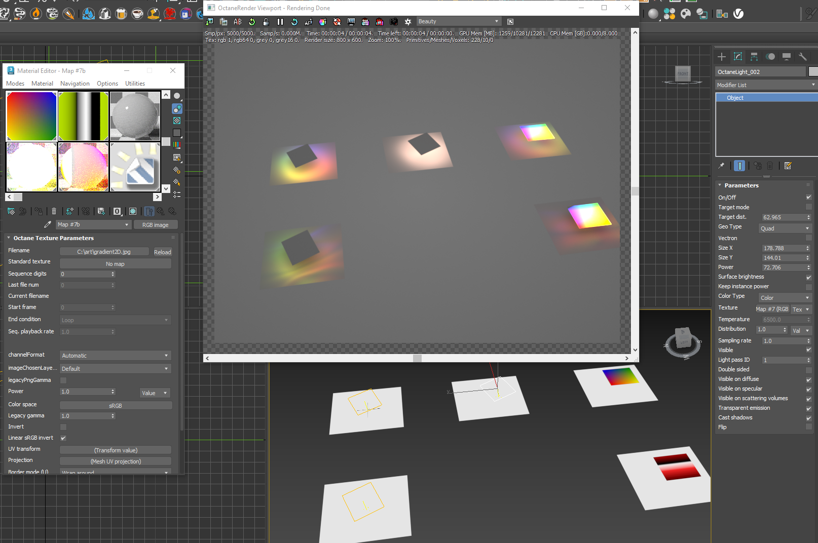

As far as I understand, the light texture is emitted roughly straight from the light surface (say, a Quad)..
That can be seen more easily when the light quad is close to the receiving object, like in the attached sample..
When the light is more far, the light rays gets blurred, and the texture is hardly recognizable.
I think the Distribution affect those rays direction. (see the 2 lights on the left of this sample)
I noted that when Vectron is not enabled (like for the light in the center), the texture seems not emitted correctly..
or not in the same way.. it might be a bug; I'll investigate more.
You could also create a light 'by hand', by assigning an emission texture / diffuse material to a plane (both lights on the right)
This could give you more control, and can also be used to display the emission or distribution in the 3dsMax viewport
For the preview of the Gradient texture in the material editor, sorry, that has just been broken in this version, with the addition of many thumbnails.
That will be fixed in the next release.
I'll also try to add a display mode with texture for lights in the 3dsMax viewport
Thanks,
