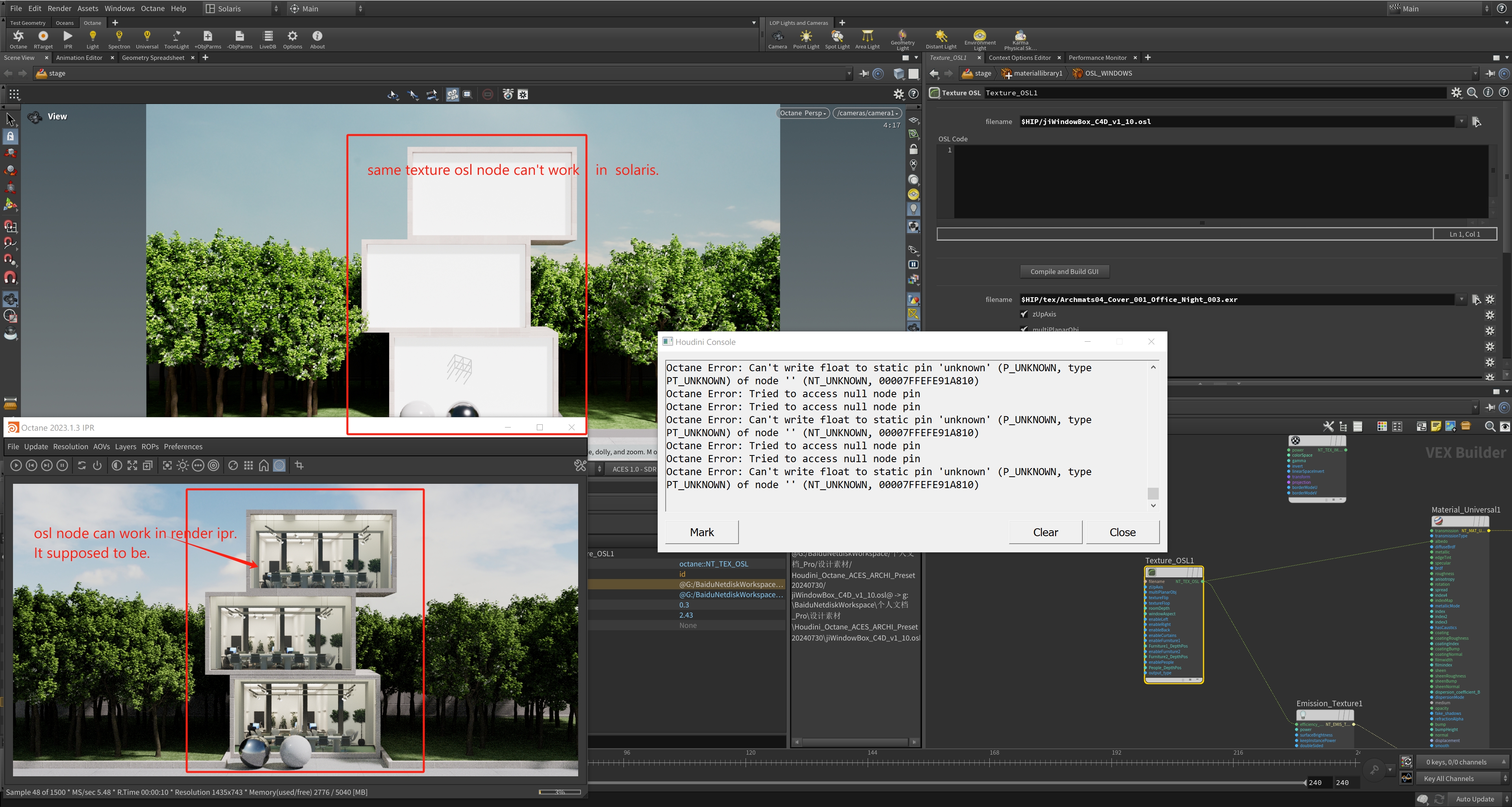

Osl Texture node can't work in solaris, houdini console shows error:
Code: Select all
Octane Error: Can't write float to static pin 'unknown' (P_UNKNOWN, type PT_UNKNOWN) of node '' (NT_UNKNOWN, 00007FFEFE91A810)
Octane Error: Tried to access null node pin
But osl node can work in houdini ipr, the material was built in mat.

Hi Azure_CN,
Thanks for the report.
Could you please try with the latest RC13? OSL seems to work on our side.
viewtopic.php?f=141&t=83920
