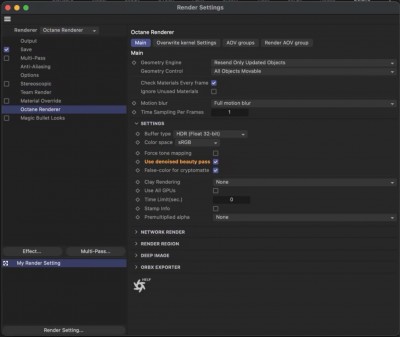

Hi all! Does anyone know how to enable denoiser on render in Octane? I turned on the denoiser when viewing in real time, but when I set it to render, the sequences come out unsmoothed, with noise...

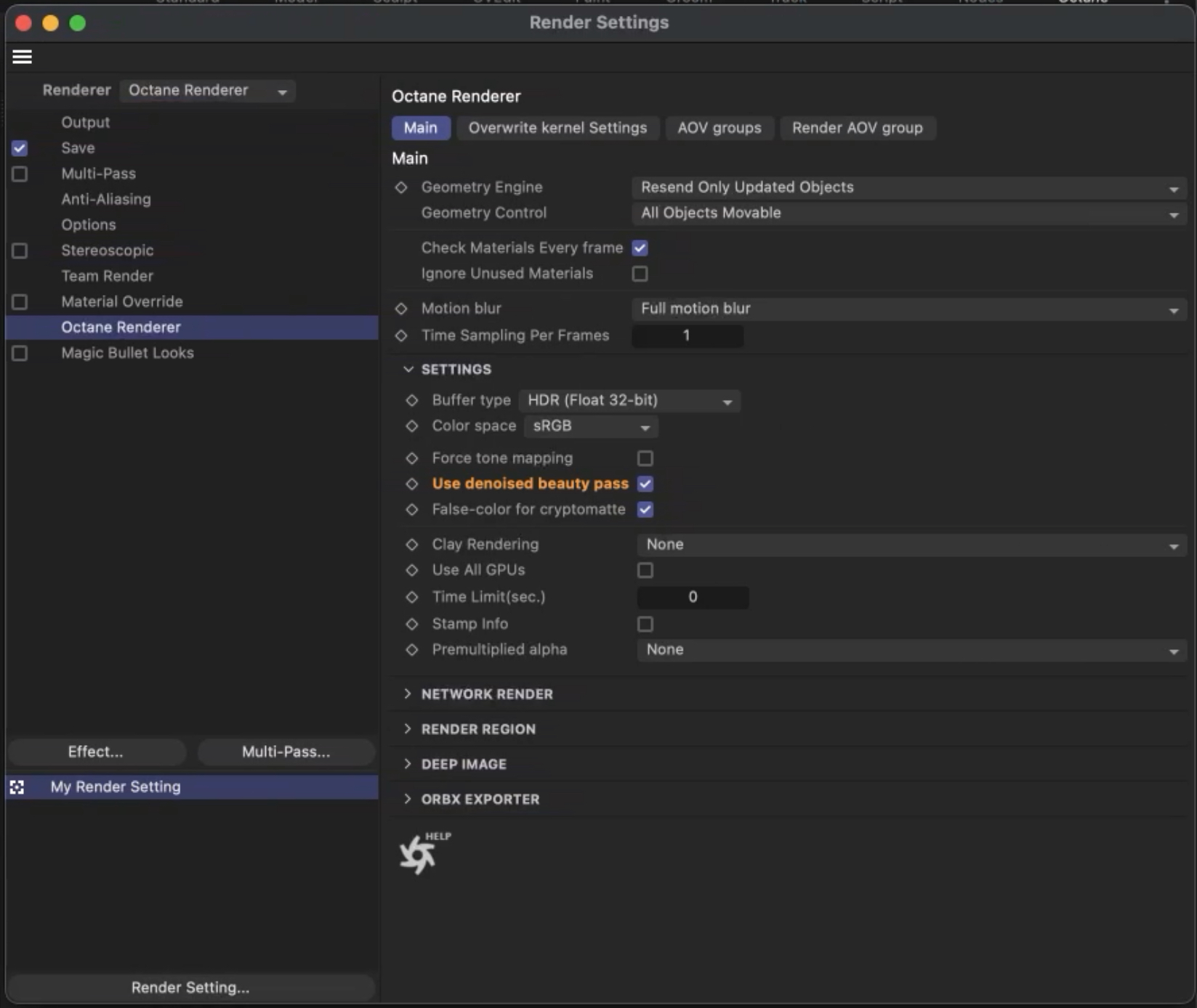

if you are using c4doctane, you need to go to Render Settings/OctaneRender/Main tab, and enable the "Use denoiused beauty pass" option:
