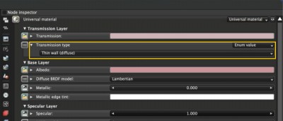

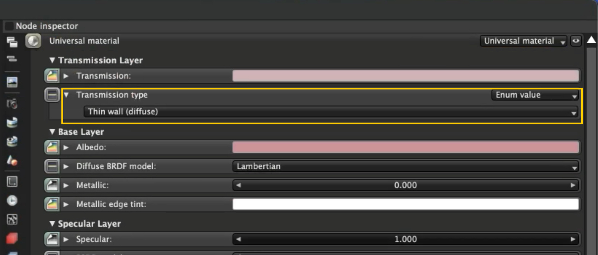

assuming that the petals have no thickness, you can use an Universal material, set a light color in Transmission similar to the Albedo/Diffuse color, and set the Transmission type to "Thin Wall Diffuse".
