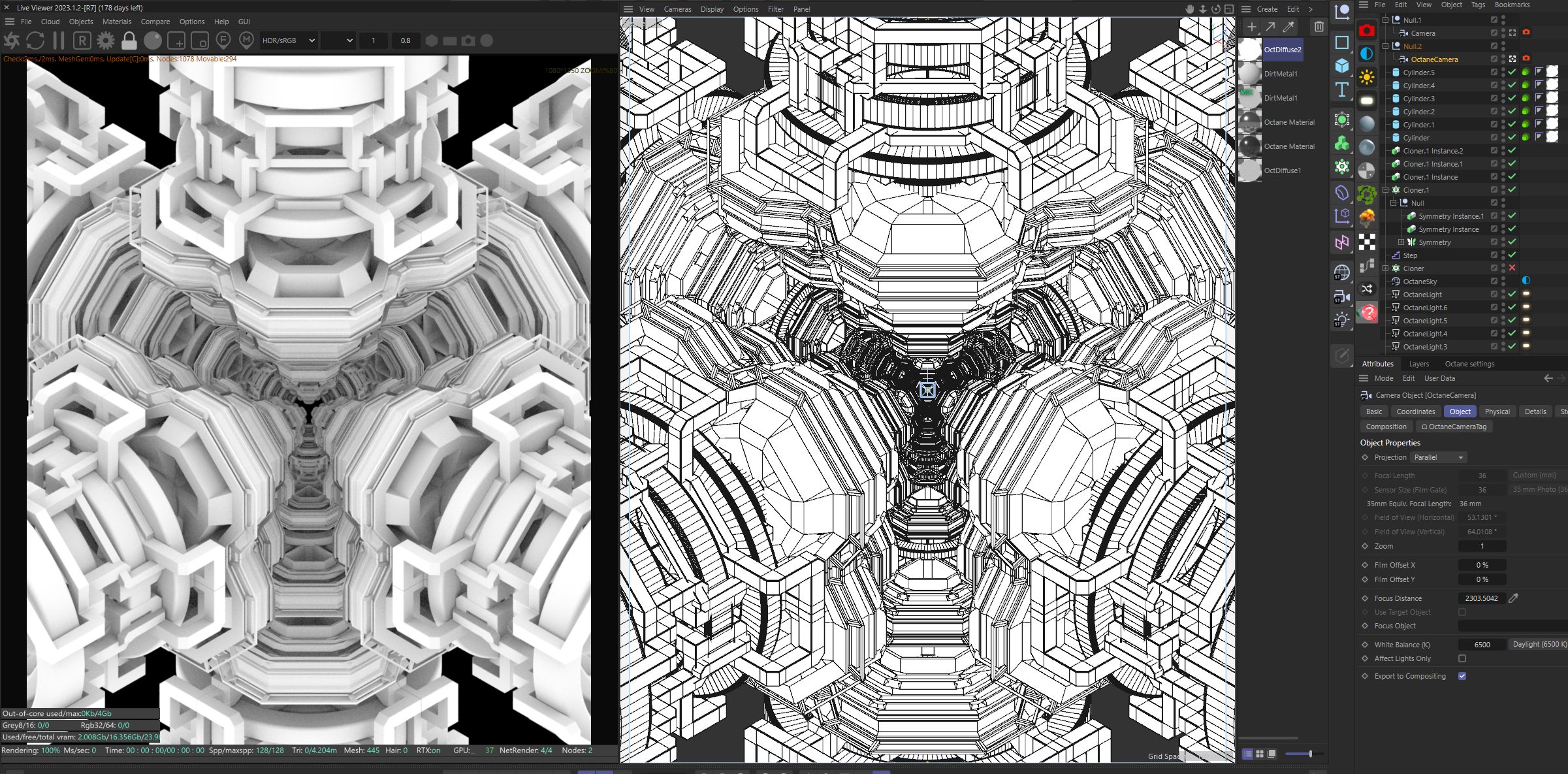

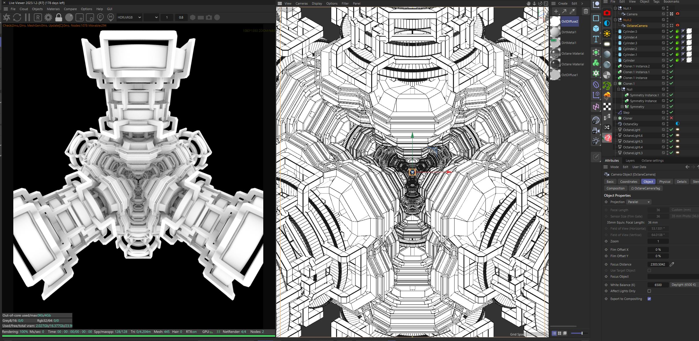

Having some issues with newer build of Octane for C4D. It no longer recognizes ther parallel camera. The first image is with a camera I saved from and older version that still worked. The second is adding a new camera in to the scene.

You need to activate "orthographic" option in the camera tag.
