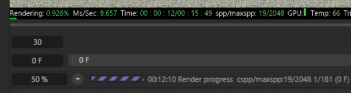

I am looking for help with a situation that suddenly started happening with Cinema 4D and Octane render. For no reason that I can figure out, the live viewer started freezing at 4%. Cinema 4D remains usable, I can manipulate the scene. move around etc but the live viewer of octane stays frozen. Weird thing is that when I move around the scene I still get text flashing on the top left corner of the octane viewer that says:Tri:204 Nodes: 28 (C) Updating... (see screenshot). If I try to restart the render then the whole program freezes and I have to crash C4D.
I am helpless. I have absolutely no idea what'S happening, one minute all was fine the next, literally impossible to work.
So far I have rebooted the graphics cards and reinstalled all drivers, I have then completely removed C4D and reinstalled. I've tried different version of Octane and C4D. I've tried switching to either one of the GPU same issue on both, no matter what.
I am about to literally format my PC completely and start over from a factory reset.
This problem happens even on empty scenes with only a place and a cube. It's not about running out of memory or anything like that.
I work with two GPU, a 2080ti and 3080. When I work, only the 3080 is checked as the GPU to be used by octane. I currently run C4D 2023.3.2.2 and Octane 2023.1.2_(R6)
I am about to run a diagnostic on the cards to see if the problem might be coming from there.
Is anyone capable of helping me of giving me any clue about what may be happening? Will a factory reset solve anything at all?
Thanks so much for your help. I am desperate as I need to be working on projects but am absolutely stuck!
