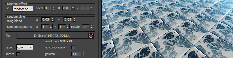

Similar to fstorm renderer, when selecting triplanar projection, you can use random tiling and random offset functionalities, which are very suitable for product rendering.

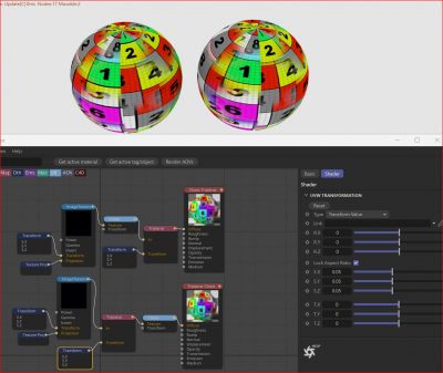

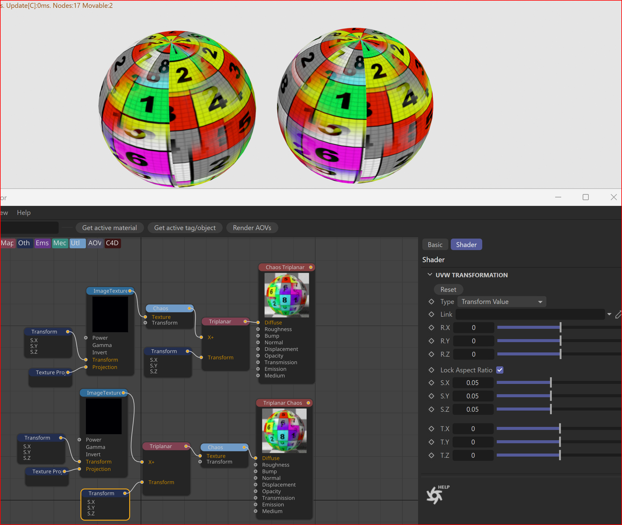

I think the Chaos node and the Triplanar node work in different, incompatible ways. The Chaos node specifically works in the UV space of the surface, while the Triplanar node specifically bypasses the UV space of the surface.
I would have guessed that the Triplanar node would override the Chaos node since it is "down stream," but there must be a different order of operations enforced under the hood that says the Chaos node wins.
You can reverse the order from
Chaos>Triplanar
to
Triplanar>Chaos
and adjust the Image Transform to make it work, but the Chaos node still wins.
