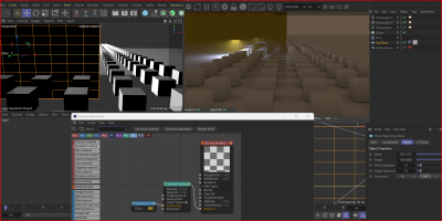

This is a good use case for the 2D Plane fog trick. Make a plane that defines the start of your fog by applying a Specular material to it which has a IOR of 1, a Transmission of 1, Reflection of 0, and a Scattering Medium. Essentially it's an invisible plane with only the Scattering Medium altering what is visible behind it.
While the shader is applied to a 2D plane, the fog effect is calculated 3D, and interacts properly with light sources. It's fast, easy to control, and simple to set up.
2D Fog Plane
2D Fog Plane

I came across this trick 5 years ago while working on my client's project.
I'm hoping for a solution that doesn't involve tricks or workarounds.
