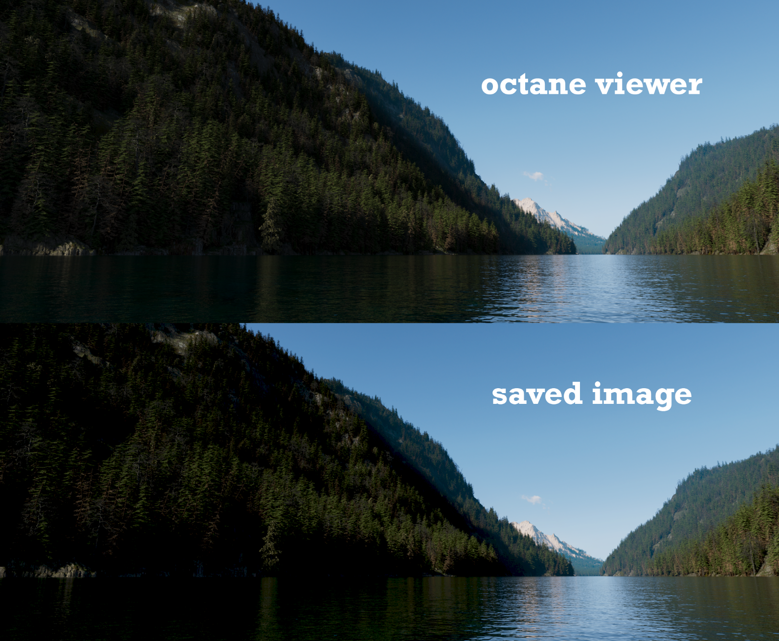

Hey,
I have been using Octane for some time now, but i just noticed this when I save my image.
The saved image is darker in the shadows than the octane render viewport.
Can anyone help me so that my saved images look 100% like the octane viewport.
Thanks!
Lars

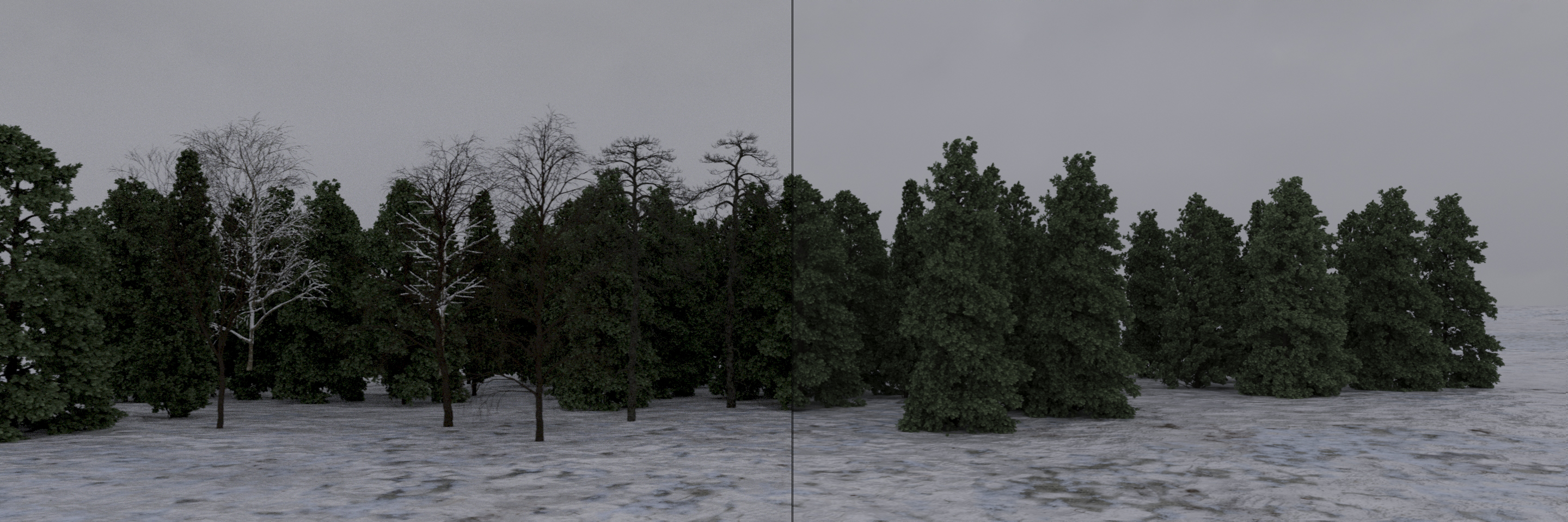

Hey, here is the download link for a scene that has that issue.
https://we.tl/t-tEa5piWmeH
Its active for 7 days.
I included an image, where on the left is the saved image, and on the right is the octane viewport that i just snipped in using the snipping tool.
Any help would be very welcome, because i cant use the saved images for anything, and therefor i might need to look at another render option.
Lars

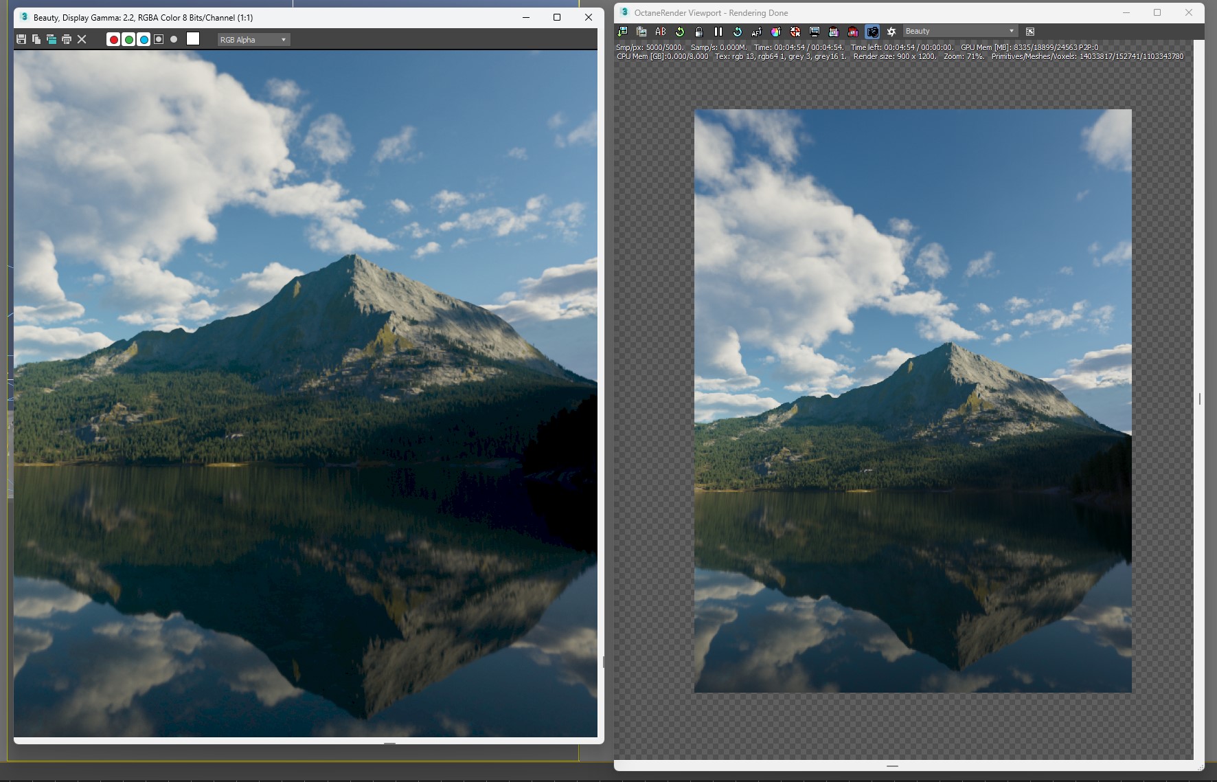

When my octane render is done, i prompt it to max´s framebuffer, and the result is really bad.
Is this a gamma thing?

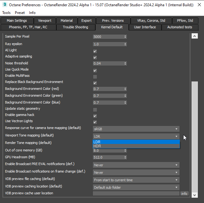

Figured it out, or this guy did :)
https://youtu.be/vnNR7xrij3c?si=-qH2F5_v08e7lauU
switch from LDR to HDR... :)

Hi larsgehrt,
Glad to see that this fixes you issue. I was thinking of a gamma setting, but if this works, that's nice to know.
Note that you can change the default viewport setting to HDR in Octane Preferences / Kernel default.
(for New scenes, and loading non octane scenes)
larsgehrt
Posts: 44
Joined: Wed Jan 18, 2023 7:21 am
Location: Denmark
Thanks man! Yea i checked that out, so now I have it on default :)
