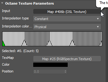

I wanted to make some variations of my cars color with Random color texture and a gradient texture set to constant, but when the cars move, their color change during animation.... ( I use tyflow to animate the cars )

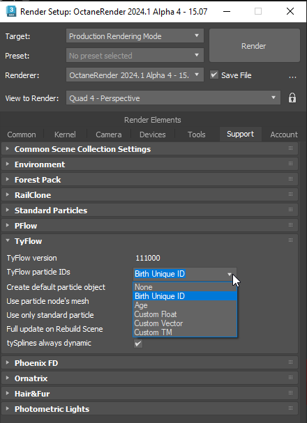

TyFlow particles can have a Birth ID, that won't change during the animation.
We can use those as Octane Instance ID, from the Render setup / Support / TyFlow :
Set TyFlow particle IDs as Birth Unique ID.

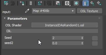

Then, instead of the Random color texture, you need to use an OSL texture that will use the Octane Instance ID as a random generator
Here is your updated sample, with the osl file InstanceIDAsRandom01.osl

I hope that helps, and will work with your scene.

We can change Tyflow particle IDs option for all tyflows of the scene ?
Could it be possible to make this option per tyflow object basis ?
So we can drive particle Ids differently by tyflow objects.

Ho right, I should have mentioned this : this can be set per tyflow object:
Just add a Octane Geometry Properties modifier, and there are the same options in the TyFlow rollup..
This will override the global settings from Render settings / Support / tyFlow ..
